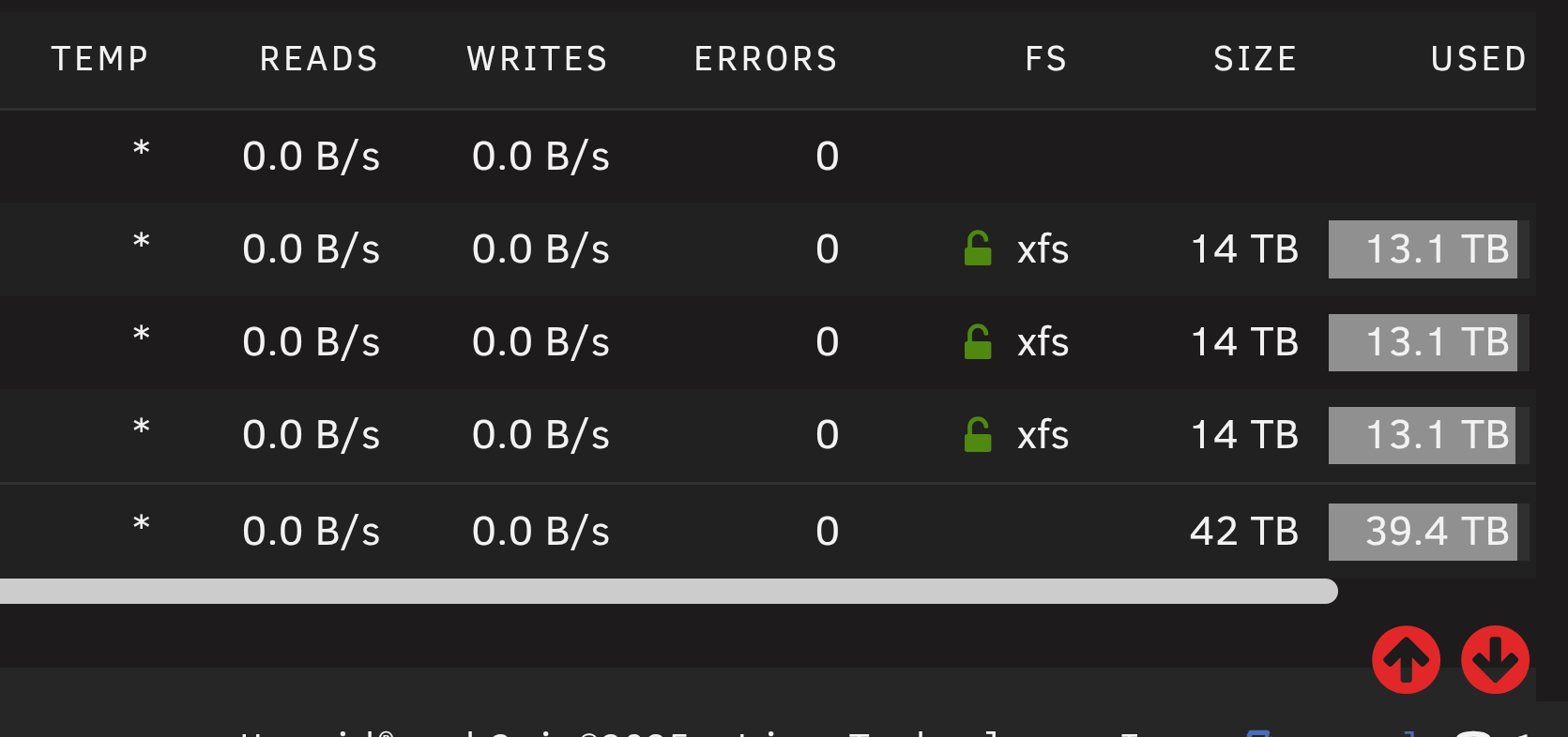

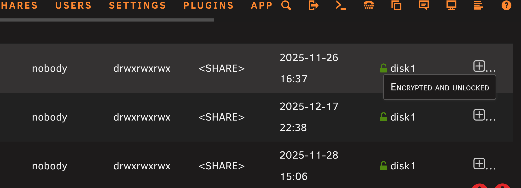

  1. Thanks for the insight. Much appreciated. Screenshots below, it actually does not say "xfs-encrypted" in the FS column but shows a green lock next to it. In the file manager it seems to be more consistent as it does show a green lock and also hover text confirming the encryption while on UD mounted disks the file manager seems to be not recognizing the encryption (sadly). So, to be protected against theft of the server/NAS (including the USB drive) it is more secure to use the array password (compared to UD disk password)?

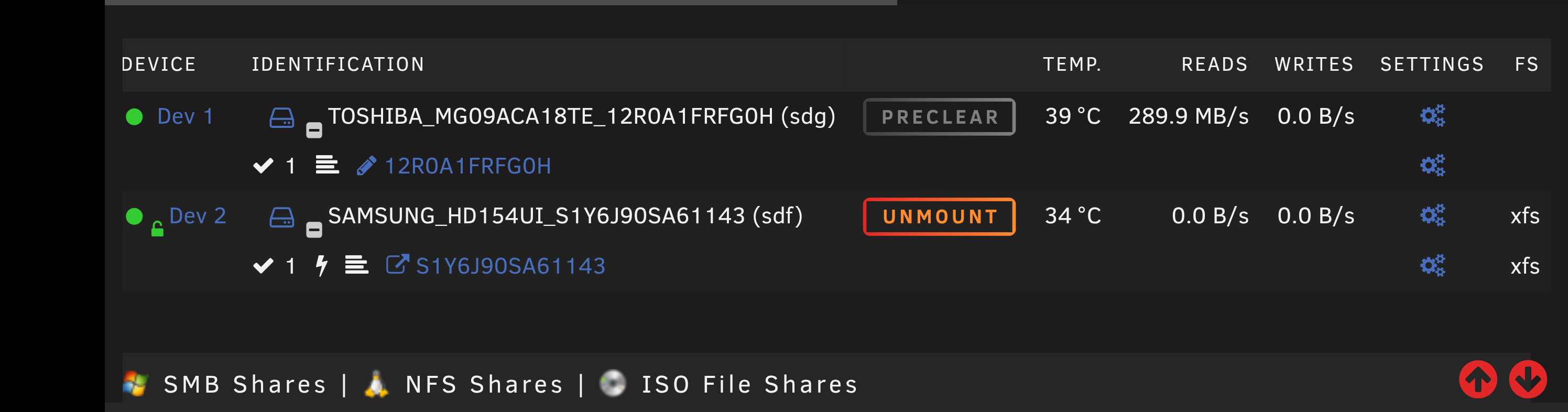

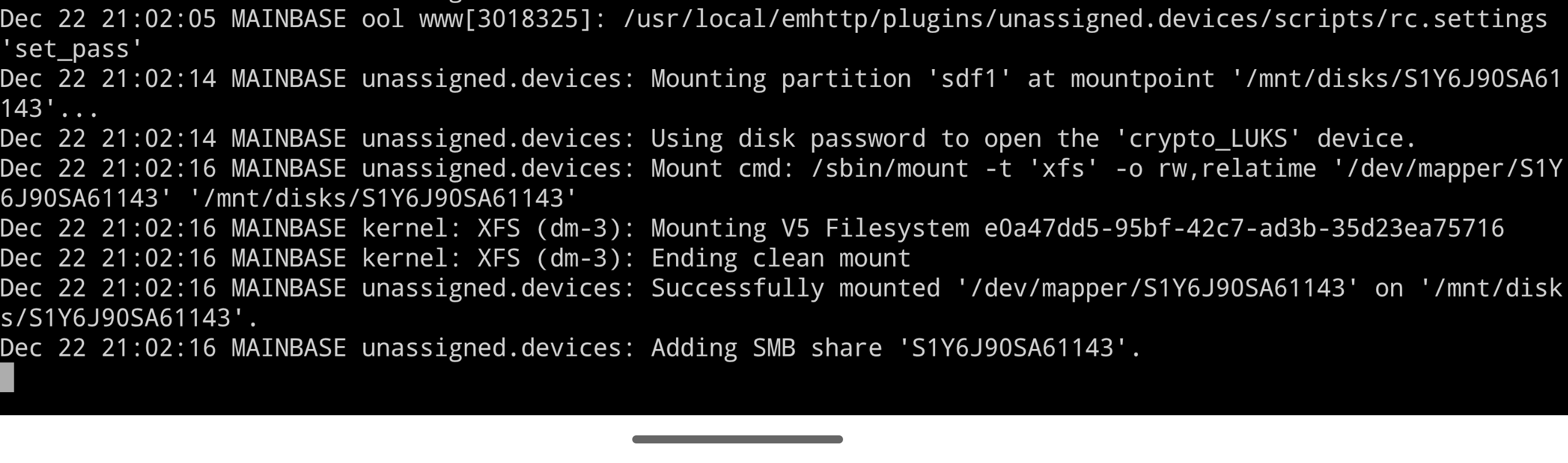

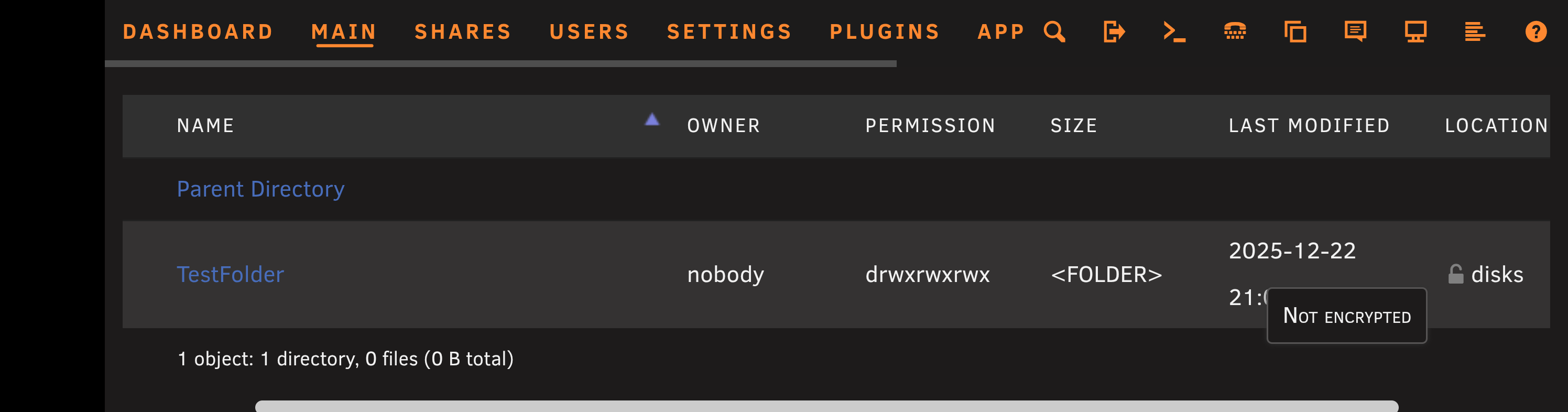

  3. I managed to create the supposedly encrypted partition. I attached screenshots of the log showing encrypted mount, and then what is showing in the GUI, including file manager view. What do you think? Something is wrong here, there is a green lock symbol on the left side in UD, but not on the right side in FS column (usually showing xfs-encrypted). Also in file manager in location column also showing no encryption.

  5. Yes, but the ntfs action was just to try VeraCrypt some time later. I will post a clean sequence where I just go from creating xfs-encrypted to mount and also post screenshots. It's really strange because the logs say it was created encrypted but after mount nothing in the GUI is indicating encryption (e.g. Disk column says "Not encrypted" and FS column says just "xfs"). P.S. Maybe it's just a visual bug? I am new to Linux so I have currently no easy way to verify the existing encryption besides what GUI and basic logs are showing me.
  6. Already did, sorry. I attached it to the original post. Thanks :)
  7. I have an issue after formatting an external disk (USB enclosure) as xfs encrypted. Everything works (it shows FS "luks" after formatting) but then after mounting it no longer seems to be encrypted. In UD it does not contain the encryption symbol (on the left), and also when I open the disk in file manager there is no indication in the "source" column (Disk, not encrypted). In UD FS column after mounting changes to just plain xfs (without encryption). What could be wrong?
