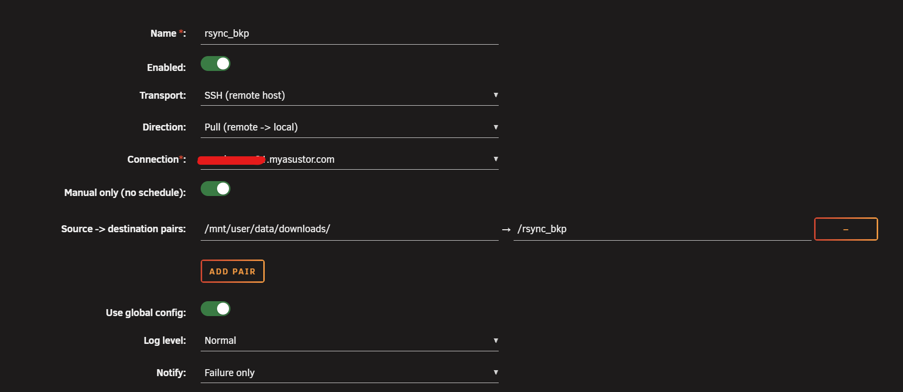

  1. Hi @fajkovic.sasa I did a real run and I can confirm that it worked indeed! 🥳 Going to ask a small tweak, if it's possible: is there any way to have a less verbose log? would be amazing to have a new line something like every 5% increase or every 30/60 sec... but I don't know if depends on your or on rsync code, thanks!

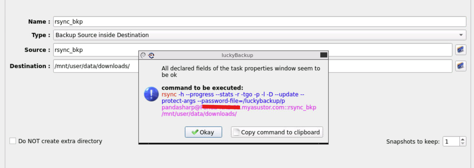

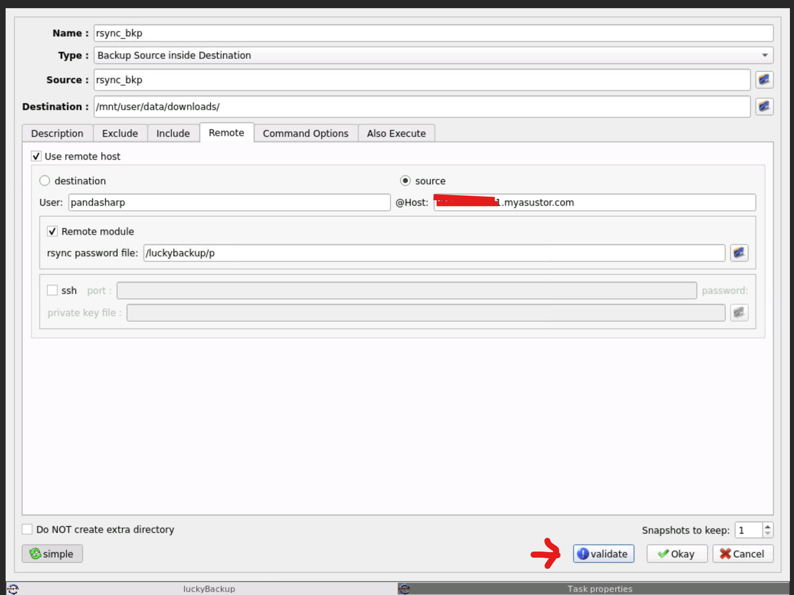

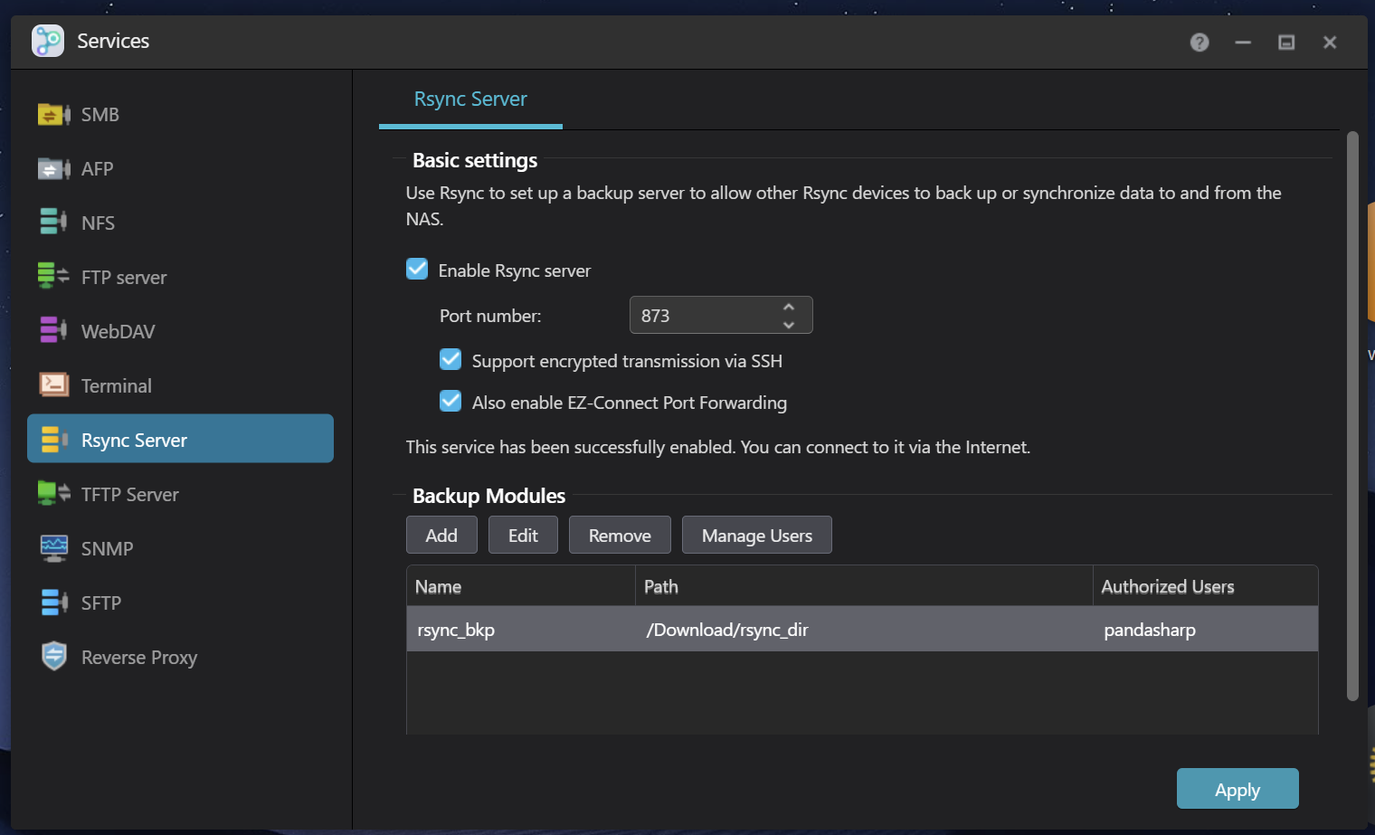

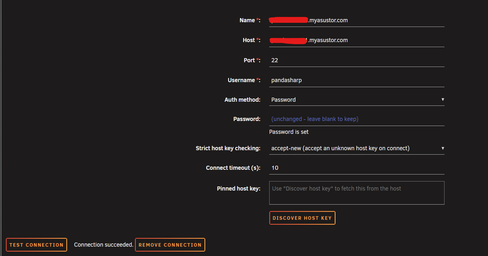

  5. Hi @fajkovic.sasa Thanks a lot for your quick and detailed reply, I'm a bit swamped for the next several days, but I'll give it a shot as soon I'll have a change ... and I forgot to mention that I tried also /Download/rsync_dir instead of /rsync_bkp but still no luck, it must have been because of the mix up of protocols, I'll dig and debug everything from command line with a dry run, thanks!
