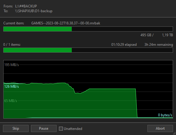

  7. Strange discovery, when backing up files with Macrium from W10 machine to Unraid, noticed that tasks fail on certain files/folders. And those even fail if I move files/rename long path to smaller one/rename end ZIPs to simple numbers. More confusion adds fact that 1000+ zips - FAILS, and 1000 is fine. Like literally those 100 are bad apples. (Okay 1000+1000 also fails) Even if I ZIP all those 1100 into single one, copying this to NAS fails as well. Zipped 1000 into one piece also goes smooth. Whaaaa. Could this be an issue because NAS runs with 4GB of RAM? While dashboard reports its barely utilized, otherwise I cannot come with anything why this strange scenarios may happens.
  8. From few more tests, it seems Macrium Reflect doesn't handle those long file transfers straight to network disk. While VEEAM Agent handles this better. Also have seen posts where Macrium users mentioned that they do backups usually firstly disk to disk, and later move those images with more robust and reliable copy methods.

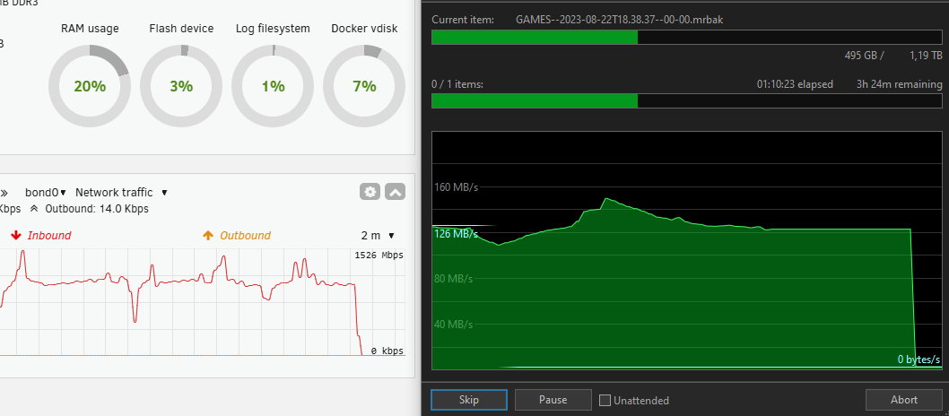

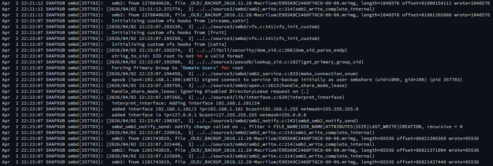

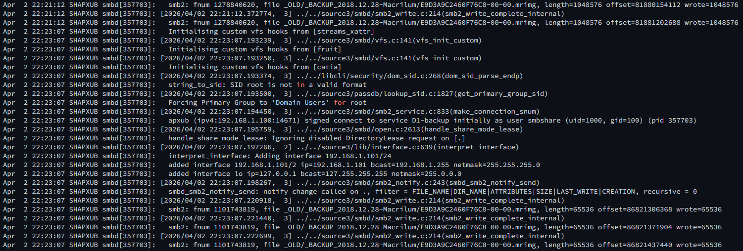

  10. I had SAMBA logs enabled previously, and monitored whole transfer. And those adding interface messages lead me to think, could this be interface bonding/bridging issue? I guess if interface were dropping, this would be obvious in logs.
  11. Here are logs just after event. I start to see pattern, with 1 hour and 10 minutes. shapxub-diagnostics-20260403-1334.zip
  12. I'm suspecting that my NIC in NAS goes down and re-appears. Like there are ton of write event, and whoops network interface appeared. New diagnostics added. After event occurred. diagnostics-20260402-2229.zip
