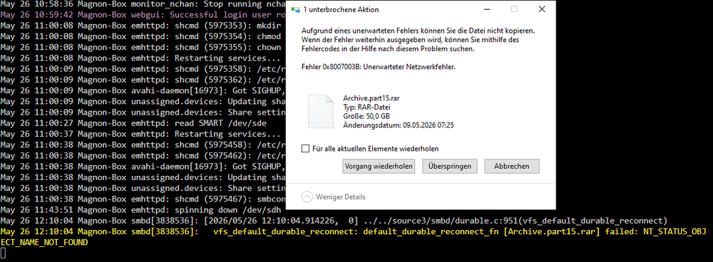

Funny, i did run into this issue as well. With a encrypted fully compressed multi part (50gb chunks) rar archive
May 24 14:15:44 Magnon-Box smbd[1894656]: [2026/05/24 14:15:44.407591, 0] ../../source3/smbd/durable.c:951(vfs_default_durable_reconnect) May 24 14:15:44 Magnon-Box smbd[1894656]: vfs_default_durable_reconnect: default_durable_reconnect_fn [Archive/rar/Archive.part16.rar] failed: NT_STATUS_OBJECT_NAME_NOT_FOUND
The file was absolutely present in the time of that error.
Now, i think the original file in that particular archive, also gave me that error. although that was a massive 300gb single zip. Ive no clue what upsets it, i just loaded the files onto a usb external drive and dumped it that way unto unraid. Hella annoying tho.
On my end, if these bad apple file are inside another archive or other file this also breaks transfers.

@JorgeB Whats your environment, Windows 11 ?
The windows machine had in this case 2 Nics, didnt change anything
May 6 10:26:25 Magnon-Box smbd[2168712]: [2026/05/06 10:26:25.696302, 0] ../../source3/smbd/smb2_read.c:265(smb2_sendfile_send_data)
May 6 10:26:25 Magnon-Box smbd[2168712]: smb2_sendfile_send_data: sendfile failed for file Archive/Archive.part20.rar (Connection reset by peer) for client PID=2168712,CLIENT=REDACTED,channel=2,remote=ipv6:fd0>
May 6 10:26:25 Magnon-Box smbd[965126]: [2026/05/06 10:26:25.804240, 0] ../../source3/smbd/durable.c:951(vfs_default_durable_reconnect)
May 6 10:26:25 Magnon-Box smbd[965126]: vfs_default_durable_reconnect: default_durable_reconnect_fn [Archive/Archive.part20.rar] failed: NT_STATUS_OBJECT_NAME_NOT_FOUND
May 6 23:59:26 Magnon-Box smbd[1542941]: [2026/05/06 23:59:26.039488, 0] ../../source3/smbd/smb2_read.c:265(smb2_sendfile_send_data)
May 6 23:59:26 Magnon-Box smbd[1542941]: smb2_sendfile_send_data: sendfile failed for file Archive/Archive.part20.rar (Connection reset by peer) for client PID=1542941,CLIENT=REDACTED,channel=2,remote=ipv6:fd0>
May 6 23:59:26 Magnon-Box smbd[144767]: [2026/05/06 23:59:26.101105, 0] ../../source3/smbd/durable.c:951(vfs_default_durable_reconnect)
May 6 23:59:26 Magnon-Box smbd[144767]: vfs_default_durable_reconnect: default_durable_reconnect_fn [Archive/Archive.part20.rar] failed: NT_STATUS_OBJECT_NAME_NOT_FOUND
This error came from another a whole different platform as the 2 above
Edit:
i did test around. It seems like the issue appears only when you write to the array and my best guess is extrem IO wait that screws it over. Now, why it happens to specific file types, thats the question
Edited by Mainfrezzer
