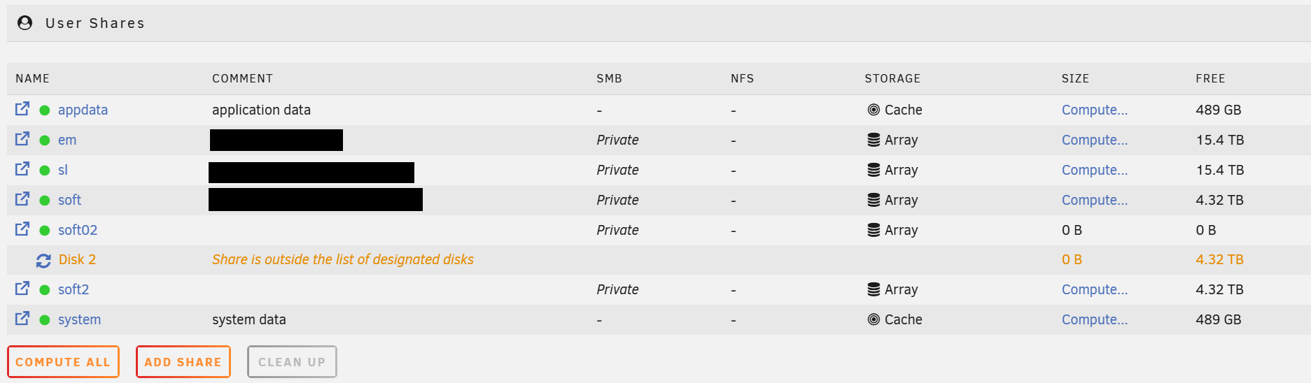

  1. I guess I didn't express myself correctly in my posts. I have no idea what Mover is (but will add it to the list of Unraid topics to read on) and I don't think I've mentioned it at any point. The share being set to a Cache disk was all Unraid's doing on its own. I never set it to Cache. I set it to Disk 3; Unraid automatically decided it would go on Disk 2. Then when I started messing with the Include/Exclude, it decided at one point to set it to Cache and at the same time stopped showing me the settings so I couldn't change it back to a regular disk until I deleted the cfg file. Hope this makes more sense as kind of a summary.

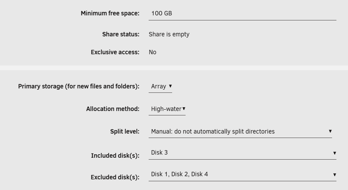

  2. Figured I'd provide an update as the issue is fixed and it could help someone else. I ended up submitting a support ticket and was assisted quickly, which was very much appreciated. Support suggested first that when only including 1 disk in a share, the Split Level should not be set to Manual, but rather left as default (kudos to itimpi for suggesting this before!). After some back and forth doing troubleshooting, it seems the problematic share's config file was apparently corrupted. Stopping the array, deleting the cfg file (under /boot/config/shares/) and restarting the array (array wouldn't start, so I ended up rebooting the machine) fixed the issue. I could then see all the share settings and modify them. The share's primary storage was listed as Cache; changed it back to Array and chose the corresponding disk in Included disk. The share now shows the correct free space and I can create/copy files normally. They couldn't say with certainty what caused all of this, but at least now I know not to use both Include/Exclude and to leave Split Level by default when including 1 disk. Back to moving data. Thank you everyone for your help!
  3. I apologize if I'm misunderstanding some basic concept. I didn't intend to set both include and exclude, but unraid decided to choose which disk a share should be on its own (despite me telling it to only include one specific disk), that's why I figured if I set both it would have no choice but to stick to the disk I want it to use. Again, I want to be the one to decide which data goes to which disk. Just to clarify: there are no files in this share (soft02). It is a new share I created. I told it to include only Disk 3 and unraid automatically switched to be Disk 2. Without adding files, I changed it to only include Disk 3 and exclude the rest (again, no files or folders were added to the share before or after this). After this change, it went to 0 bytes free (still with no data ever copied to it). After recreating it (deleting the share, then creating it again with same settings and name), it now shows it is set to use Cache. Again, this was unraid deliberately making it so, despite me specifying which disks I wanted to include and which to exclude. So I'd like to understand first: -why is Unraid not honoring my choice for include/exclude? (be it one or both) -why does it show the share as having 0 bytes free, despite there being plenty of space in all my disks? -why does the share now shows 'Cache' when I click on Compute, despite the Storage column indicating it's in the array (which cache is not part of)? -how can I force unraid to create the share(s) in the specific disk I tell it to?

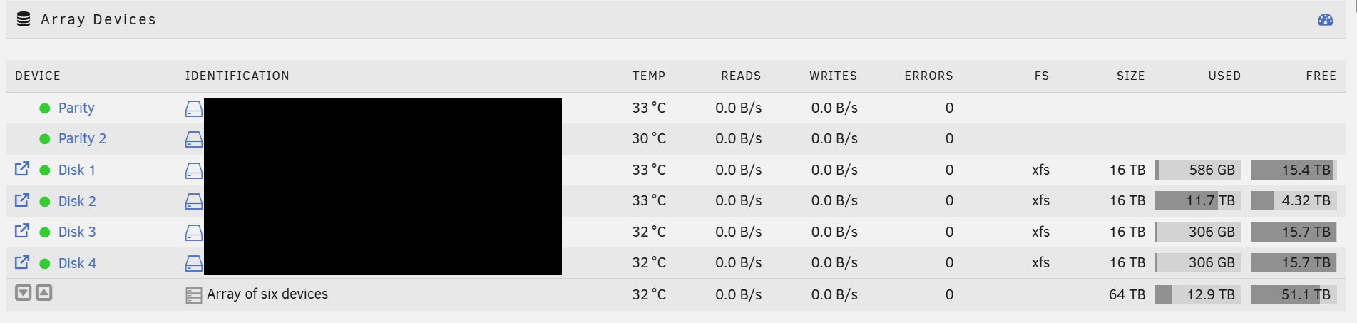

  4. Diagnostics attached. bits-diagnostics-20260512-1103.zip
