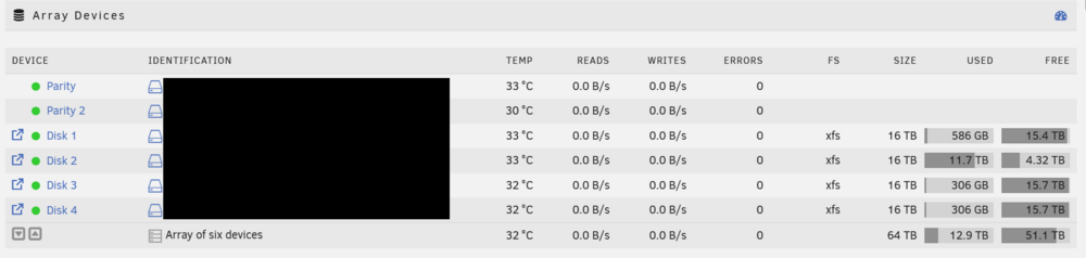

This worked fine and I could see the data going only to that disk in the Main tab of Unraid.
I then create a second share, same settings except this time I chose Disk 1 for Included disks.
Copied over some data and saw the data going only to that disk in the Main tab of Unraid.

Copied over some data and upon inspection I realized it had copied to Disk 2 instead.

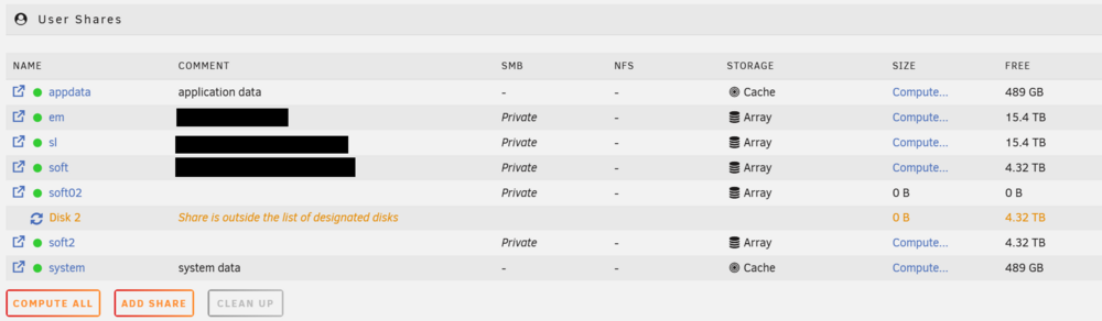

Now the share shows it has 0 bytes free (despite all my disks having lots of free space), and if I click Compute I get the message:
Disk 2 Share is outside the list of designated disks.
I tried copying over some files, or creating a folder, but it always says the disk is full.

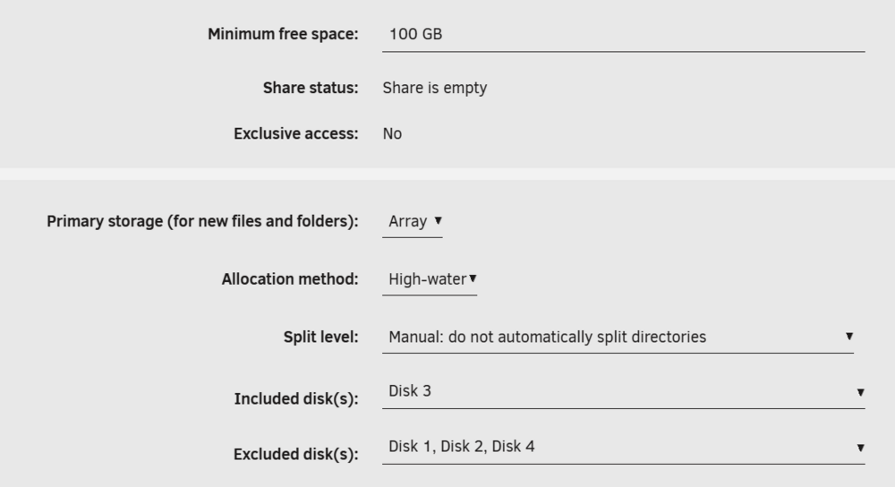

Include Disk 3 + Exclude All others
You should never set both Include and Exclude (maybe recent versions won't even let you).
Include means Only the listed disk(s), so all others are already excluded.
Exclude means Except for the listed disk(s), so all others are already included.
There is no good reason to think you should set both of these, and possible inconsistencies could result.

Just to clarify: there are no files in this share (soft02).
It is a new share I created. I told it to include only Disk 3 and unraid automatically switched to be Disk 2. Without adding files, I changed it to only include Disk 3 and exclude the rest (again, no files or folders were added to the share before or after this). After this change, it went to 0 bytes free (still with no data ever copied to it).
After recreating it (deleting the share, then creating it again with same settings and name), it now shows it is set to use Cache. Again, this was unraid deliberately making it so, despite me specifying which disks I wanted to include and which to exclude.
