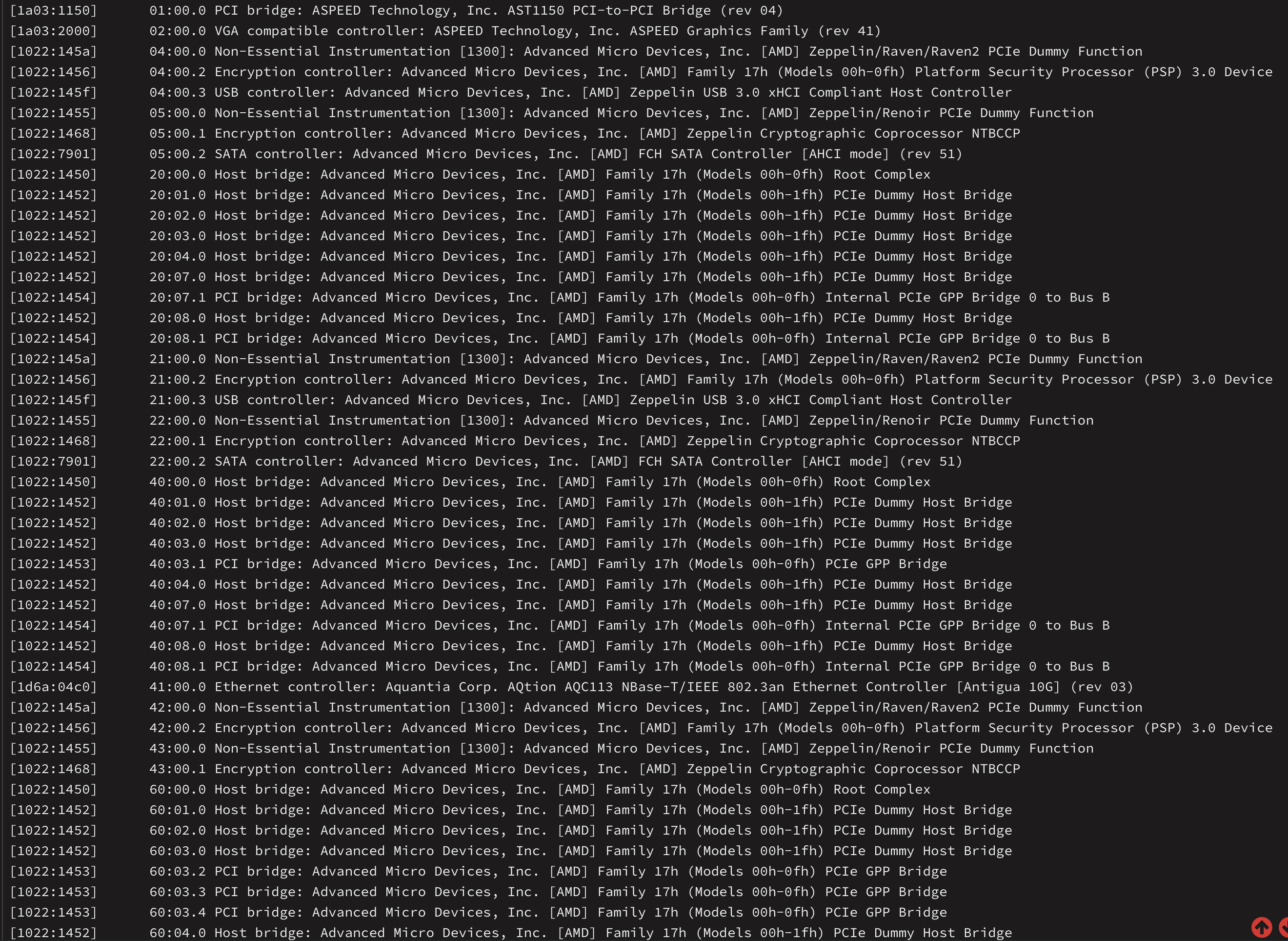

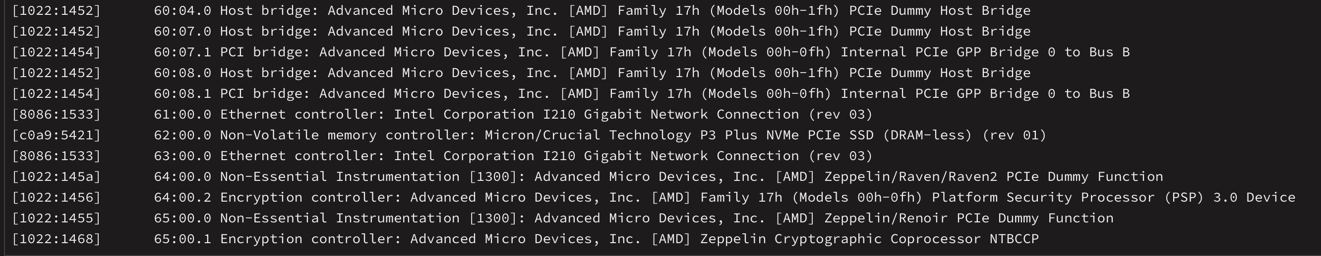

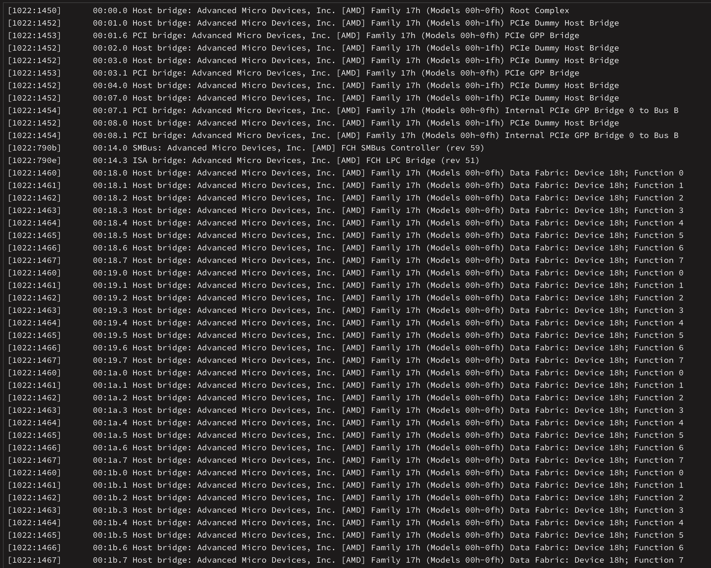

  4. thank you this is a good lead, i am see a bunch of lines saying host bridge under pcie so i am hoping that is it? here is what i see tho for more info so i guess the issue is if it is in fact seeing the how do i get teh system to see the drives i have plugged into the card?
