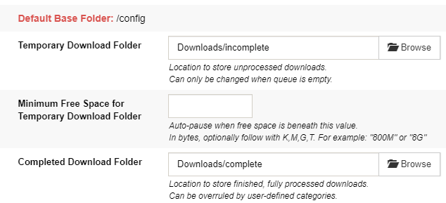

Thanks for the quick reply. You helped me solve it -- I had to add the leading "/" and change "Downloads" to "data".
I'm having an issue. In the configuration, I set my /data folder to be the location I have been using for downloads with qBittorrent (which I have no issues with). See the image. However, when I download something in SABnzbd, it goes to a download folder in the /config location. I'm not sure why it's ignoring my selected /data setting. And I can see in the Folders section of the Config in the application that it's using /config as the base folder location. So what can I do to get it to download to the correct location? Thanks in advance.
