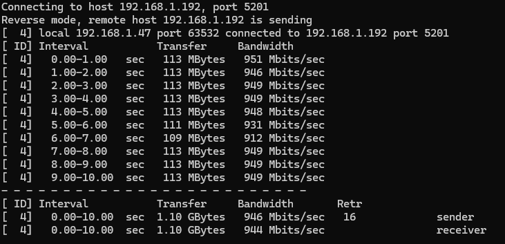

  6. thanks after stepwise swapping out cables, then ports on the switch (all were fine) it would up being the drivers for the NIC in the pC - updated to newest realtek and speeds back up to 112MB. appreciate the help

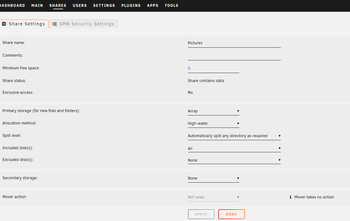

  7. Hi - for many years I transferred files to unraid at about ~110mb/s. Several years ago it dropped to ~95mb/sec and has been like that ever since. This is when using SSD cache drives and copying a file to cache (have tried via one large file like a windows.iso and same result). I was trying to figure it out today - both my PC and Unraid connected at 1GB, and both hardwired /not wireless. Iperf3 results seem to back this up with transfer to unraid at ~93mb/s and tranfer from unraid back to my PC at ~113mb/s. any ideas on how I can get the transfer-to-unraid back up to ~113 ? thanks
  8. thanks - I checked all of my other shares and they were at 195.3 GB - not sure why as I never set that. So I made this share the same thing. appreciate all of the help
  9. thanks - I can see the settings now. any idea why minimum free space is zero? and what it should be ?

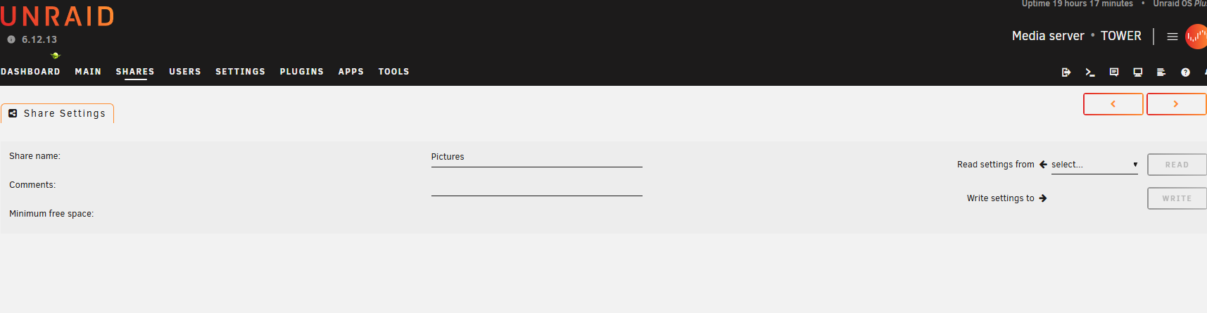

  10. Hi - misunderstanding on data.cfg- that was specific to the OP. for my issue with pictures - see below screenshot of the settings page for it, and for pictures.cfg contents. thanks

  14. also - the share that does not work is "pictures" all of the other shares have correct settings page
