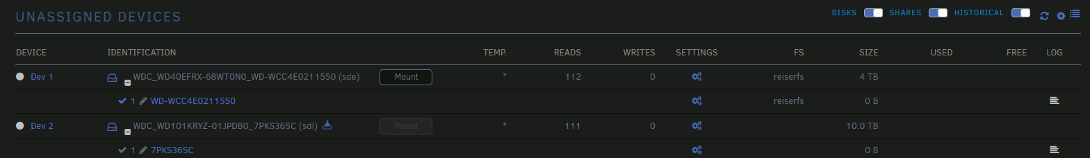

Somewhere along the way in the past week, I lost quite a few torrents that I had been seeding. I wanted to get the torrents I still have up and running on my Transmission plugin and get off ratio watch on the one tracker that I struggle to maintain ratio on. Once that's all working, I'll try to get the Transmission docker running again. Without looking back, I think you said I could mount the old cache drive as an unassigned device. Is that as simple as clicking the "mount" button that's there in the Main tab?

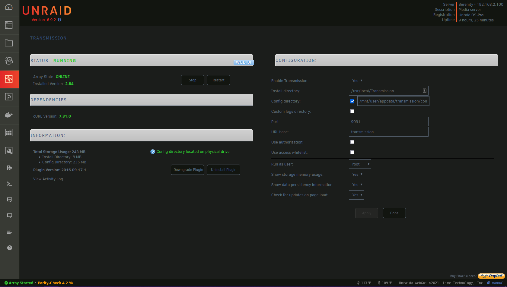

Transmission plugin is working. Here's what I get from command line: root@Serenity:~# rm -rf /mnt/disk3/system root@Serenity:~# ls -lah /mnt total 24K drwxr-xr-x 15 root root 300 Aug 7 23:05 ./ drwxr-xr-x 20 root root 460 Aug 8 08:13 ../ drwxrwxrwx 1 nobody users 66 Aug 7 23:15 cache/ drwxrwxrwx 12 nobody users 216 Aug 7 23:15 disk1/ drwxrwxrwx 11 nobody users 191 Aug 7 23:15 disk2/ drwxrwxrwx 7 nobody users 107 Aug 8 08:51 disk3/ drwxrwxrwx 13 nobody users 4.0K Aug 7 23:15 disk4/ drwxrwxrwx 12 nobody users 4.0K Aug 7 23:15 disk5/ drwxrwxrwx 14 nobody users 254 Aug 7 23:15 disk6/ drwxrwxrwx 13 nobody users 235 Aug 7 23:15 disk7/ drwxrwxrwt 2 nobody users 40 Aug 7 23:05 disks/ drwxrwxrwt 2 nobody users 40 Aug 7 23:05 remotes/ drwxrwxrwt 2 nobody users 40 Aug 7 23:05 rootshare/ drwxrwxrwx 1 nobody users 216 Aug 8 08:51 user/ drwxrwxrwx 1 nobody users 216 Aug 8 08:51 user0/ root@Serenity:~#
datruedave transmission plugin to docker (from [Support] Linuxserver.io - Transmission)
This: root@Serenity:~# ls -lah /mnt/disk3/system/docker total 0 drwxrwxrwx 2 dave users 10 Aug 7 22:51 ./ drwxrwxrwx 3 nobody users 28 Mar 16 2019 ../ root@Serenity:~# And here's the Transmission plugin screenshot.
