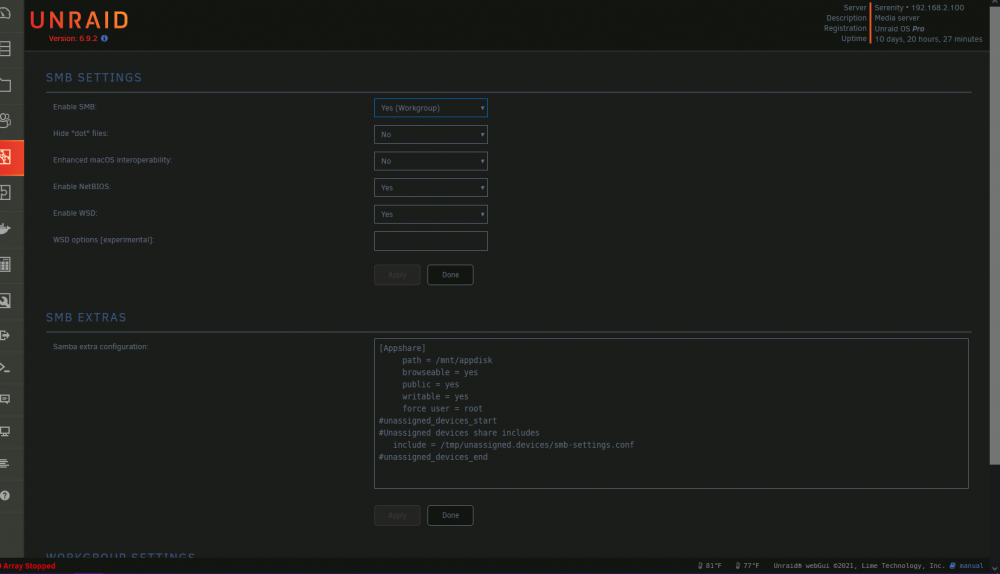

datruedave transmission plugin to docker (from [Support] Linuxserver.io - Transmission)
Ah, well, that's redundant, then. The share is set as public, but Windows still asks me for a username/pass to access. I just looked in the SMB settings, though, and there's still some "appshare" weirdness there in a section called "Samba extra configuration." Should I remove some of that?
