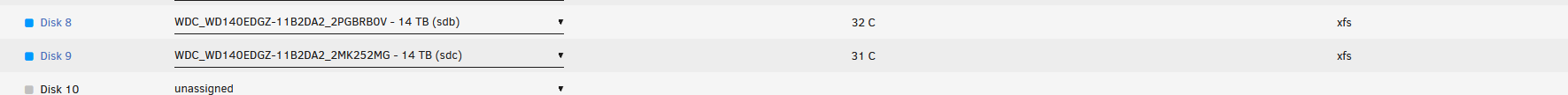

So after this test, I mounted and unmounted the drives (unassigned) and it was able to read the amount of data on the drive, I ran the file system check on both drives and now both of them say no file system corruption detected. Also I did buy and install a new card based on the recommendation of @trurl should I be ok to mount these drives back in the array and try to start the array again?
Drives became unreadable during parity check - now 2 are unmountable after reboot
So i upgraded, installed For drive in SDC (252MG) : For drive in sdb (RD0B)
