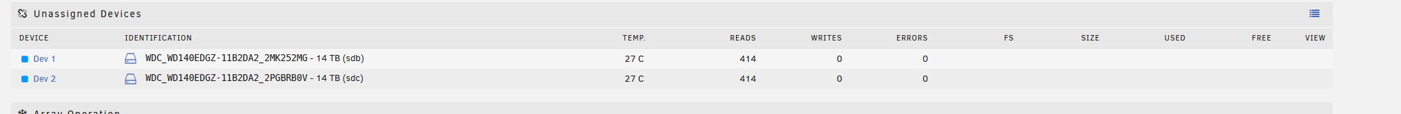

So after this test, I mounted and unmounted the drives (unassigned) and it was able to read the amount of data on the drive, I ran the file system check on both drives and now both of them say no file system corruption detected. Also I did buy and install a new card based on the recommendation of @trurl should I be ok to mount these drives back in the array and try to start the array again?

Hello, I woke up this morning and found some of my dockers weren't working this morning. However, I was busy with work so I couldn't get to it in the evening, when I looked at my unraid server I saw that my most recent 3 drives were listed as missing from the raid (the ones from the first screenshot. I have a 12 drive array with 2 parity drives. I have a Silverstone SST-CS308B case with a startech 3 drive hotswap bay with a PCIE drive extension card (not sure which one but I know i bought it from the known working list over 5 years ago). The 3 drives in question are in that 3 drive hotswap bay. I disabled the array (downloaded the diagnostics) and tried to get the drives detectable again but with no avail. I rebooted the server and now 1 of the drives are usable, but 2 are now listed as detected but unmountable. They've been in the system since December or so, they don't have too much data but i want to see if there is a way to make them mountable at this point. Thanks in advance. llnnas1337-diagnostics-20240313-1909.zip
