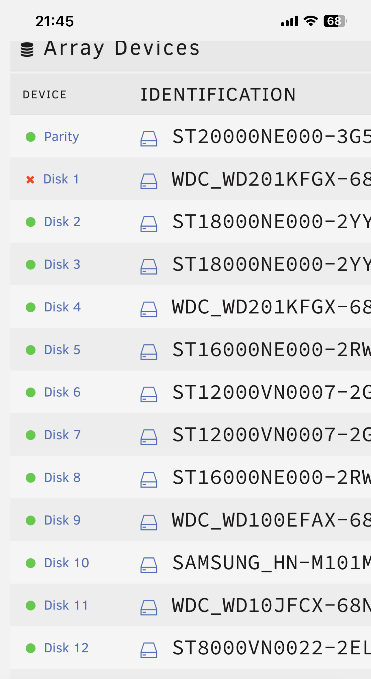

  1. Jorge, Thanks that's what I feared, I ordered a LSI 9211-8i to swap out with. My current one I ordered from ebay so a little worried it may not be as new as advertised, I currently have the pannel off of my 3U case and a box fan blowing directly onto the HBA and it still crashes. I'm going to try another PCI slot and see maybe if that will work. It just sucks that a fullo parity check takes 3 days to complete and it usually crashes after a day and a half Appreciate it. Did you by chance look at the log dated 20230823, i ran that the second crash after moving the expander and SAS cables. I'm sure its the HBA in that also.
  2. Hello gurus can someone point me in the right direction or maybe solve this issue for me. I had a drive (12TB) go disabled red x (Drive 6). I try to renabled it and to get it back online but couldn't get it back to green, I beleive the drive has read errors so I replaced the drive with a 20TB WD Red that I purchased and unfortuantly my noobness and stupidity did soemthing while I was trying to get the disabled 12TB to renable and UNRAID forced me to preclear and format the new drive thus losing 12TB of data. I rebooted before running diagnostics which was dumb of me, but honestly, I was worried about and focused on the 12TN of tv shows I was about to lose. Yes, I know I did soemthing and drive 6 should of rebuilt itself. So, I was running a parity check and after 12hrs parity checked paused and drive 4 became disabled, drives 1-6 are in the same disk shelf (EMC KTN-STL3 15 Bay connected to my server by SF-8088 to SF-8088 cable so I thought maybe it was a hardware issue, so I pulled the HBA, replaced the expander with a spare that I had and the SF-8088 to SF-8087 card and the cables. I moved the expander to a different PCI slot and reattched the SF-9-97 to SF-8087 cables in different positions. Long story short I ran another parity check, and it ran for roughly 20hrs and then paused and disk 4 went disabled again. I would lijke to rebuild my 12TB of shows back but as a parity check usually takes 3 days to complete, I would like to resolve the issue before I lcompletly corrupt 129TB of Movies and TV Shows. I'm assuming it's either the HBA or the expander. Like the HBA is resetting itself all the time. Suggestions, is there a type or quality of cables I should buy? tower-diagnostics-20230823-1527.zip
  3. JorgeB, this is the same expander and HBA from the last post, was just explaining that it’s newly purchased and installed back in May 2023. I was able to run a parity check and currently sitting at 22% with 1 synch error. I had to pull the Intel RES2SV240 24-Port Expander out and reinsert it and make sure all the data cables were secure. I think it’s not sitting right in the PCI slot because there’s no bracket to secure it down and any movement or vibration causes it to wobble which maybe the reason why it’s resetting itself a lot. After this parity check I’m going to find an old bracket and see if that fixes the problem.

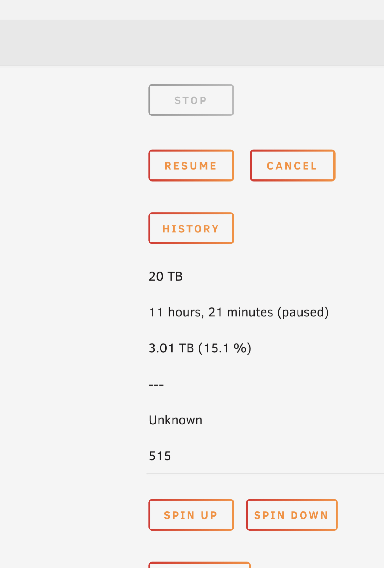

  10. Unraid 6.11.5 I keep having disks go into an error state during a parity check and it’s ticking me off and trying to zero in on the culprit. This has happened 3 times during a Pairty Check, usually within 10-15hrs into it the Parity check will stop and the server reports a disl going into error state. Drive 1 and 4 (20TB) were the ones that were reported. I'm sure I may of not made my post clear and unconfusing, I aplogize for that and will try to clarify anything in followup questions. I plan on checking the hardware connection’s tomorrow. syslog.1.txt.zip tower-smart-20230523-0643.zip tower-diagnostics-20230523-0648.zip
