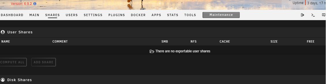

  1. Thanks for all of the assistance. All of my user shares and dockers are back.
  2. Thanks for looking into my issue. I've restarted the array in normal mode and it appears that the shares are back, but the docker service failed to start: I've attached the latest diag.tc-nas-01-diagnostics-20211026-0701.zip
  3. Hi, I increased the docker .img size from default for no particular reason... just did it because I had the space at the time. Anyway, I just rebooted and it gets even "better". ALL shares are gone now - disk shares AND user shares. Post reboot diag attached. tc-nas-01-diagnostics-20211025-2010.zip
  4. Hi, this just happened literally minutes ago. I've been having issues with my Unraid server and a corrupt file system on disk 2 for a while now. I ran the fixdisk utility and it came back with a whackload of files in the lost+found folder. Long story short is that I decided to rather than go through the thousands of files and folders, that I would re-import the data to the array. Anyway, my server has been busy, pulling over 3TB of data in the past few weeks and fast forward to just now when I realized that my cache drive was full. So (stupid?) me started a mover, then went to the share that was the culprit of the full cache and set the cache method to "no". Upon hitting "apply", I was greeted with "Share Deleted" instead of the usual blip and return to the share window with the new setting. I went back and looked at my other shares and they are ALL gone! Only disk shares remain. HELP!!!!! 🙂 Is everything gone? Is there a way to restore the shares/configuration? Diagnostics attached. tc-nas-01-diagnostics-20211025-1346.zip
