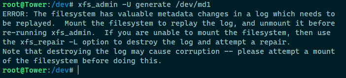

Okay, I tried that (using "/dev/md1", since it's disk1) and got the following error message: Is it safe to destroy the log? Is there a way to see what's in the log first?

Diagnostics attached. I guess worst case I can just reformat it as a drive in the array, and copy everything over a second time using the method you suggested, but the copy takes almost two days, so it'd be nice to avoid that... tower-diagnostics-20201027-0219.zip
