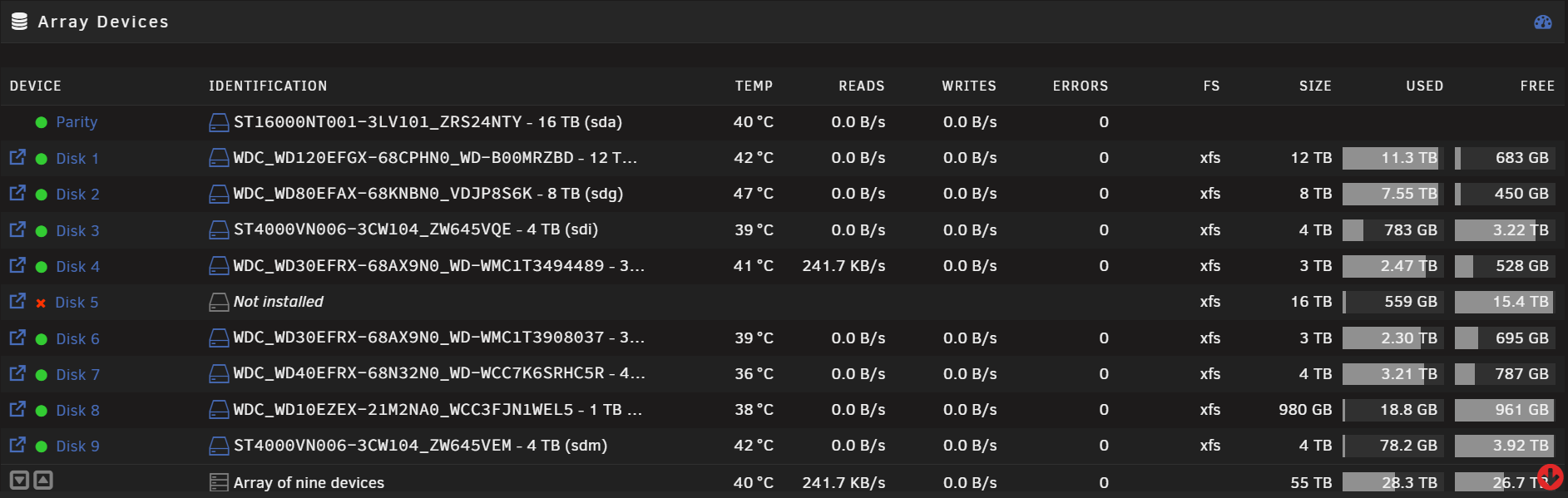

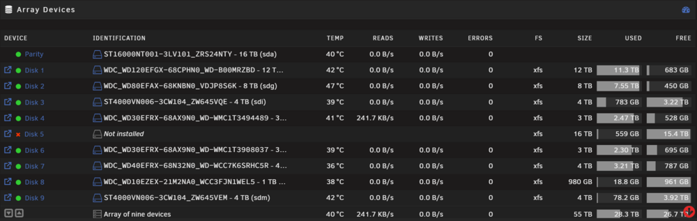

  1. OK I think I have this solved now. The bios updates looks to have made my two sata controllers stop working . I had a ASM1166 M.2 PCIE to SATA and another older PCIe to sata . I replaced those with one LSI 9300-8i mini sas to sata and all looks to be working fine now except disk5 that failed won't recognize in the Unraid server or using a dock on another machine that will be RMA'd. The controllers had been working fine for years previous to the upgrade.
  2. I switched power leads with another drive and no change. But lets put that aside I am fine to consider that drive dead and look at the bigger problem I am having. That is the issue of my bios update and the impact it is having on trying to do two things. I can't currently use unbalance to move files (which I would like to do before I try anything else) Iwas not able to complete a parity check
  3. I shut down , checked cables even moved the sata cable to an unused port and here is the diagnostics file after restart. tower-diagnostics-20260608-1241.zip
  4. The disk is still connected , I have not shut down the server or removed any cables or disks . Is the problem I have having not being able to run unbalanced now or the parity check before disk 5 was removed by Unraid being caused by this disk ?
  5. Yes it is in place still just disabled . I am not concerned with that disk right now and will pull it and test in a dock. My concern is why can't I run unbalanced to move the files from emulated to another disk and why I could not run parity check before this disk failed . Do you think it is all related to this disk being close to failing when I was trying to do a parity check that it was locking up the system? If it is still in my server connected but disabled could this be causing unbalanced to now run? I wanted to try to move the files before shutting down the server and removing this drive
  6. I don't have another disk to replace this failed drive right now and want to move the emulated files to another working disk. Two things are not working as they should and I suspect they are related I can't move these files from the failed disk emulated I could not run a parity check previously before this disk failed. Both of these tasks stall but shares, dockers etc still work.
  7. emulated disk 5 has 559 gb of data and the files are still available in SMB share from windows machine. As well when I try to use Unbalanced it finds Disk 5 emulated files, goes through all checks and shows good to move to another disk, when I start a move it starts as usual but then stalls and remaining time continues to go up with nothing moving.
  8. Here is the diagnostics file tower-diagnostics-20260607-0822.zip
