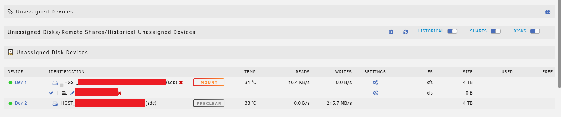

  5. Hello, I have a new 7.2.2 setup, with two drives currently unassigned. One disk should be idle, but it is always showing a little bit of read activity, and cannot be spun down. I have a recollection that on 6.12.x I could spin down unassigned disks reliably. Anyone have an idea how I can investigate this and get the disk fully idle and spun down? Thank you. disk that should be idle is "Dev 1" (sdb)

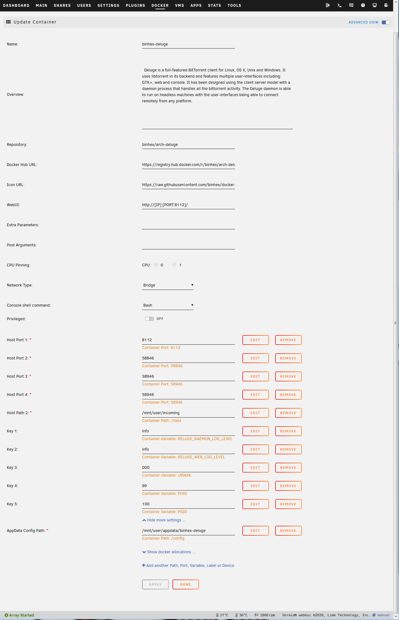

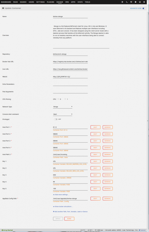

  8. For the previous post I had configured the container to use port 8118 as a test to see if the setting was being used, I don't run privoxy myself and nothing else was using port 8118 at the time. In any case, I restored the setting to port 8112 bridged, and issue still exists. Here's the screenshot:
  9. 1. no firewalls 2. no vlans 3,4. different browser, different machines, no change 5. wget calls from webterminal shell or from completely separate machine result in a sequence of: # wget http://192.168.0.185:8118/ --2020-07-14 21:26:32-- http://192.168.0.185:8118/ Connecting to 192.168.0.185:8118... connected. HTTP request sent, awaiting response... No data received. Retrying. --2020-07-14 21:26:33-- (try: 2) http://192.168.0.185:8118/ Connecting to 192.168.0.185:8118... connected. HTTP request sent, awaiting response... No data received. Retrying. ... ... which explains the in-container TIME_WAIT sockets - a connection got through albeit immediately ended 6. bridge or br0 both result in the same -- but I found an interesting behavior, a br0 always results in port 8112 bound (ignores configured port), whereas a bridge config will use the configured port number (as seen in the example above; and I can confirm that nothing is at 8112 as it results in "Connection refused") -- add: a. this behavior exists even after removing the container and /mnt/user/appdata/binhex-deluge and adding it fresh; I'll repeat things were working fine a week ago and I don't believe anything is different now with either my network or unraid setup b. unraid webterminal "iptables -L" output reports a set of "Chain DOCKER" rules when net is bridge, none when br0, consistent with other containers I have running
  10. Doubt there is a conflict - right now, I'm setup on br0 with a separate IP address (and other containers on br0, e.g. pihole, work fine). "netstat -al" in-container shows something listening on port 8112 ("tcp 0 0 0.0.0.0:8112 0.0.0.0:* LISTEN") attempting a webui browser connection results in multiple netstat "tcp 0 0 containerid:8112 mypc:highportnum TIME_WAIT" lines appearing "telnet localhost 8112" in-container gets a connection "telnet containerip 8112" from off-container results in an immediate disconnect and a single netstat TIME_WAIT line in-container (but I can telnet to my pihole br0 ip port 80 just fine...?!?!?!) -- add: last few log lines are: 2020-07-12 00:05:02,619 DEBG 'deluge-script' stdout output: [info] Starting Deluge Web UI... 2020-07-12 00:05:03,620 DEBG fd 8 closed, stopped monitoring <POutputDispatcher at 140388658095824 for <Subprocess at 140388658098032 with name deluge-script in state RUNNING> (stdout)> 2020-07-12 00:05:03,624 DEBG fd 10 closed, stopped monitoring <POutputDispatcher at 140388658095872 for <Subprocess at 140388658098032 with name deluge-script in state RUNNING> (stderr)> 2020-07-12 00:05:03,624 INFO exited: deluge-script (exit status 0; expected) 2020-07-12 00:05:03,624 DEBG received SIGCHLD indicating a child quit
