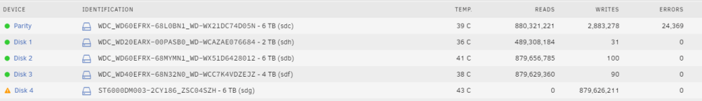

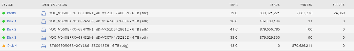

  18. I need some help please! Parity ran Sunday or Monday night, and was fine 0 errors. I then replaced a small (and old 13y+ drive) Tuesday, let unraid rebuild and saw this when I checked in this morning. I had some loose cables when I first booted back up, reseated them all and added the drive to the array. That's a lot of errors! WDC_WD60EFRX-68L0BN1_WD-WX21DC74D05N-20230712-0631 parity (sdc).txt syslog.txt
