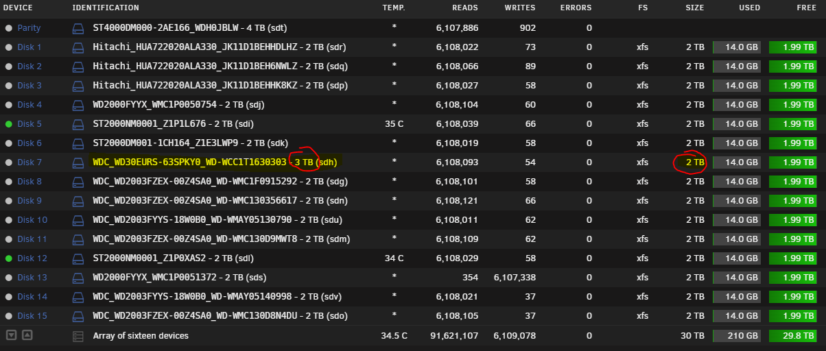

  1. which part, the cards or not in JBOD? We will verify that, thank you. Changing Subject to [Solved]
  2. 2x SM AOC-SAS2LP-MV8 cards in JBOD Thank you for the recommendation on the fs repair, we are trying it now.
  3. Thank you, Please find attached. (we are aware of the SMART errors, these are old WO disks being used to template) ms2-diagnostics-20211101-1309.zip
  4. of course the rebuild of the replaced disk took place. I've actually swapped in a second 3Tb and did a full rebuild and still the "size" identity shows 2TB
  5. Hello Everyone, I dont want to recreate the Array as this is a test bench before i go live with it, and this was a test which I'd rather resolve than scratch and rebuild. On my current production environment, I can easily swap disks and everything works correctly. However, i cant solve this issue. Disk was precleared. I swapped in a 3TB for an artificially failed 2TB (unplugged). Any suggestion? The disk information shows 3TB, I'm just assuming this is a display issue under "size" (note the parity is 4Tb so the 2TB limit consideration does not apply)
