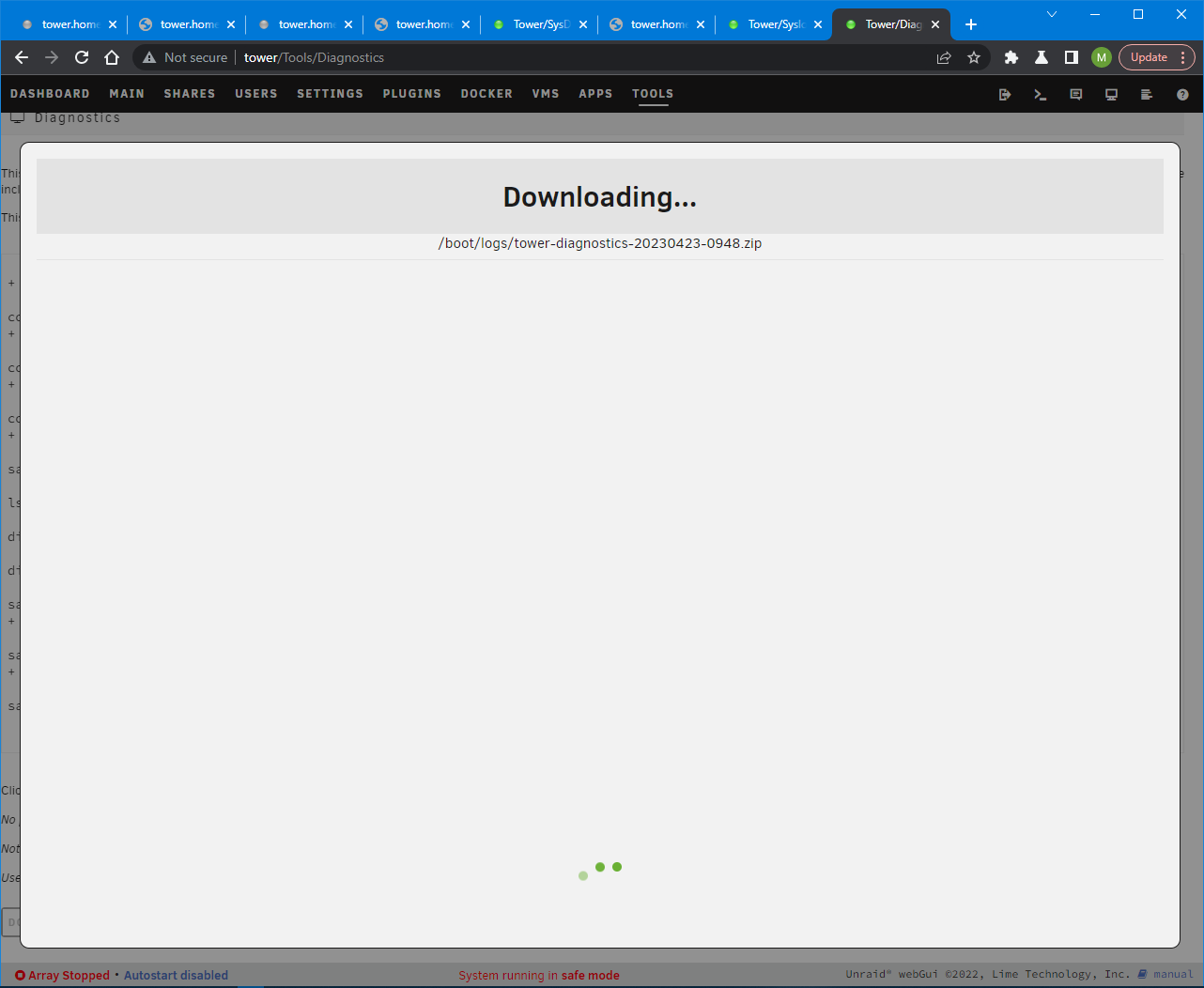

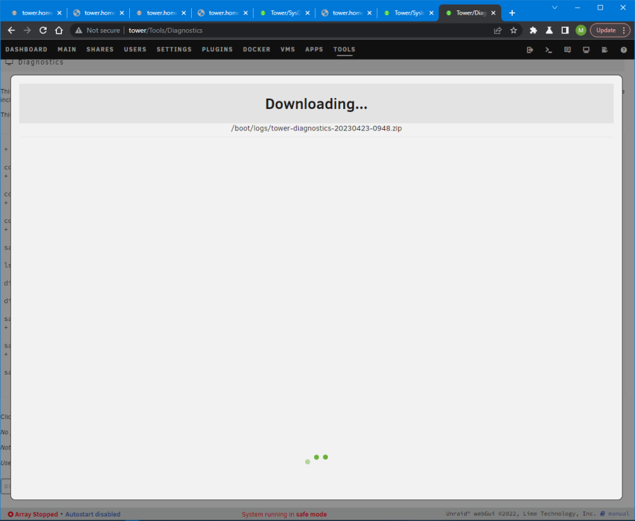

  6. Sad that this is still the same problem in 2024. Not even that it happens at all, but that the error message is so unhelpful. I mean, a simple "Partition error, remove partitions" message would go so much further. I ended up removing the partitions in Disk Management and then using diskpart to do a clean (might not have been needed, but might as well) on the disk and it worked with downloading an image and no UEFI boot (unchecked box.)

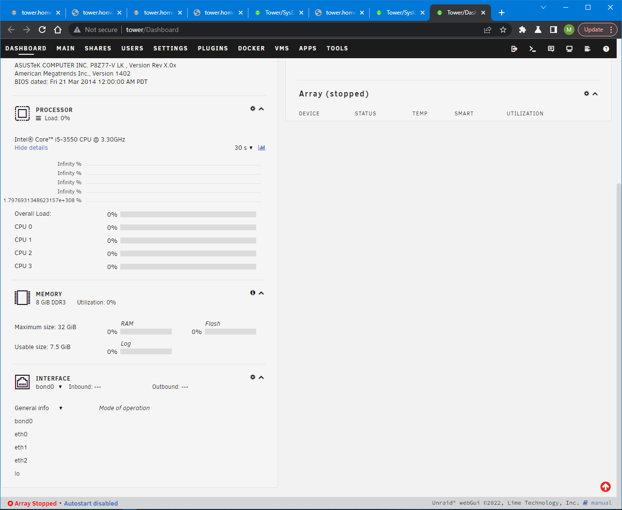

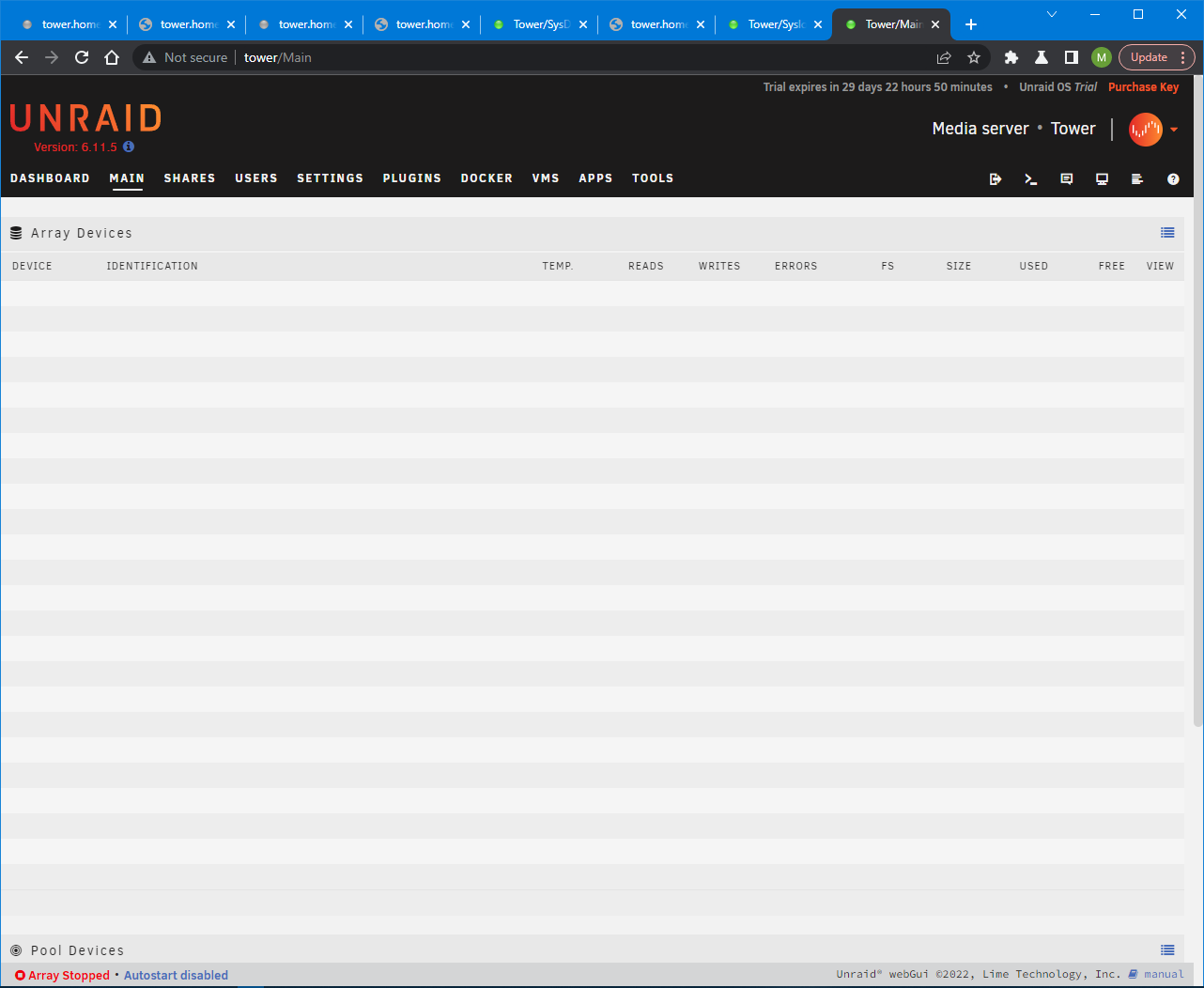

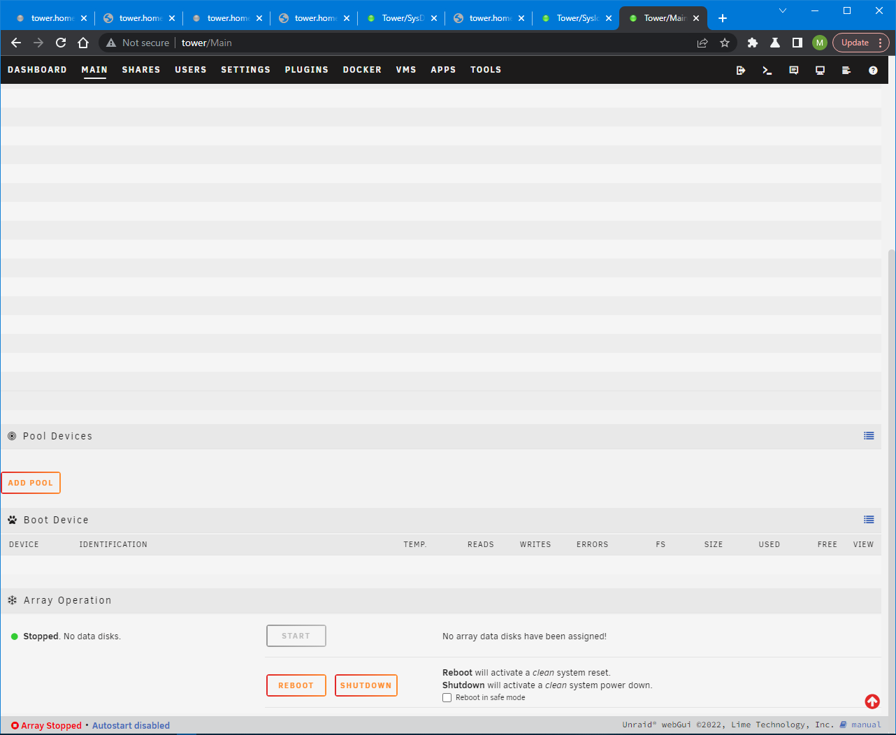

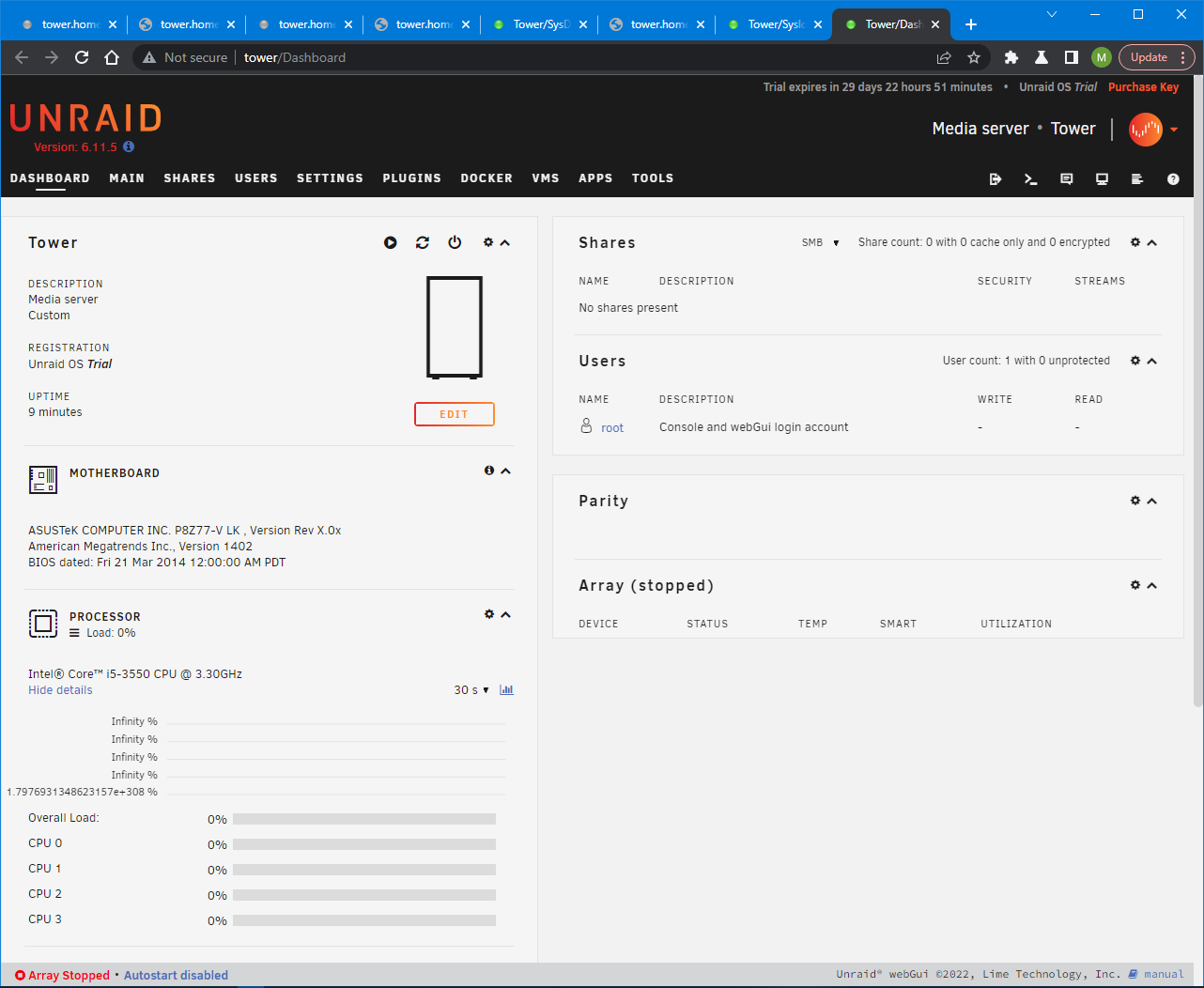

  7. It's a browser issue. This whole time it's been Chrome not showing the page right. Opened in Firefox and it's great. I had re-seated the CPU, then replaced the NIC and at one point the drive list of un-assigned slots showed up, then couldn't get it to come up again. Had an epiphany and tried Firefox, worked great. Actually works in a different instance of Chrome, even. Holy hell.
  8. Safe mode looks about the same. Still no disks showing, but with the added "System running in safe mode" at the bottom of the screen. Started a diagnostics download, it's been sitting like this for the last 10 minutes or so. I'm about to at least re-seat the CPU, though you'd think that a CPU connection issue would kinda be an all-or-nothing situation. I might have another CPU that would work in this board sitting around to swap out. Still trying stuff. Just strange that it got weird like that all of a sudden. Also going to try a different NIC. Shouldn't be the issue, but, never know. It's something I can try.
