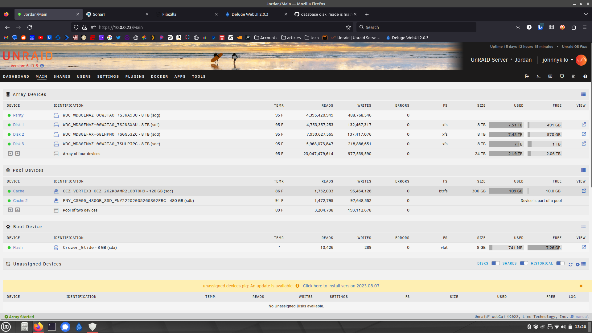

  1. So I am probably missing something, admittedly, but need some help. I started with a single 120GB cache disk. I had a second 480GB SSD laying around so I installed in and intended to add it to my cache. UNraid says 300GB available (I'm assuming there's some kind of mirroring) but I only seem to actually have 120GB usable (the size of my primary cache disk). Screenshot and diagnostics attached, Thanks, jordan-diagnostics-20230812-1320.zip

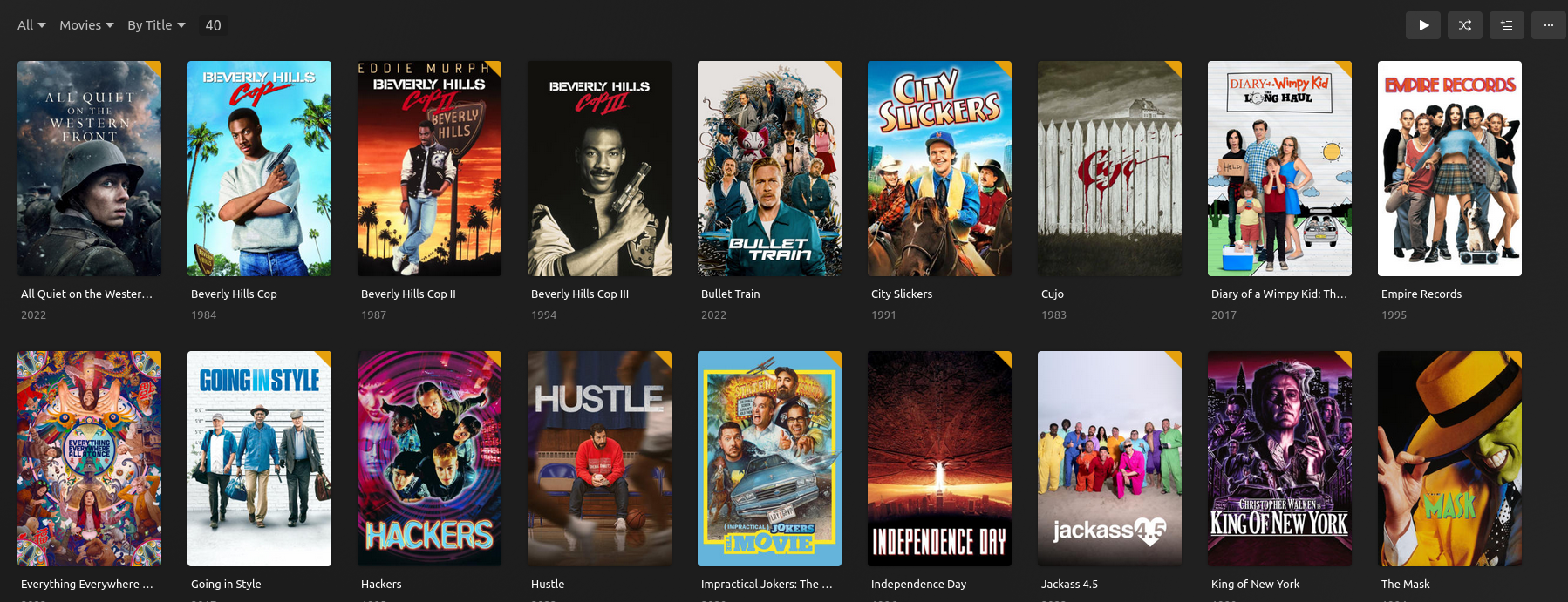

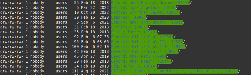

  3. I have approximately 1000 movies and I fired up Plex one day last and only saw about 40 of them. After digging in it appears to be a permissions issue. For example I see the Beverly Hills Cops movies and the folders seem to have drwxrwxrwx ( believe that's 777). I recently had to change some permissions for Radarr and Sonarr to start up, I dont remember exactly what I did to be honest. Why would 666 permission not be enough for plex?
