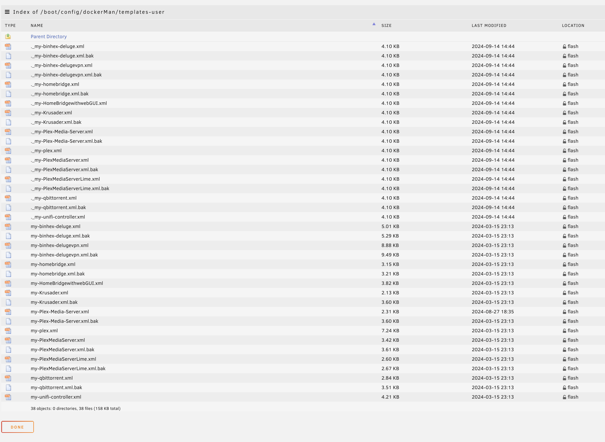

  1. Thank you! However, i don't see my templates in there. See attached. Am I doing something obviously wrong here?

  3. thank you! Removing those files didn't change anything.

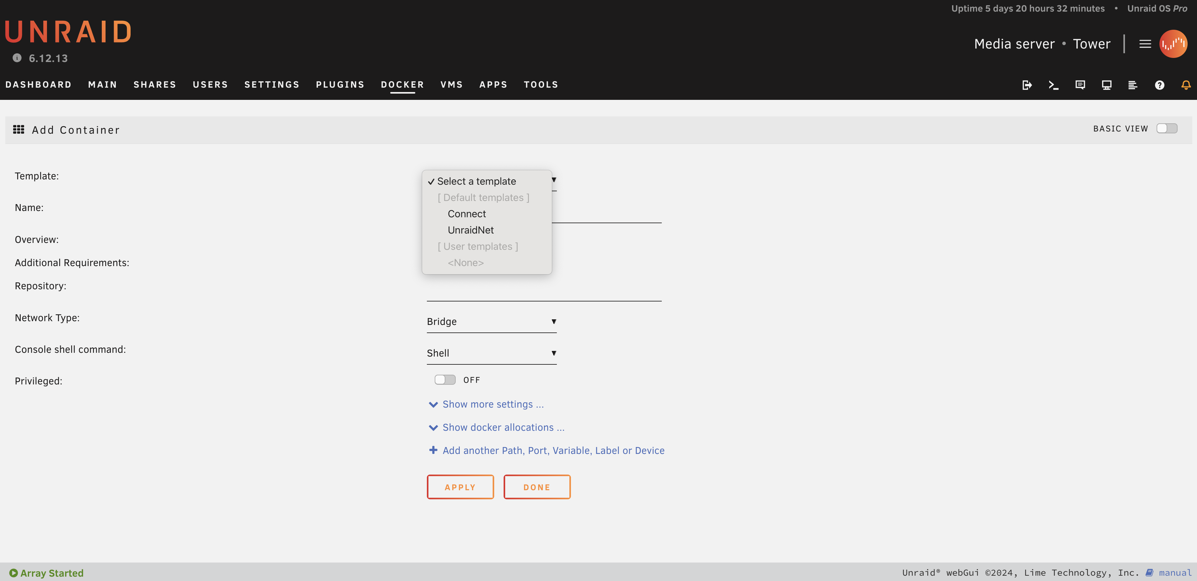

  4. "No Matching Applications Found" is there an apps folder I should be restoring from the old config?
  5. Hey thanks! I finally got around to doing this. Turned out my PSU died somewhere along the lines as well. Hopefully that was the reason i was getting random reboots. Anyways, i did a clean install of unRAID and restored the key, supder.dat, pools folder, and i copied the entire /boot/config/plugins/dockerMan/templates-user to the new flash. Everything seems to be in place, however the OS is showing no Docker Containers installed. Any idea how I restore those? thanks! F
