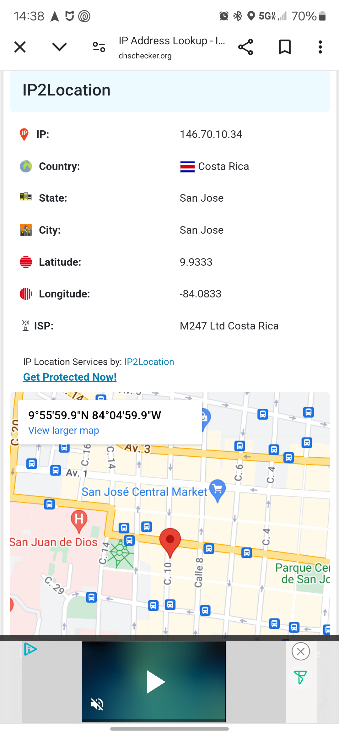

  24. why is it when i use the VPN my logs are flooded with this error? Aug 9 07:51:38 UNRAID kernel: br-f7d9c5297b05: port 25(vethd250265) entered disabled state Aug 9 07:51:38 UNRAID kernel: br-f7d9c5297b05: port 25(vethf5c23d6) entered blocking state Aug 9 07:51:38 UNRAID kernel: br-f7d9c5297b05: port 25(vethf5c23d6) entered disabled state
  25. sanjose.privacy.network What the error log is saying. That domain, when it looks for it is not coming back with an ip.Address for it. Try changing your endpoint to a different domain. This is what the domain comes back with
