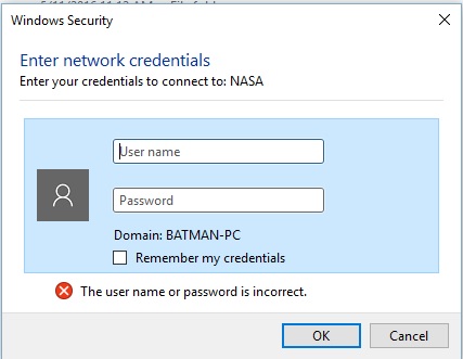

  5. NASA2 is allowing me to see the shares. NASA is still shown... but still requires credentials.
  6. I can't thank you guys enough for all the help. Thank you. BTW, the credential requests came back again. Ok, Installed local master Plugin and NASA is the current master browser. Might have found something... Checked my Win10 laptop and again was asked for credentials to view network shares. Checked my daughters WIN7 machine and clicked on the Network/NASA and it showed files from a older network I also called NASA I assume. I am going to rename NASA to NASA2. I have not rebooted my router or server today or turned off any PC. The only tinkering I am doing is using PLEXCONNECT (python script for AppleTV3 PLEX hack) which coincidentally has been up and down also...

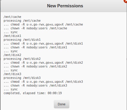

  7. I first ran the tool/new permission script as shown without success. I used the fix/common problems and also had no success. I then used the extended test without any success (I thought). About an hour later I came back to the machine and HAD ACCESS with being asked for credentials. AWESOME. _______________________________________________________ SMB Settings: Share Name NetData Torrents Backups system appdata Export Yes YEs Yes no no Security Public Public Public Public Public I have not mapped any drives in Windows and just use windows explorer - network. I am accessing the UnRaid from my main machine on my network (Big Family network). 2 points I must mention: 1) The Fix Common problems plugin was not happy with my docker dir assignments but Plex works fine. 2) Always had a "Homegroup" network problem on my network once the migration to Windows 10 happened. I am not able to setup a working "Homegroup" as there is a phantom "Homegroup" still on the network that can't be deleted. I gave up on it after trying everything google would throw at me. Basically I am unable to start a new Homegroup or join a homegroup because after the proper passwords are submitted it eventually times out and says the homegroup can't be found. I'm not ready to reformat all 7 PC's in the house to solve it...
  8. No luck so far, ran the permission tool 16 seconds. I ma not a linux guy but an old dos guy so if you throw some commands my way I'd give it a shot. Thank you for the help.

  10. I changed TOWER to NASA I have tried all passwords and logins I know. I don't have a login for Windows 10.
  11. Thank you for the reply. I deleted credentials and tried at least 5 other googled solutions and out of the blue I had access again! For a day. Used all morning moving files around and then ... Again wants credentials. deleted and rebooted , nope still wants access. I knew something was up as I would copy a file and windows wouldn't let me paste it to another directory.
