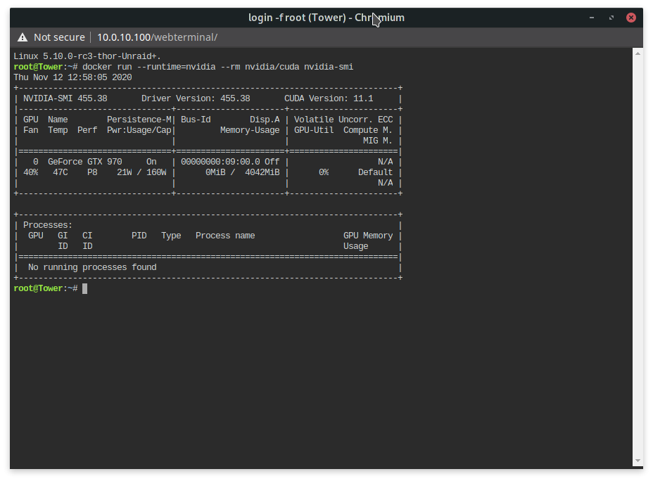

I found the problem it needs an updated driver .... the nvidia docker is using cuda 11.1 and the 450.80.02 driver that is included in the last kernel has cuda 11.0 lol its a mismatch ...
[KERNEL]unraid kernel update 5.10rc4 - zenpower|it87|corefeq|amdgpu|jmb575|dvb|r8125|openrgb|reset AMD GPU|zfs|dax|exfat|ntfs3|nvidia driver
yes I can reproduce it... I think the last version kernel has an issue with docker nvidia..... will look into it in the next version....
