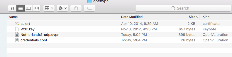

  12. Attach the supervisord.log located in /config/ watch out for credentials Sent from my SM-G900F using Tapatalk I removed all the credentials I could see that looked sensitive. If you see anything that shouldn't be there let me know, also if you need some more detail I can provide. Thanks in advance, and for the fast response. Is the port specified in the ovpn file 1198 if not then please change and try again. Sent from my SM-G900F using Tapatalk Here are the contents of the file, changing the port did not seem to make a difference. 1198 looks correct according to the ovpn file, I'm assuming you also have downloaded the ca.crt file and put it in the same folder yes? Sent from my SM-G900F using Tapatalk Yes, the certificate and other files are there. Here are the contents of the core.conf file too
