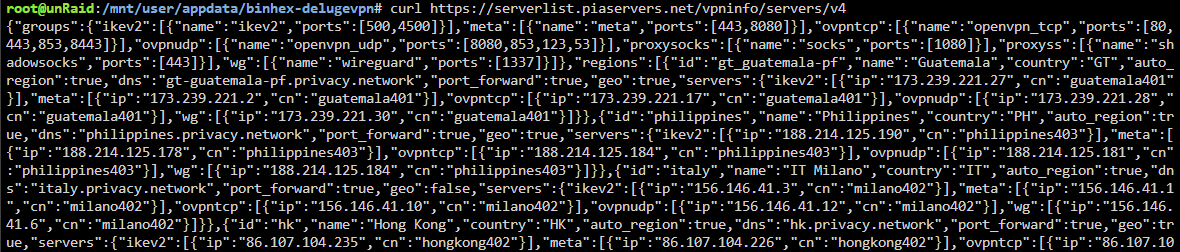

  2. As far as the container, it automatically updates daily so I think that should take care of the request to make sure it's the latest version. From the web UI I see it's 2.2.0 which looks like it's the latest client As far as the URL, that's an interesting story. The URL works from my Unraid console as can be seen here: But it looks like when I'm connected to the VPN it doesn't work: I had tried a few different servers as trouble shooting and chose servers that were listed within that list and had the port_forward: True setting (I had remembered that being a thing a long time ago). I'll try scratching my vpn file and going with a new one and will swap out to your suggested server as well and see if I can get it to work with port forwarding.
  3. That was it! Thank you so much. Yeah I've had this running since maybe 2016? It just always has worked so I rarely have to tinker with it lol.

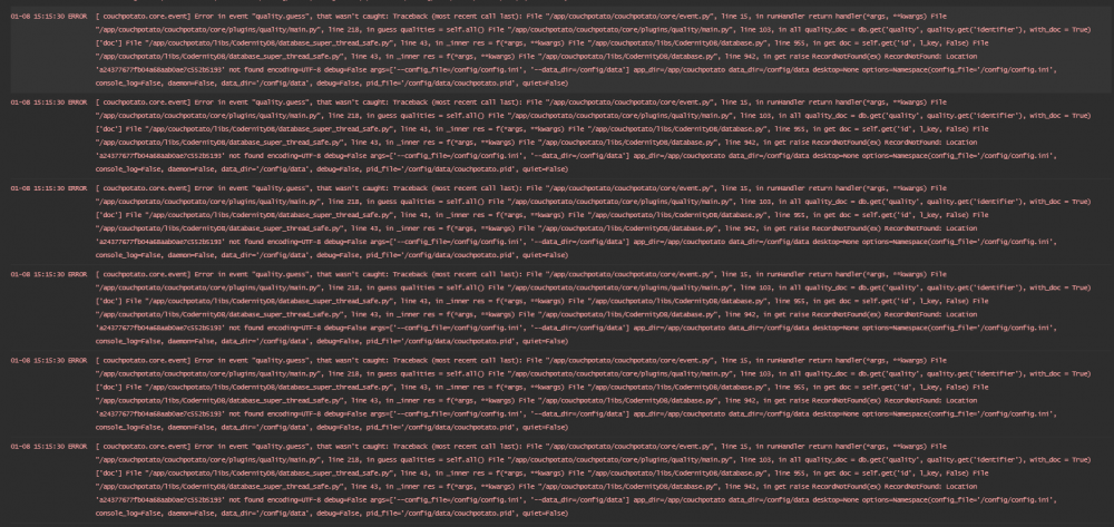

  9. Recently my CouchPotato docker decided to crap out and I'm not sure why. I'm trying to fix it without having to rebuild it from scratch if it's at all possible. I don't know exactly when it crapped out as I don't check it all that often, it just does its thing and I leave it alone, but I went to add a movie today and found it wasn't behaving correctly. My Docker run command /usr/local/emhttp/plugins/dynamix.docker.manager/scripts/docker run -d --name="CouchPotato" --net="bridge" -e TZ="America/New_York" -e HOST_OS="unRAID" -e "PUID"="99" -e "PGID"="100" -p 5050:5050/tcp -v "/mnt/user/Storage/Videos/Temp/CompletedMovies/":"/downloads":rw -v "/mnt/user/Storage/Videos/Movies/":"/movies":rw -v "/mnt/user/Storage/":"/storage":rw -v "/mnt/user/appdata/CouchPotato":"/config":rw linuxserver/couchpotato f6a5fd43b7796d4bec5f13579dc5c82aa3b14c987075bd516d580b835d943e32 My CP docker log file [s6-init] making user provided files available at /var/run/s6/etc...exited 0. [s6-init] ensuring user provided files have correct perms...exited 0. [fix-attrs.d] applying ownership & permissions fixes... [fix-attrs.d] done. [cont-init.d] executing container initialization scripts... [cont-init.d] 10-adduser: executing... ------------------------------------- _ _ _ | |___| (_) ___ | / __| | |/ _ \ | \__ \ | | (_) | |_|___/ |_|\___/ |_| Brought to you by linuxserver.io We gratefully accept donations at: https://www.linuxserver.io/donations/ ------------------------------------- GID/UID ------------------------------------- User uid: 99 User gid: 100 ------------------------------------- [cont-init.d] 10-adduser: exited 0. [cont-init.d] 30-install: executing... Cloning into '/app/couchpotato'... [cont-init.d] 30-install: exited 0. [cont-init.d] done. [services.d] starting services [services.d] done. Before I tried restarting it several times I was getting a Errno 98, address in use error in both Docker and on my CP logs. I tried switching the port CP ran on at least through the docker but that didn't have any effect. I can get to my Web UI in CP and view my logs which is filled with 3 pages of errors every time I restart. A sample can be found in the attachment. One other thing I did notice, when I go to the edit screen of the docker the port is red which I imagine is an error of some sorts, maybe that the port is in use but no other docker is using this port. I even shut down docker and brought it back up with only CP running and it's still red. I ran a netstat -l on my unraid server to look and I see no mention of anything using port 5050. The most recent thing I did to my server prior to noticing this was to setup PlexPy but I think it was happening before then even, I just didn't notice it. Any suggestions?
