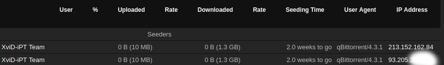

  5. 0) I have been running your DelugeVPN container for years but am in the process of switching to qBt, so currently both containers are in use. Both behind a VPN. 1) I am not sure if I understand you correctly but there are no special rules for the ipt tracker. Globally, qBt is set to TCP only (I read that uTP could cause problems within VPN tunnels) and the listening port is the same that is forwarded on AirVPN. This port has been additionally entered into the config file as per your example config: port_range = 49400-49400 port_random = no 2) While performing this step, I realized the ovpn files I have been using so far are for the UDP protocol as this protocol is recommended by Air. Should I create one for TCP instead? After writing my previous comment I stopped both containers and restarted them when I read your reply. There were no disconnects for like 30 minutes. Maybe it is an issue only occurring right after booting? I will look into that. That being said, I have changed the qBt container to a different endpoint (country). There are no connections issues at the moment and ipt is only showing vpn ip's. 3) Here is the log file. supervisord.log
  6. Strange. I can reproduce the leak though as you can see in the screenshot. This is the same torrent listed twice immediately after booting. It could be a problem with IPT in general as the deluge container returns "error: host not found (non-authoritative), try again later". The Deluge torrents aren't shown at all on IPT. Maybe the containers are interfering somehow? Btw, are we supposed to bind the network interface to tun0 under advanced settings or wouldn't make that any difference?
  7. This morning, I noticed what I think is an IP Leak. On IPT in the active torrents section, all torrents seeded with the qBT container are listed twice. One entry is attached to my real IP address while the other one is the AirVPN address. Can you tell from the log why this is?
