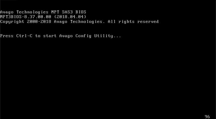

  12. Ah I think you may not be getting the screen cause your OS is booting in UEFI mode, change it over to CSM/BIOS mode, you should then get a BIOS post screen for the card. This isn't the exact screen but its very similar.
