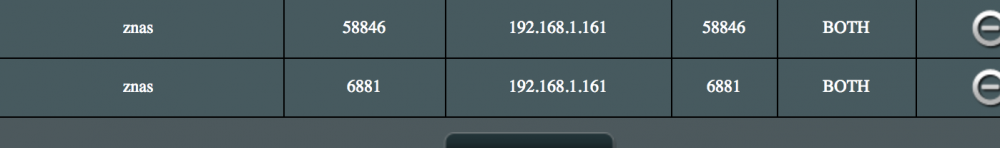

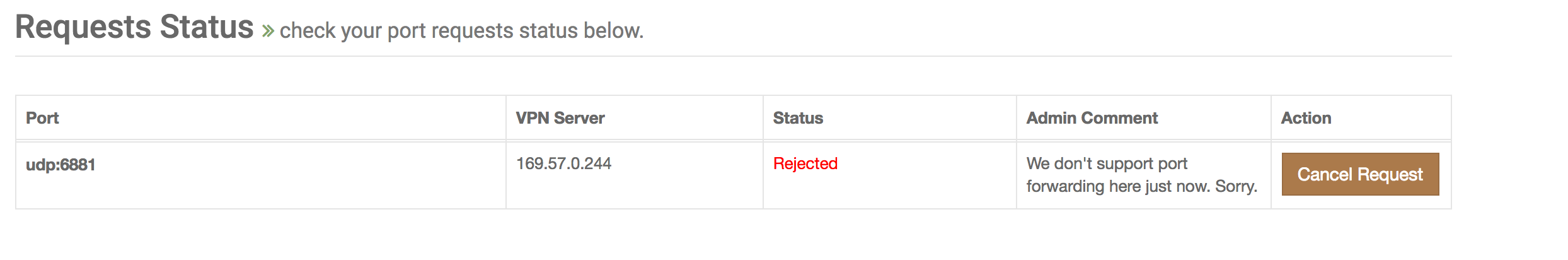

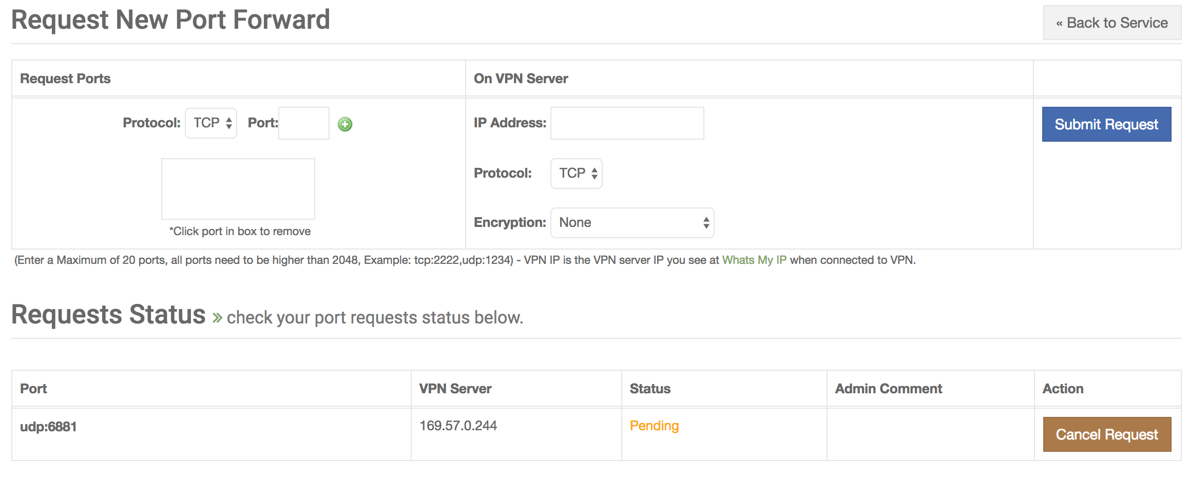

  1. so you defined port 6881 on the vpn providers website right?. missed your first screenshot, that im assuming is a snippet of your routers webui right?, if so then your thinking about this in the wrong way, you dont setup the incoming port on your router, you set it up with your vpn provider and then configure deluge to use that port. requested the port in torguard. let's see how it goes. thanks looks like torguard doesn't allow port forwardining. any other alternatives?
  2. so you defined port 6881 on the vpn providers website right?. missed your first screenshot, that im assuming is a snippet of your routers webui right?, if so then your thinking about this in the wrong way, you dont setup the incoming port on your router, you set it up with your vpn provider and then configure deluge to use that port. requested the port in torguard. let's see how it goes. thanks
  3. ar... thought only needed on my router. let me try that and report back. thanks.

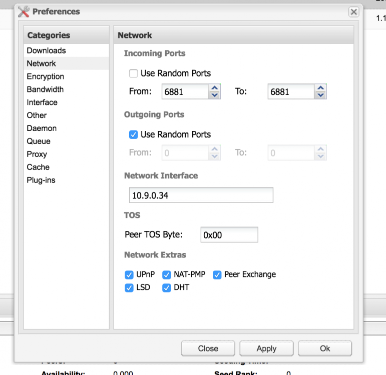

  4. have you set up a port forward and then defined this port in deluge as your incoming port?, if not then you will have VERY slow downloads and the torrent used to check your connection is secure will most probably also fail (which is what your seeing). yea, i double checked to ensure i did that.

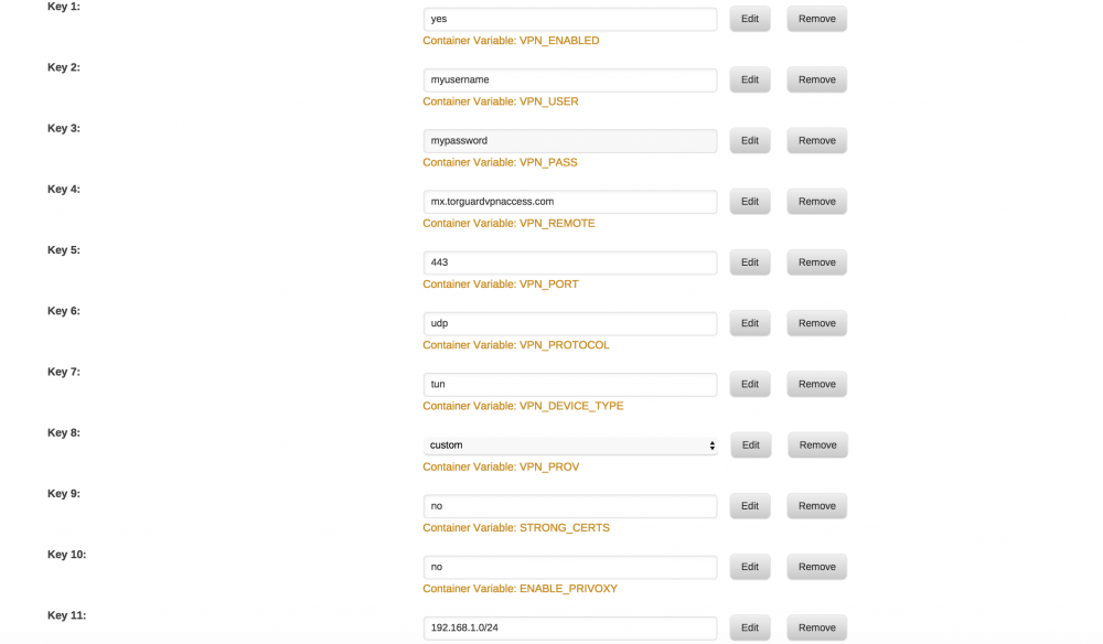

  5. Hi, i followed the instruction and have set it up with torguard as the vpn provider. I am able to bring up and access the webui. However, the download never starts due to "Tracker Status: checkmytorrentip.net: Error: Connection timed out". any help would be much appreciated. following is the latest log
