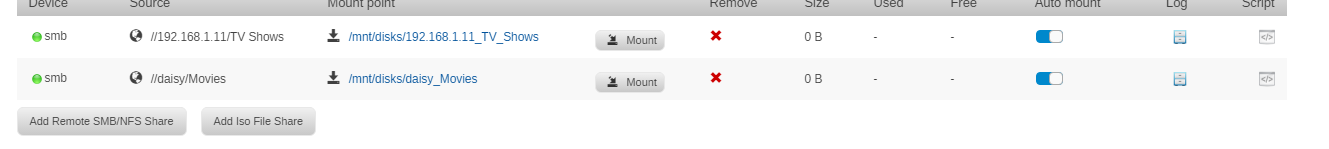

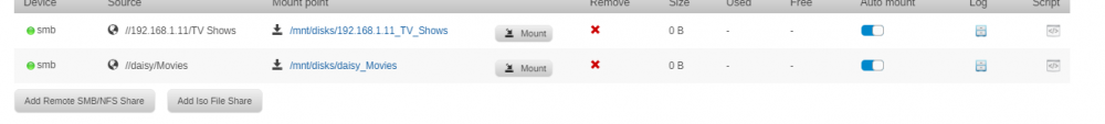

So cleared the log files and tried to mount again. This is what i get in the log Jan 30 07:07:57 Mount SMB/NFS command: mount -t cifs -o rw,nounix,iocharset=utf8,_netdev,file_mode=0777,dir_mode=0777,username=guest,password=******* '//daisy/Movies' '/mnt/disks/daisy_Movies' Jan 30 07:07:57 Mount of '//daisy/Movies' failed. Error message: mount error(5): Input/output error Refer to the mount.cifs( manual page (e.g. man mount.cifs)

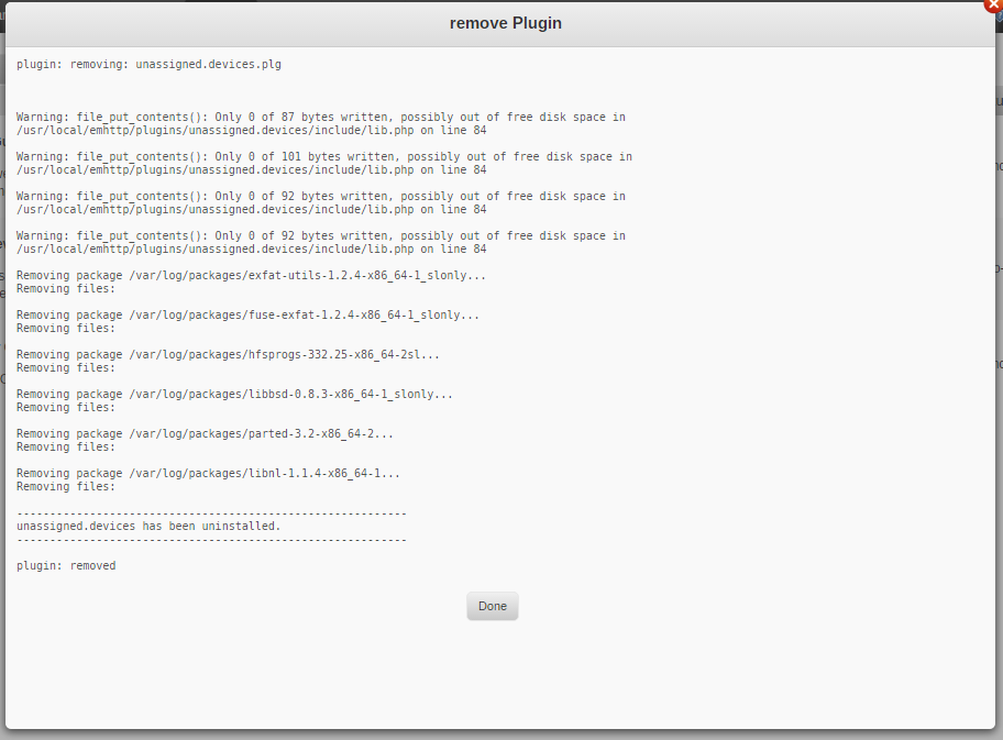

It seems to install fine though?
It just sits and spins and doesnt show anything. I also tried removing it and reinstalling it and i got the following errors.
Ok. I tried a different share on the old nas. One that is smaller in size. I recall seeing something about size. These two shares I'm trying to mount are in the TB size, like 10 and 12 TB. Could it be a time out issue?

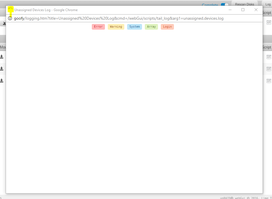

The share it's using is set to guest access and I can see it from other machines just by going to the share (no login). Is there a different location for logs since that one log button doesn't show anything?

Ok so there's the problem. I thought that but every time I hit mount nothing happens and there isn't anything showing up under that log button either.
