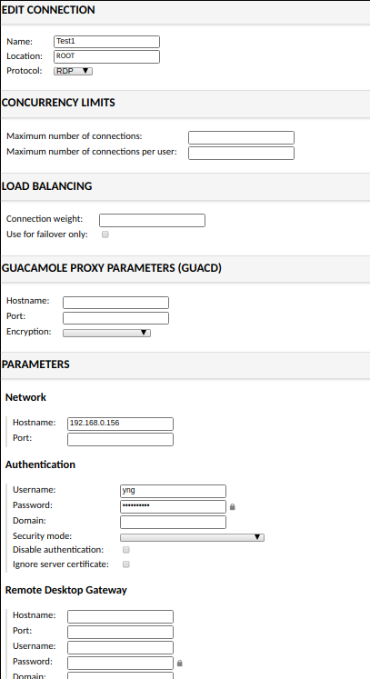

  13. @Taddeusz I tried to put 3389 in the port number below the hostname for the RDP connection and receive the same output and the logs don't have any new errors.
