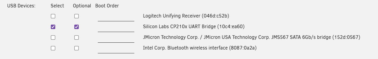

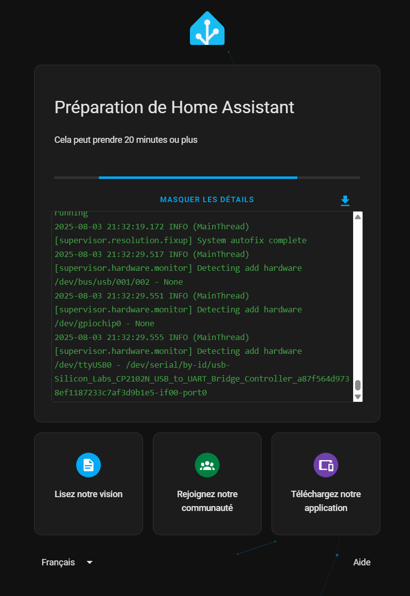

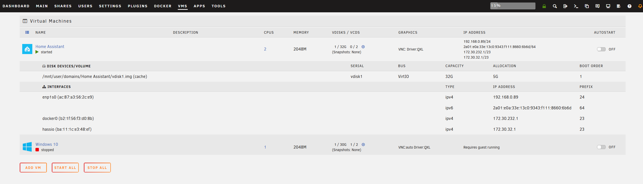

Yes, i just tried again. Here's what my VM looks like Home Assistant can find it during setup And yet ...

If i remember correctly i also already tried that, but i'll try again. Docker run looks like this --device='/dev/serial/by-id/usb-Silicon_Labs_CP2102N_USB_to_UART_Bridge_Controller_a87f564d9738ef1187233c7af3d9b1e5-if00-port0' 'ghcr.io/home-assistant/home-assistant:stable' No luck

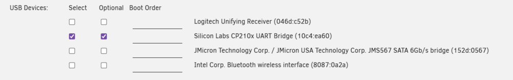

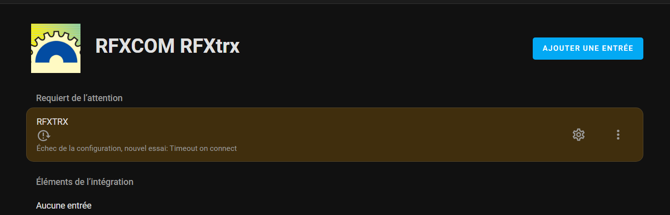

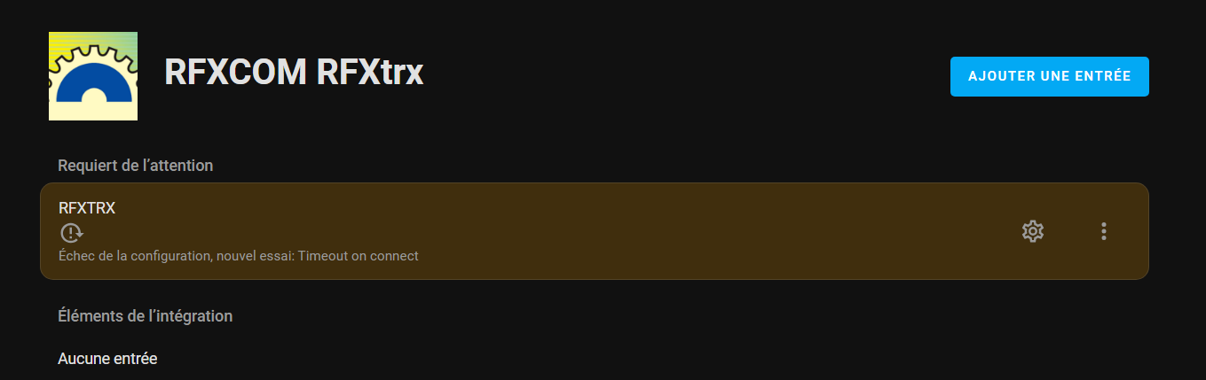

Hello folks. I am trying to make my RFX433 (the 2025 model) work in Home assistant, running on my unraid server. So far, i have been able to add the RFX integration to home assistant, and tried to make a passthrough for the usb RFX that looks like this : Problem is, While the integration was able to be installed in home assistant, everytime i try to follow the RFX433 PDF to have my Somfy devices connected, i get this loop “Initialisation > Timeout on connect”. I have tried restarting the RFX, tried restarting the HA docker, but no luck. Strangely enough, after restarting it, when i do the setup, it appears as ttyUSB1. I also tried to put /dev/ttyUSB1 in the docker passthrough but same error happens. Finally, i tried to restart the whole machine (Unraid server). Now the RFX is showing up as ttyUSB0 but still having timeout error. What am i doing wrong ? Any help to make this work would be great. Additional info : RFX works fine on my windows computer. Is up to date. HA is also up to date aswell as Unraid. I have since then did some more troubleshooting : I tried to passthrough a bunch of different thing, /dev/ttyUSB0, /dev/serial/by-id/usb-Silicon_Labs_CP2102N_USB_to_UART_Bridge_Controller_a87f564d9738ef1187233c7af3d9b1e5-if00-port0, /dev/bus/usb/001/002 aswell as the whole usb bus but nothing). The device DOES display in unraid so i know it's not dead. I tried multiple usb ports. This is my computer hosting unraid. I tried front usbs, back usbc, aswell as usb-c. No luck. I went from the "official" HA docker to linuxserver docker, aswell as Spaceinvader1 docker/VM but same error in those 3 home assistant. I also tried to spin up a windows 10 VM and do a passthrough there. And while i was able to see the device in device manager, i was unable to install the drivers and make it work in windows VM. It looks like the VM wasnt able to associate the device with the installed drivers. I also found out that in the docker log, there's an error poping up everytime it goes into a "timeout on connect" loop. I would really like to not only fix it but understand what's happening so that, if i add another similar device like a zigbee stick, i can fix it instead of fighting with it for weeks. PS : i've put Docker Engine as a sub forum because i can't select docker container for some reason.

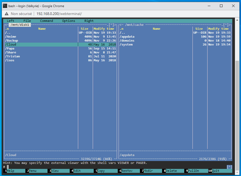

I tried moving the files from the shares to my computer and then back to the folders, expecting the "cache : only" to put everything back in cache but diagnostics are still giving me the "exist on cache, disk1" thing. Is there any specific thing to do to get everything for those 2 shares back on cache ?
Help me troubleshoot why my drives arent going to sleep anymore.
I don't trust the mover much because i never know what it's doing. i work in IT, so if i have to do some terminal commands, i think i can manage
