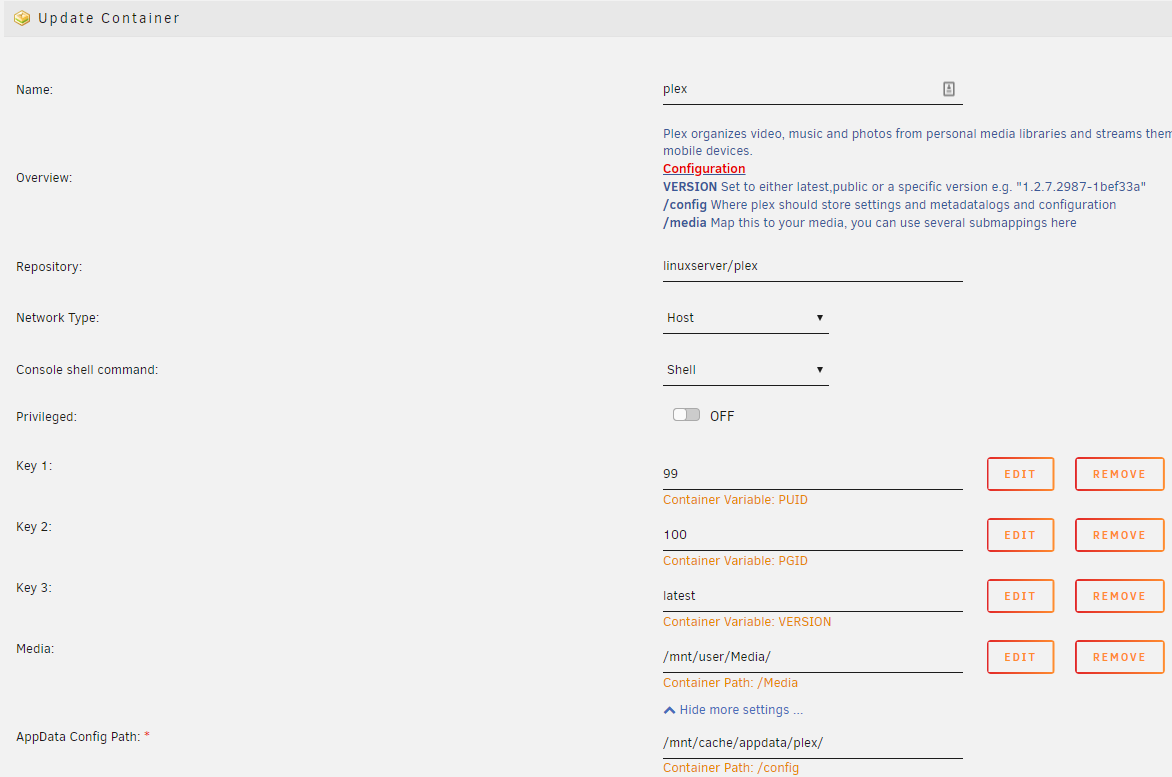

  1. Solution: Ended up deleting the library, as no backups occured for the last 6 months, so the database must have been somewhat corrupt for some time. Starting Plex Media Server - Loop All of a sudden, I experience the Plex docker not starting. It worked fine at Friday, but when the server started today, Plex no longer starts. Friday at midnight, the Plex container automatically updated using app; AutoUpdateApps. Using LinuxServer.io LetsEncrypt docker for ReverseProxy, if it is related. Which was also updated at Friday midnight. Anyone who has an idea for how to solve this? In the Plex Media Server log (\appdata\plex\Library\Application Support\Plex Media Server\Logs) It reports that the database image is corrupt. PRAGMA integrity_check outputs the following, and the 'Repair a corrupt database guide from Plex' unfortunately does not solve it. Instead, making an empty database when converting from the .SQL to .DB Configuration [s6-init] making user provided files available at /var/run/s6/etc...exited 0. [s6-init] ensuring user provided files have correct perms...exited 0. [fix-attrs.d] applying ownership & permissions fixes... [fix-attrs.d] done. [cont-init.d] executing container initialization scripts... [cont-init.d] 10-adduser: executing... ------------------------------------- _ () | | ___ _ __ | | / __| | | / \ | | \__ \ | | | () | |_| |___/ |_| \__/ Brought to you by linuxserver.io We gratefully accept donations at: https://www.linuxserver.io/donate/ ------------------------------------- GID/UID ------------------------------------- User uid: 99 User gid: 100 ------------------------------------- [cont-init.d] 10-adduser: exited 0. [cont-init.d] 30-dbus: executing... [cont-init.d] 30-dbus: exited 0. [cont-init.d] 40-chown-files: executing... [cont-init.d] 40-chown-files: exited 0. [cont-init.d] 50-plex-update: executing... No update required [cont-init.d] 50-plex-update: exited 0. [cont-init.d] done. [services.d] starting services Starting dbus-daemon Starting Plex Media Server. [services.d] done. Starting Avahi daemon Found user 'avahi' (UID 102) and group 'avahi' (GID 103). Successfully dropped root privileges. avahi-daemon 0.7 starting up. No service file found in /etc/avahi/services. *** WARNING: Detected another IPv4 mDNS stack running on this host. This makes mDNS unreliable and is thus not recommended. *** *** WARNING: Detected another IPv6 mDNS stack running on this host. This makes mDNS unreliable and is thus not recommended. *** Joining mDNS multicast group on interface vethfd8410a.IPv6 with address fe80::240d:a4ff:fec5:7105. New relevant interface vethfd8410a.IPv6 for mDNS. Joining mDNS multicast group on interface vethc602a55.IPv6 with address fe80::7c89:38ff:fec7:1d5b. New relevant interface vethc602a55.IPv6 for mDNS. Joining mDNS multicast group on interface veth26b4467.IPv6 with address fe80::b8f9:8eff:fe46:dc31. New relevant interface veth26b4467.IPv6 for mDNS. Joining mDNS multicast group on interface vethe9c235b.IPv6 with address fe80::1c51:14ff:fe9e:d29a. New relevant interface vethe9c235b.IPv6 for mDNS. Joining mDNS multicast group on interface virbr0.IPv4 with address 192.168.122.1. New relevant interface virbr0.IPv4 for mDNS. Joining mDNS multicast group on interface docker0.IPv6 with address fe80::42:8dff:fee1:edf7. New relevant interface docker0.IPv6 for mDNS. Joining mDNS multicast group on interface docker0.IPv4 with address 172.17.0.1. New relevant interface docker0.IPv4 for mDNS. Joining mDNS multicast group on interface br0.IPv6 with address fe80::f884:27ff:fe6f:ebc9. New relevant interface br0.IPv6 for mDNS. Joining mDNS multicast group on interface br0.IPv4 with address 192.168.1.14. New relevant interface br0.IPv4 for mDNS. Joining mDNS multicast group on interface bond0.IPv6 with address fe80::76d0:2bff:fe95:2bb8. New relevant interface bond0.IPv6 for mDNS. Joining mDNS multicast group on interface lo.IPv6 with address ::1. New relevant interface lo.IPv6 for mDNS. Joining mDNS multicast group on interface lo.IPv4 with address 127.0.0.1. New relevant interface lo.IPv4 for mDNS. Network interface enumeration completed. Registering new address record for fe80::240d:a4ff:fec5:7105 on vethfd8410a.*. Registering new address record for fe80::7c89:38ff:fec7:1d5b on vethc602a55.*. Registering new address record for fe80::b8f9:8eff:fe46:dc31 on veth26b4467.*. Registering new address record for fe80::1c51:14ff:fe9e:d29a on vethe9c235b.*. Registering new address record for 192.168.122.1 on virbr0.IPv4. Registering new address record for fe80::42:8dff:fee1:edf7 on docker0.*. Registering new address record for 172.17.0.1 on docker0.IPv4. Registering new address record for fe80::f884:27ff:fe6f:ebc9 on br0.*. Registering new address record for 192.168.1.14 on br0.IPv4. Registering new address record for fe80::76d0:2bff:fe95:2bb8 on bond0.*. Registering new address record for ::1 on lo.*. Registering new address record for 127.0.0.1 on lo.IPv4. Server startup complete. Host name is tower.local. Local service cookie is 1672898640. Starting Plex Media Server. Starting Plex Media Server. Starting Plex Media Server. Starting Plex Media Server. Starting Plex Media Server. Starting Plex Media Server.
