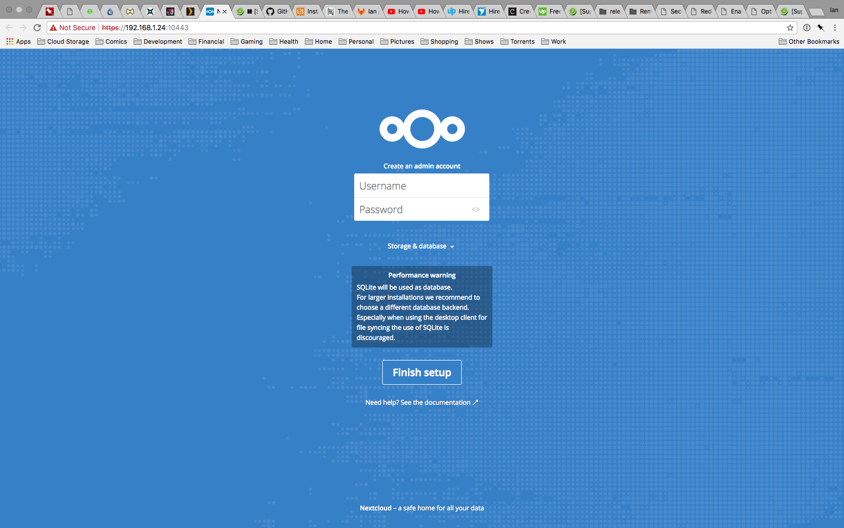

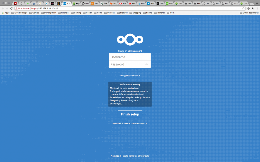

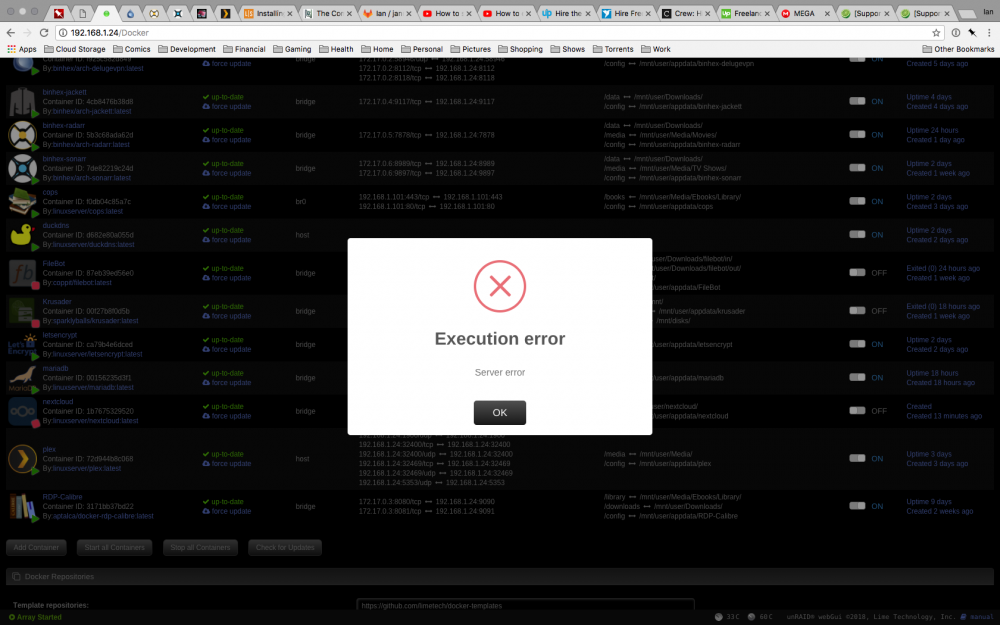

  6. So I looked at the docker start command, and saw that it was actually failing, saying 0.0.0.0:445 was in use. (I am not sure by what, a cursory search returned nothing.) I changed the port from 445 to 10443, and it spun up. Though it does not seem to be using the MariaDB container I setup per the directions here.

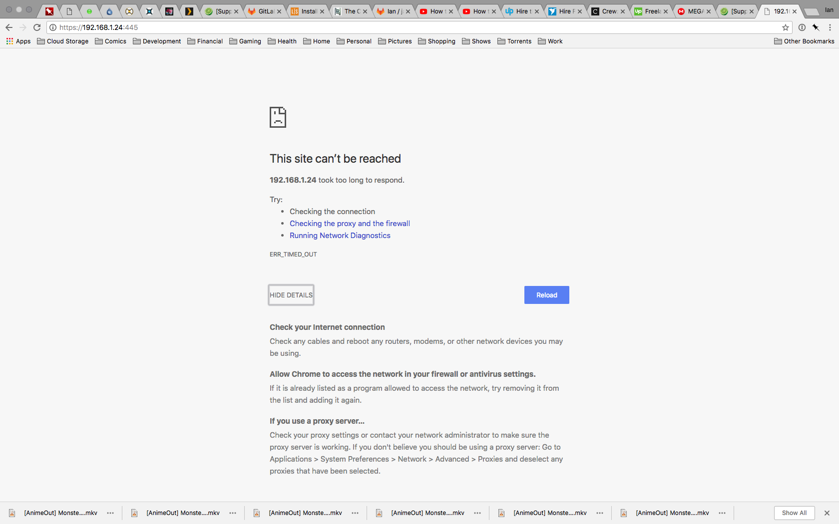

  10. So upon trying to connect to the above ip, I get nothing...

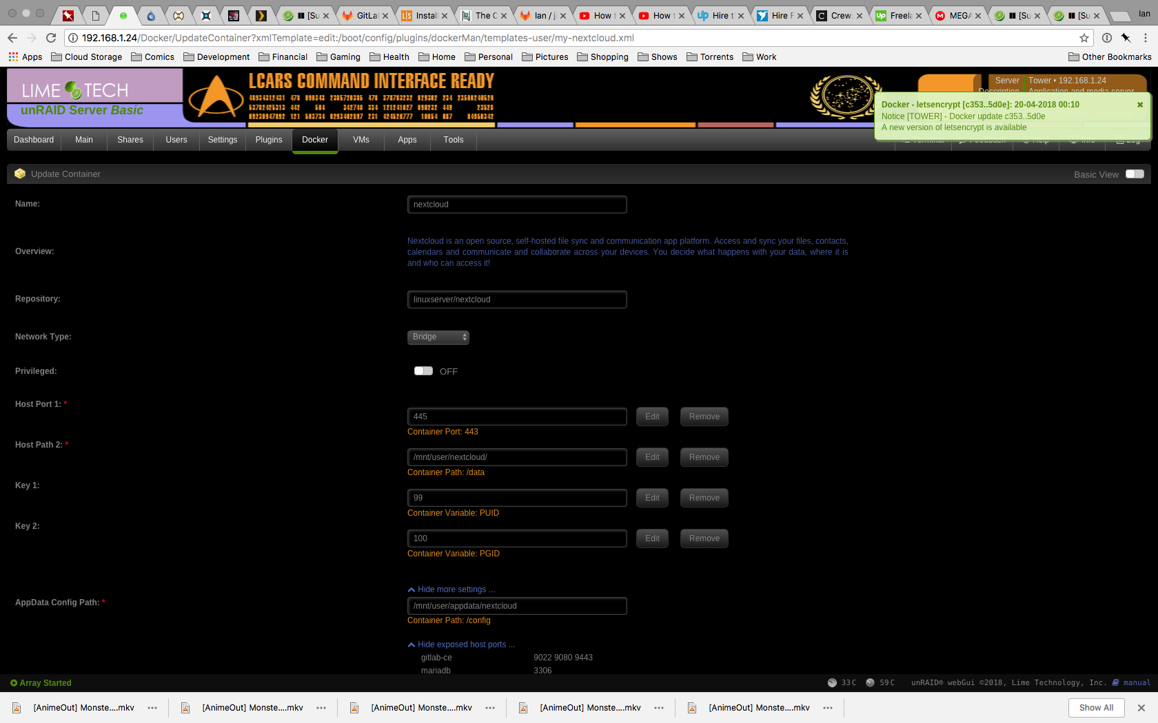

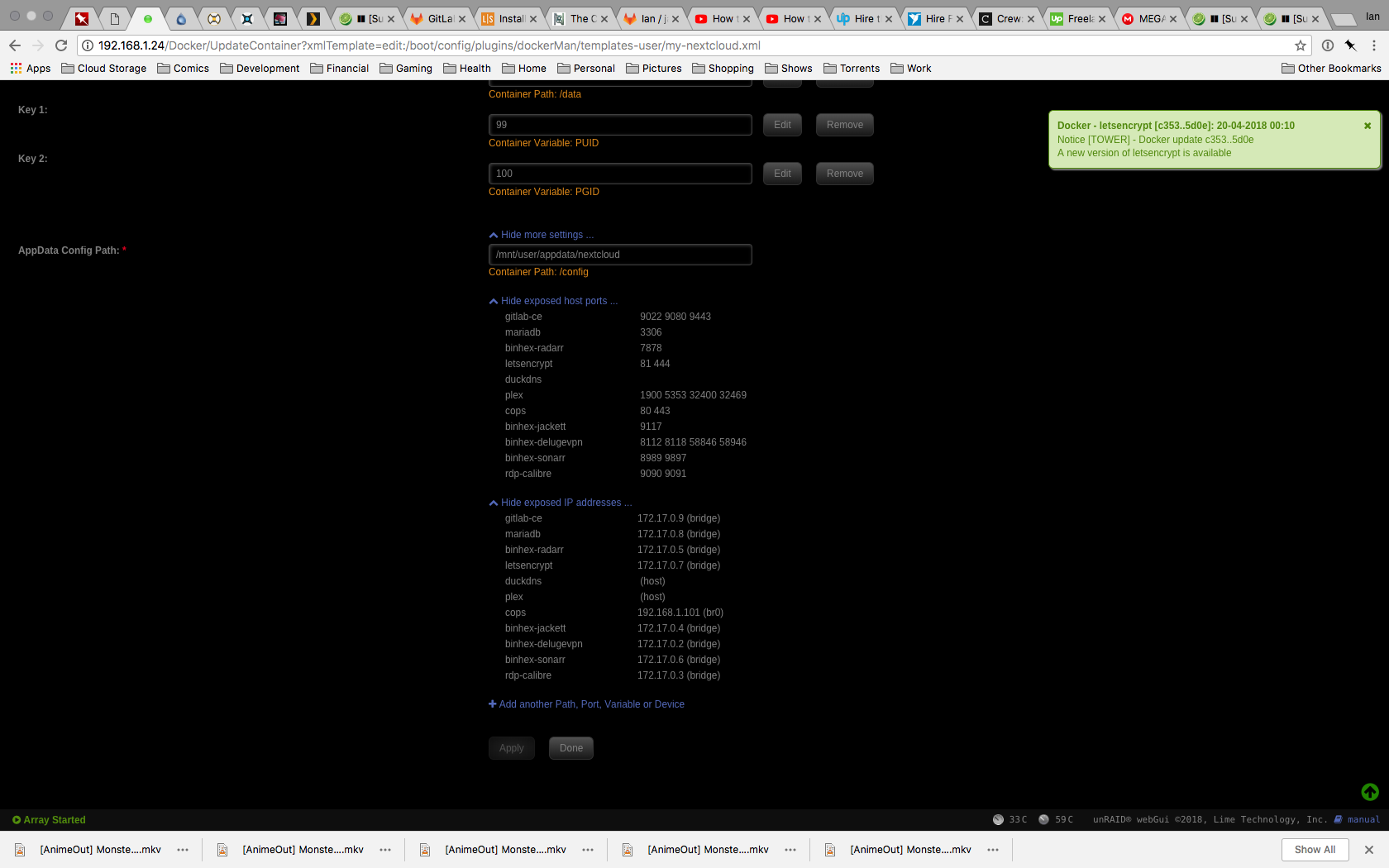

  11. So here is a the setup info for the NextCloud container... I have not specifically told unraid to be on port 445, but then I don't know how, so It is very possible I did it unknowingly.

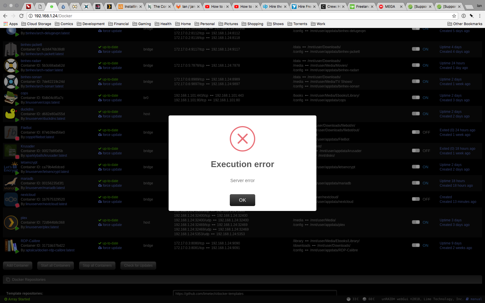

  12. Hello, I have been trying for 3 days to get this docker up and running. I installed and have working my letsencrypt container running, and configured. I think i have MariaDB set up correctly. (It's first database is for NextCloud, which is not working.) When I install the NextCloud container, I set the ssl port to 445, since 443, and 444 are taken already. I also map /data to /mnt/user/nectcloud, the share for my nextcloud stuff. But once the installation is finished, the docker does not start. When I try to manually start it, I get a generic error. (See screen shot.) https://imgur.com/a/hwAOSII I should mention that I followed this guide for the MariaDB setup. I am trying to use it for the NextCloud container setup as well. Any thoughts or suggestions would be nice!
