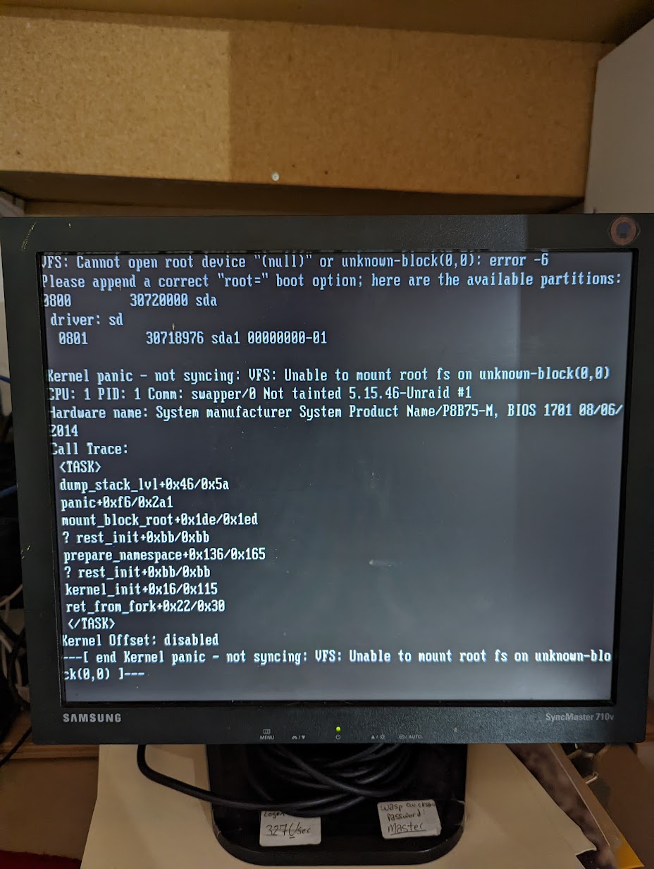

  7. I try with three differents usb sticks...
  8. Hi guys, When I try do boot my unraid with my configuration from the backup, i have this error. But, i don't have this error when i try to boot with new installation... Anyone have some ideas for fix the issue? Thanks you
