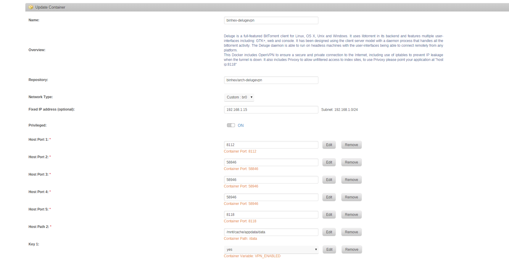

  4. is there a way to set a route in unraid to allow them to talk with each other
  5. I just changed back using a fixed IP as soon as I turn on the VPN it stops working. If I turn it back to a bridge it starts working fine. One side note when I have sonar on a fixed IP and I try and connect to the proxy it fails so I had to move it back to a bridge as well. Is there something messed up with my unraid docker network. I have checked all the logs and do not see any problems
  6. It was working until the last couple of week. I have set it back to bridge and it works. Will the option to move this to fixed IP be supported in the future

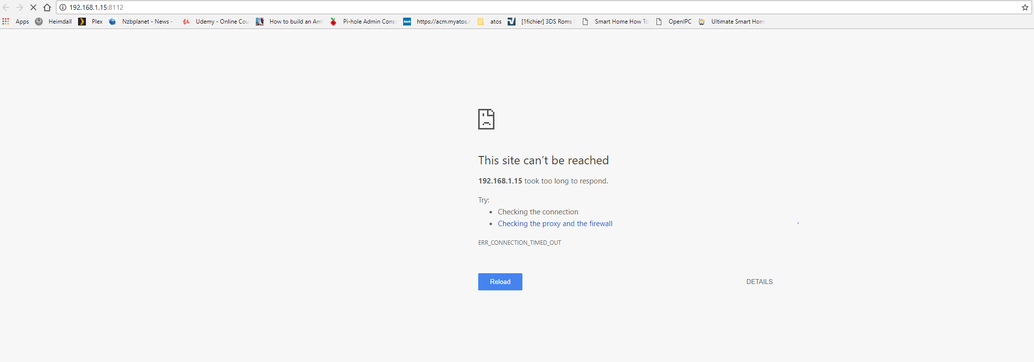

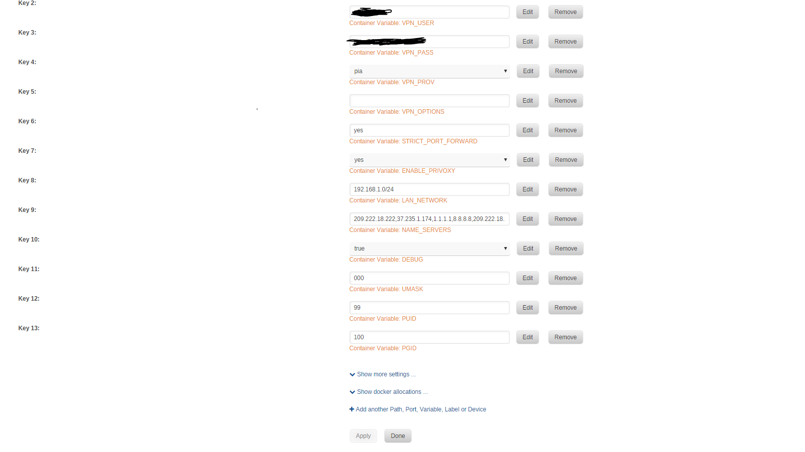

  7. Let me first say thank you for trying to help me with this problem. Your docker is truly one of the best things that have come along for a long time. I have attached all of the requested logs supervisord.log https://pastebin.com/PfcK974Q There is nothing wrong in that log, its showing a successful start, you can try the following:- Ensure you have any proxy settings turned off for your browser All browser on all machines have the proxy turned off Ensure you are connecting from inside your home LAN 2. All pc tested on are inside my network Ensure your lan_network value is correct - see here - Q3 for details 3. the LANis correctly set for network Default Gateway . . . . . . . . . : 192.168.1.1 DHCP Server . . . . . . . . . . . : 192.168.1.1 Try clearing down all cookies on your browser 4. cookies where clear no changes Try a different browser, IE, Firefox and Chrome. 5. I tired edge, chrome and firefox same problem Ensure the machine you are browsing from has any firewalls turned off 6. firewall was turn off no change still cound not reach the GUI Try connecting to the web ui from another machine 5. Tired it on 4 different PC the GUI still was unable to be seen
  8. I have tried everything I can thing read the faq 10 times checked the network and still no GUI at my wits ends as I love this docker https://pastebin.com/ZKSEzeqH supervisord.log ( hide my PIA account and password) what the heck I'm I missing
