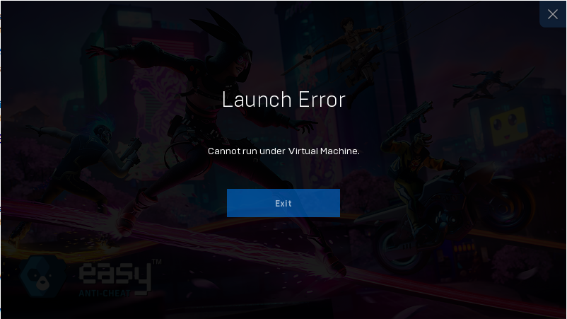

  2. Fortnite stopped using Battleye, so the xlm fix in this thread works with easy anti cheat. My kids played Roblox too, but I wasn't able to figure out how to get it working.

  11. Woke up to non-responsive dockers and VM's. I'm seeing a ton of cache pool disk errors. I have two mirrored nvme drives. I tried to copy a VM disk image to the array and the copy failed, so now I'm in a frustrated panic and not thinking clearly. I think I might have rebooted before I captured the first diagnostics. After rebooting I did recreate the docker.img since it was clearly corrupted, then rebuilt some dockers. Now I thinking even that was a bad idea. Really hoping we can save my cache drive data. Please assist. unraid-diagnostics-20231124-0533.zip unraid-diagnostics-20231124-0736.zip
  12. Thanks, with those changes I am able to play Fortnite again if EAC loads. Did not work for the new Roblox Hyperion anti-cheat. Finally got a great deal on some NVMe M.2 drives and upgraded my cache drives. Now I've got some space to build some testing VMs.
  13. Well, looks like Fortnite on VM is completely done now. Easy Anti-Cheat is now blocking Virtual Machines as well. My kids can no longer play Roblox either. This worked so well for so long, so frustrating. No way in hell I'm building gaming rigs for the whole family. The future is in VM's anyway, these companies are going to have to face that fact eventually. I've looked into virtual machine obfuscation a bit, and it's definitely not easy. If anyone comes across a good guide, please share.
  14. No solutions yet that I'm aware of. I've given up trying to workaround it. It's clearly above my pay grade. I'm still having luck playing when Easy Anti-Cheat loads. When when Battleye loads, it seems to be a minimum of 24 hours before EAC has a chance at loading again. If they keep it up, I might have to mow the lawn or something...
