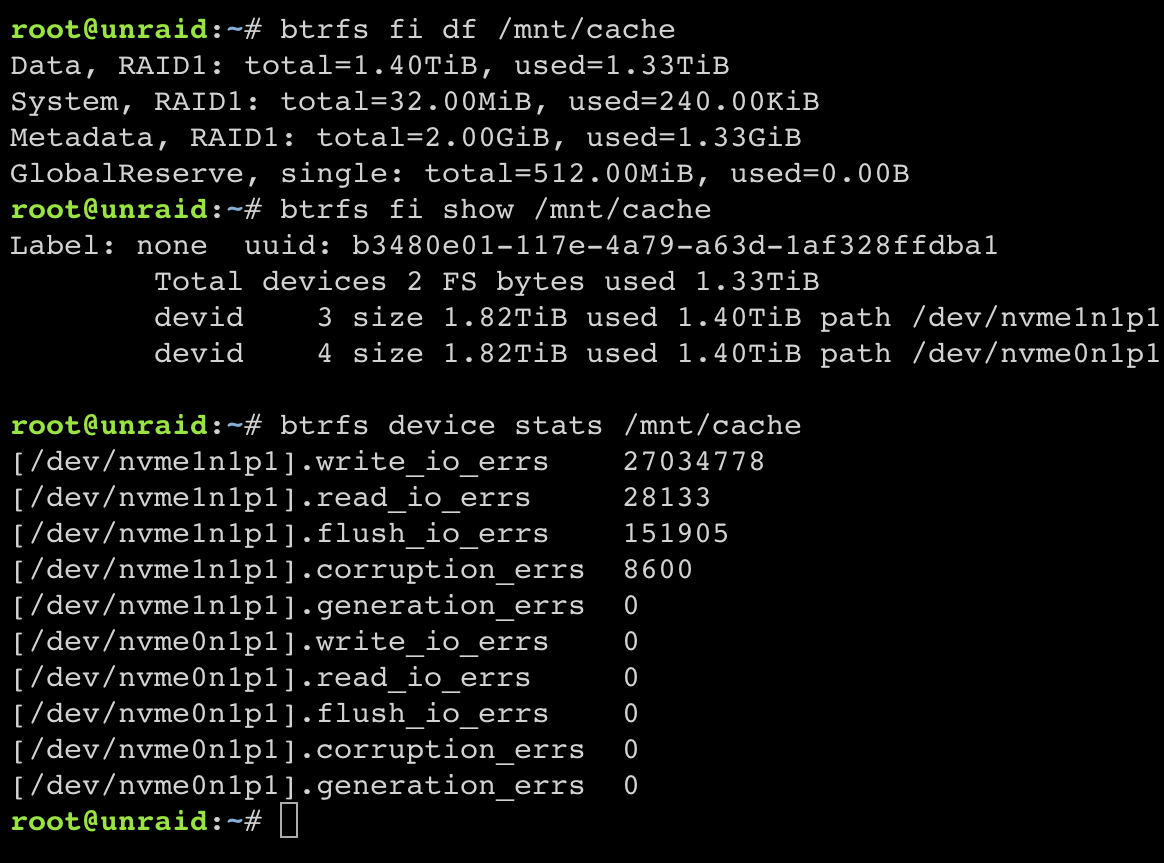

Woke up to non-responsive dockers and VM's. I'm seeing a ton of cache pool disk errors. I have two mirrored nvme drives. I tried to copy a VM disk image to the array and the copy failed, so now I'm in a frustrated panic and not thinking clearly. I think I might have rebooted before I captured the first diagnostics. After rebooting I did recreate the docker.img since it was clearly corrupted, then rebuilt some dockers. Now I thinking even that was a bad idea. Really hoping we can save my cache drive data. Please assist.

Does this mean I've got a bad drive, or is it some other BTRFS unhappiness?

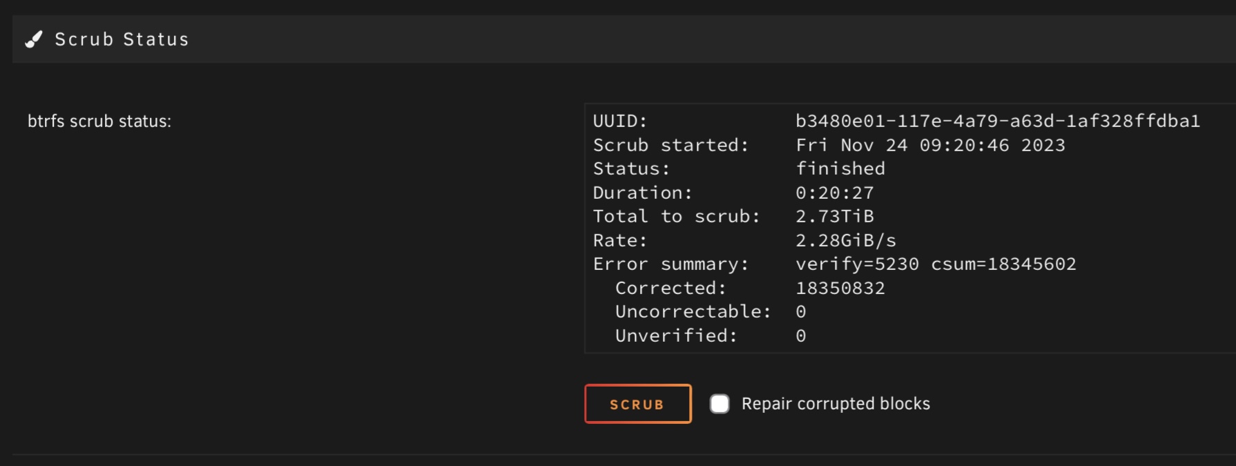

I deleted a large vm disk image I didn't care about, then ran a scrub which reported a ton of corrections. My VM disk images all seem to be corrupted. I was able to repair my critical VM enough that I can focus on it later.
Are there BTRFS options that may help save my VMs?

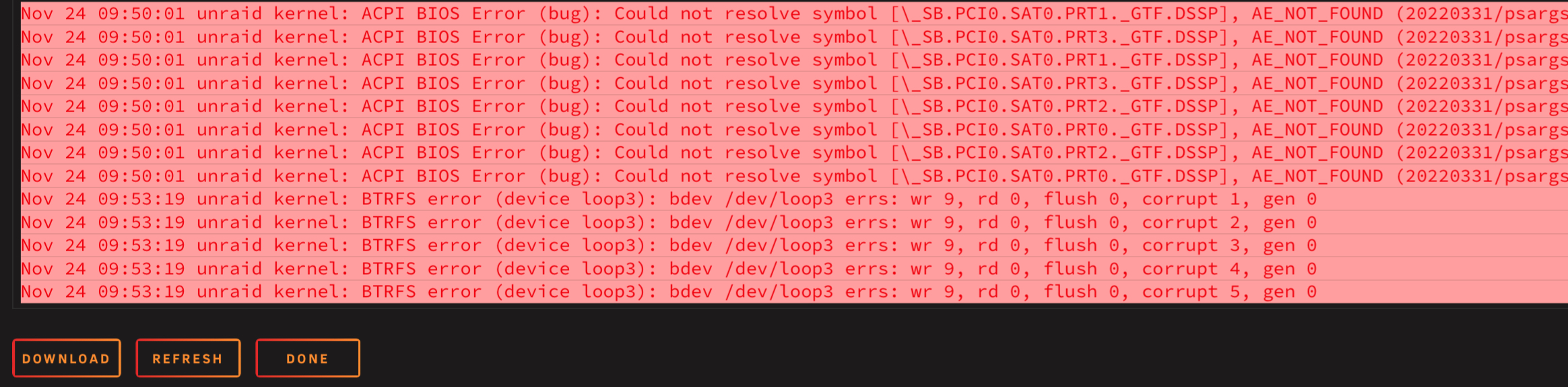

edit: and errors seemed to have stopped, except for the loop3 error, which I think occurred when I attempted to start a VM.

Those errors suggest on the NVMe devices dropped offline in that past, run a correcting scrub an post the results, also take a look here for better pool monitoring.

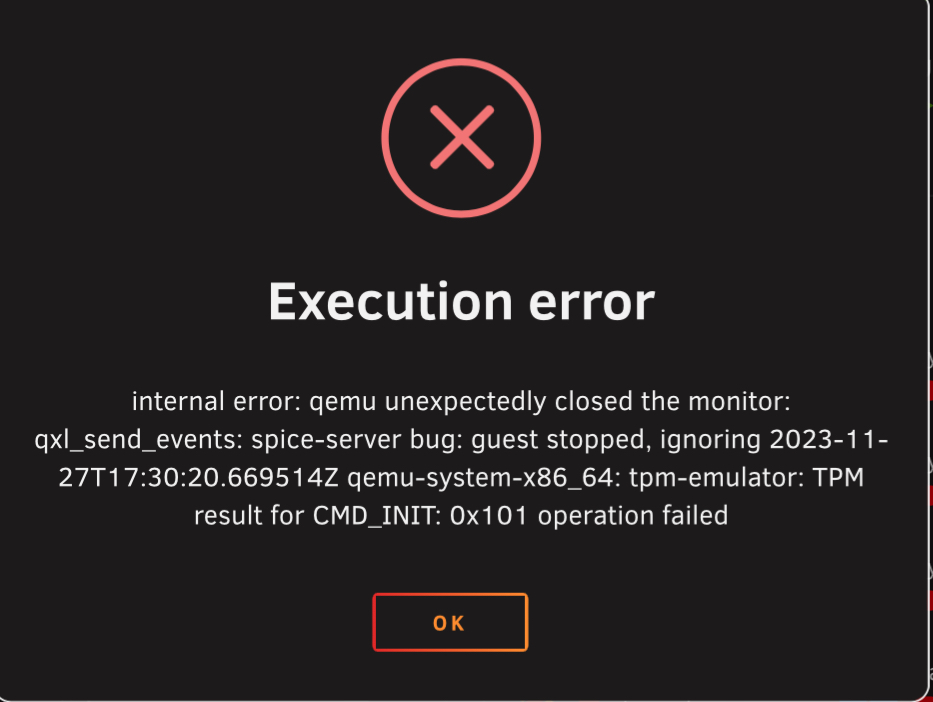

So when the original event occurred the cache pool had gone read only. After some reading here, even though the UI showed I had tons of free space, I deleted a large test VM I didn't care about and then ran a scrub. The scrub reported it made a bunch of corrections(posted above). The errors seemed to stop after that. Now I'm getting the loop3 errors when I try to start some of the VM's. GUI appears to be complaining about TPM.

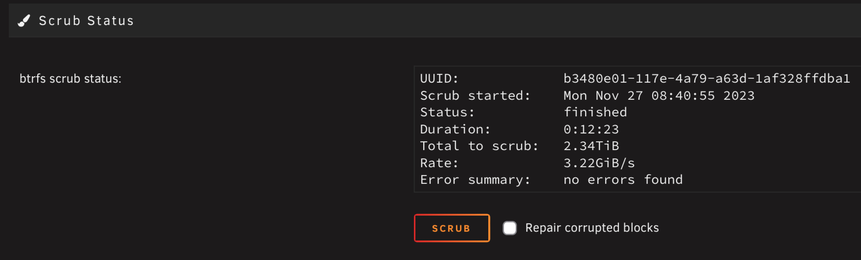

Anyway, I disabled Docker and VM and ran a scrub again which came back clean. Re-enabled Docker and VM. Tried to start a problem VM and still get an error.
unraid-diagnostics-20231127-0932.zip
Libvirt.img is corrupt, restore form a  backup if available.
