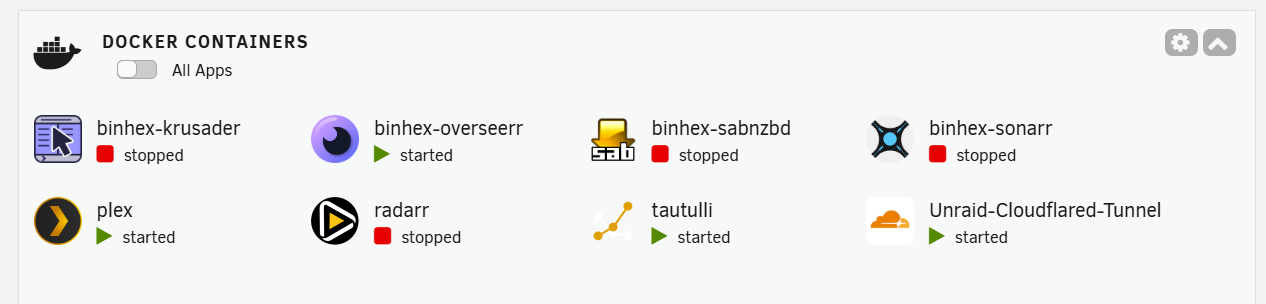

  2. Thanks for your reply cat /etc/resolve.conf gave me this: root@Tower:~# cat /etc/resolv.conf # Generated by dhcpcd from br0.dhcp domain localdomain nameserver 10.10.100.1 In photos you can see which dockers work and which dont. And also the error message when I try to start the ones that dont work
  3. Docker is now working, but not fully some dockers work, some don't Everything is very strange new diagnostic here tower-diagnostics-20250205-2338.zip

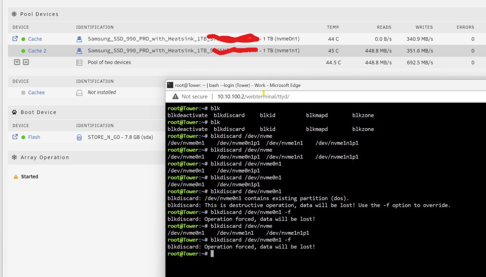

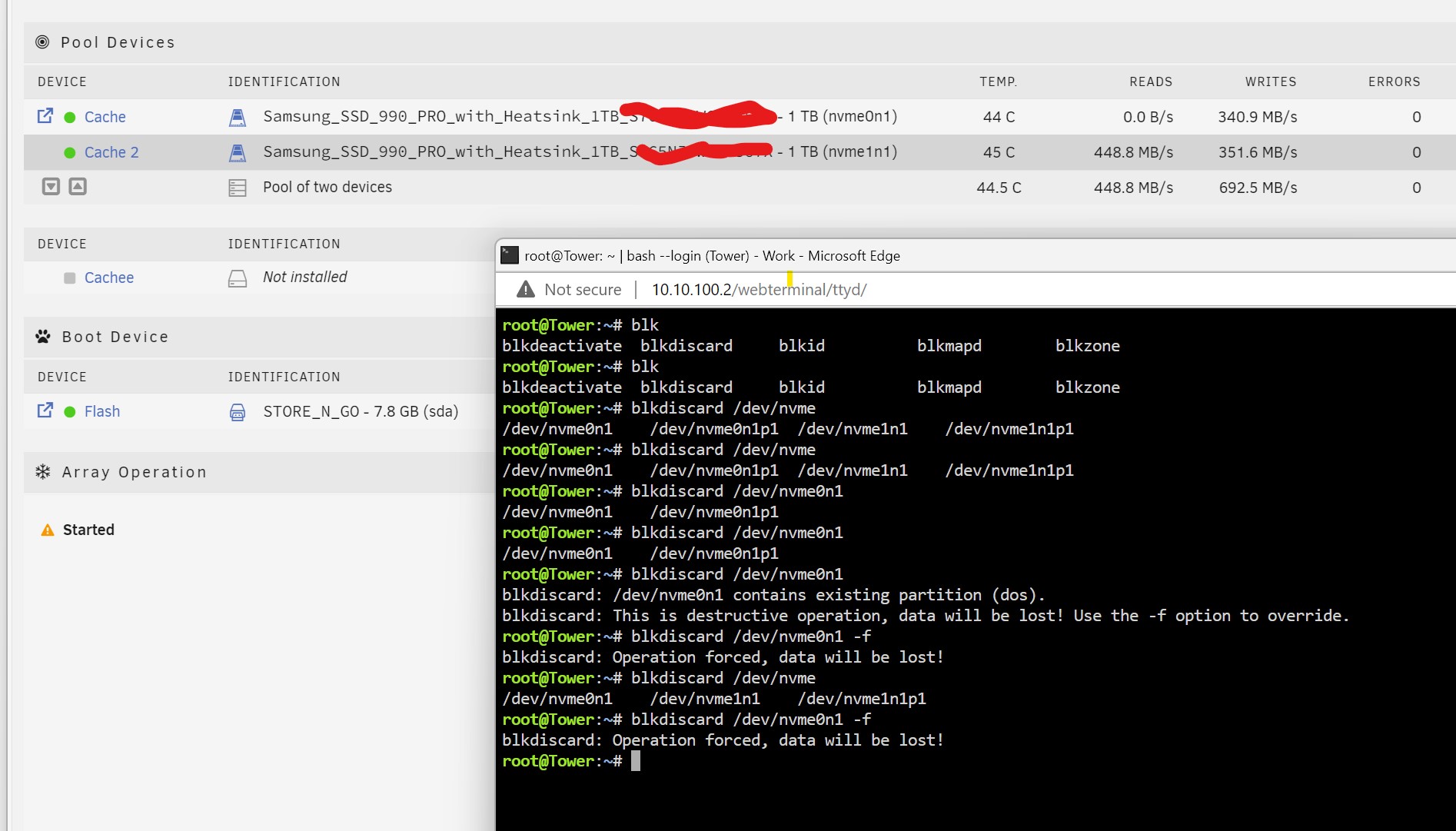

  7. I got kind of depressed, google something Though I should delete everything from both of my cache drives and then restore it with appdata backup Did those commands shown on screenshot Dockers started to work And hevy read/write on my cahce drive I have literally know idea what it happening
  8. I think I have to format and start from scratch on my cahce drives root@Tower:~# btrfs dev stats /mnt/cache [/dev/nvme0n1p1].write_io_errs 296591154 [/dev/nvme0n1p1].read_io_errs 454910 [/dev/nvme0n1p1].flush_io_errs 1525783 [/dev/nvme0n1p1].corruption_errs 16434475 [/dev/nvme0n1p1].generation_errs 13247 [/dev/nvme1n1p1].write_io_errs 0 [/dev/nvme1n1p1].read_io_errs 0 [/dev/nvme1n1p1].flush_io_errs 0 [/dev/nvme1n1p1].corruption_errs 0 [/dev/nvme1n1p1].generation_errs 0

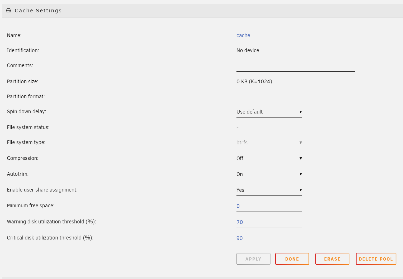

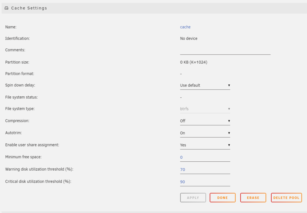

  13. Thanks for your help Should I just click "delete pool". And then I can start the array up again
  14. Well that does sound good, I can't imagine that something crucial was on it So what should I do now. That is, how do I start my array without it correctly Thank you
