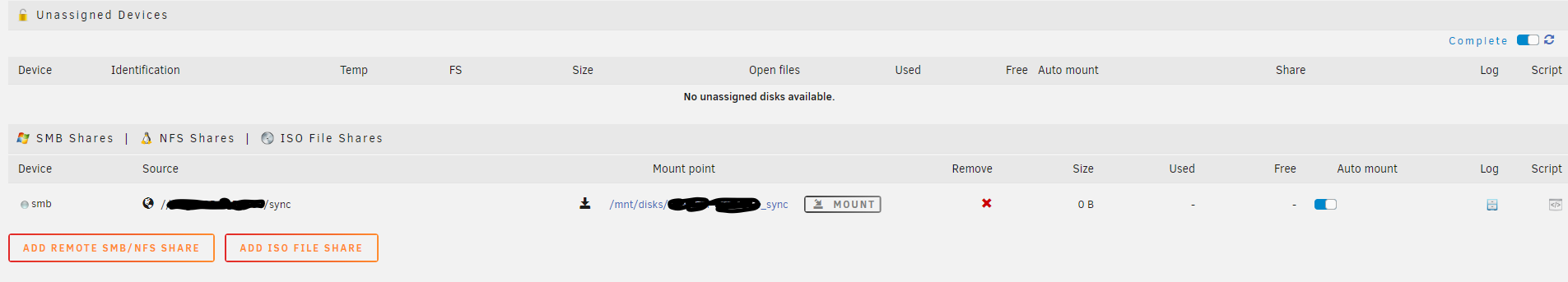

  6. Yes, I know, which I why I chose SMB in the drop down when I tried to mount the drive. So, is SMB broken in UD right now? EDIT: got it to work. Unraid or UD didn't like using the hostname, so I tried using the IP address. That got it to mount. Should've tried that earlier.
  7. But it isn't. I can mount it as a network drive on other Windows machines on my network.
