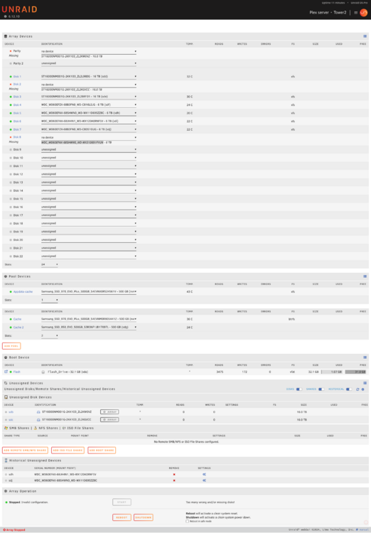

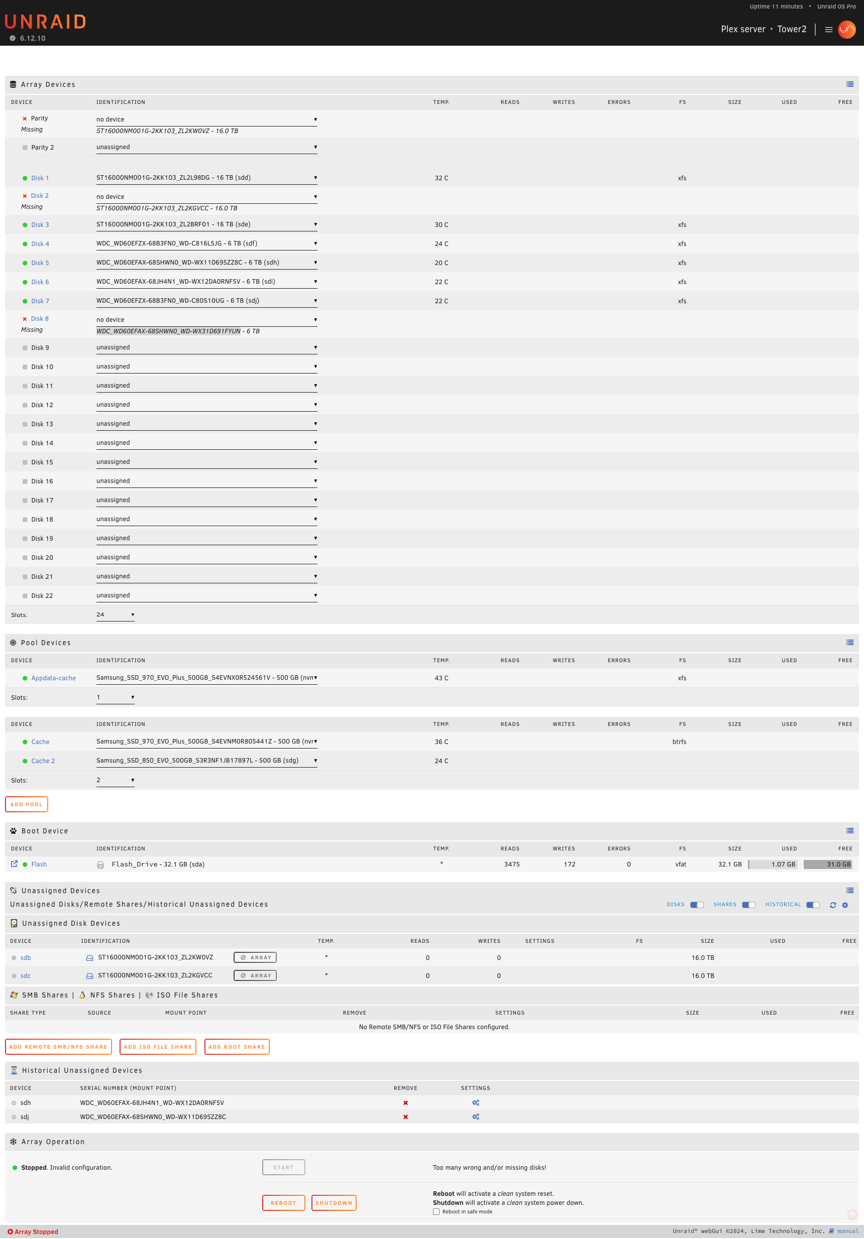

ok, *think* I might be getting closer to figuring it out. I wasnt getting one of the drives show up in the BIOS - have unplugged this drive and now the BIOS and Unraid are booting through much quicker (before when that drive was plugged in I was getting lots of clicking sounds etc and it took a while to get to the BIOS setup screen and to load Unraid. So I am guessing that the drive is fault and I will need to replace which is fine. Now though, when I get into Unraid there are still 3 devices showing as missing (2x 16TB HDs - parity & disk2 and 1x 6TB HD - disk8 - the suspected faulty one). Parity and disk 2 drives are showing in the Unassigned Disk Devices section with a grey box with Array written in it. I'm unable to reselect these devices to assign them to the correct locations (Parity, Disk2). I haven't changed the order of Sata slots when investigating this, so not sure why this is. Attaching a screenshot of the GUI for reference

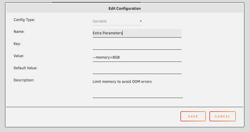

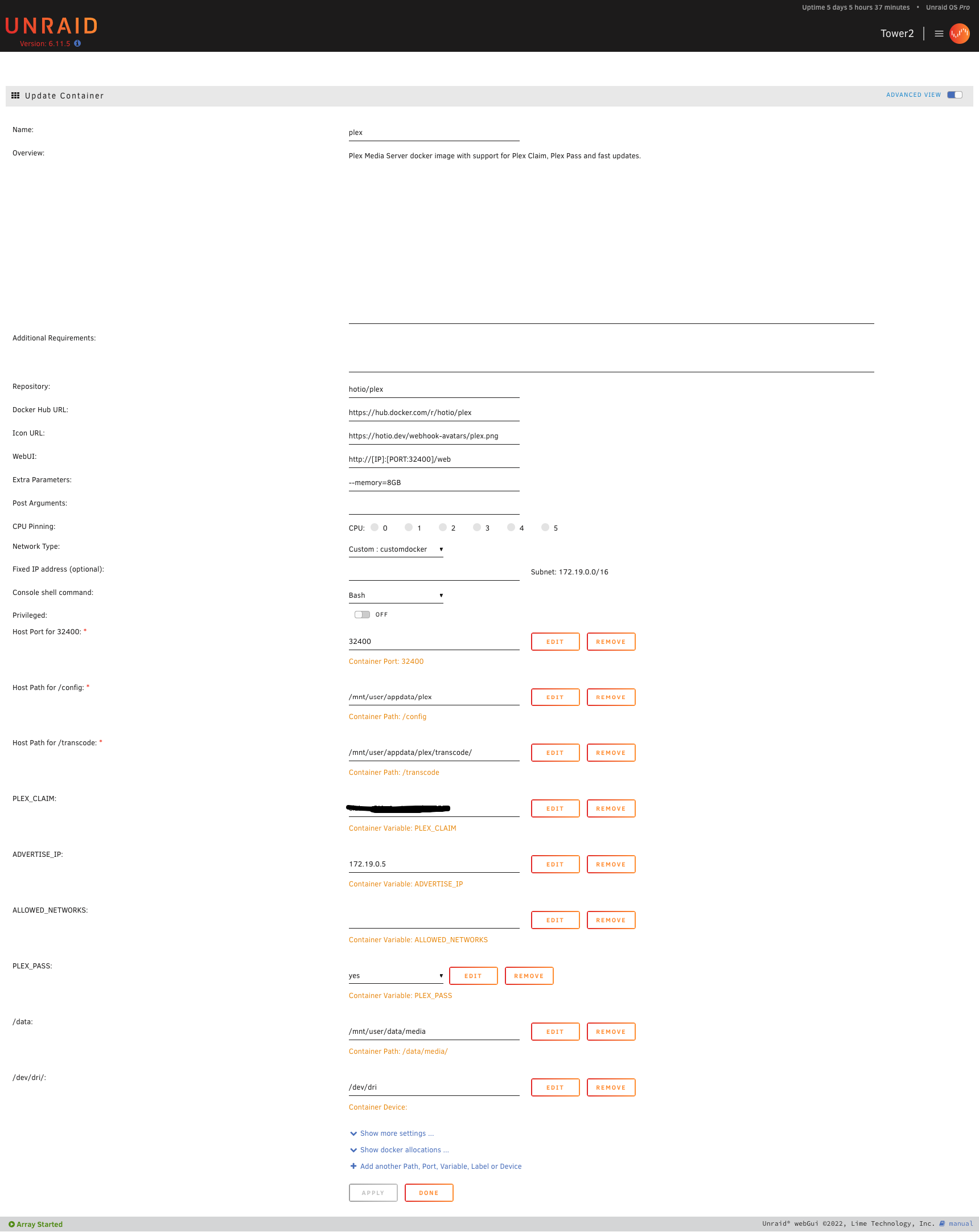

I do not see the Extra Parameters field in my docker - I notice that you are using binhex - I am using Hotio docker. There is a field titled additional requirements??- Out of Memory Errors all of a sudden - shutting down Plex and requiring restart of Plex docker
after adding the extra paramater to the docker container yesterday I had the same issue this morning with the OOM error (see attached diagnostics and screenshot of the extra parameter settings tower2-diagnostics-20231129-1225.zip- Out of Memory Errors all of a sudden - shutting down Plex and requiring restart of Plex docker
