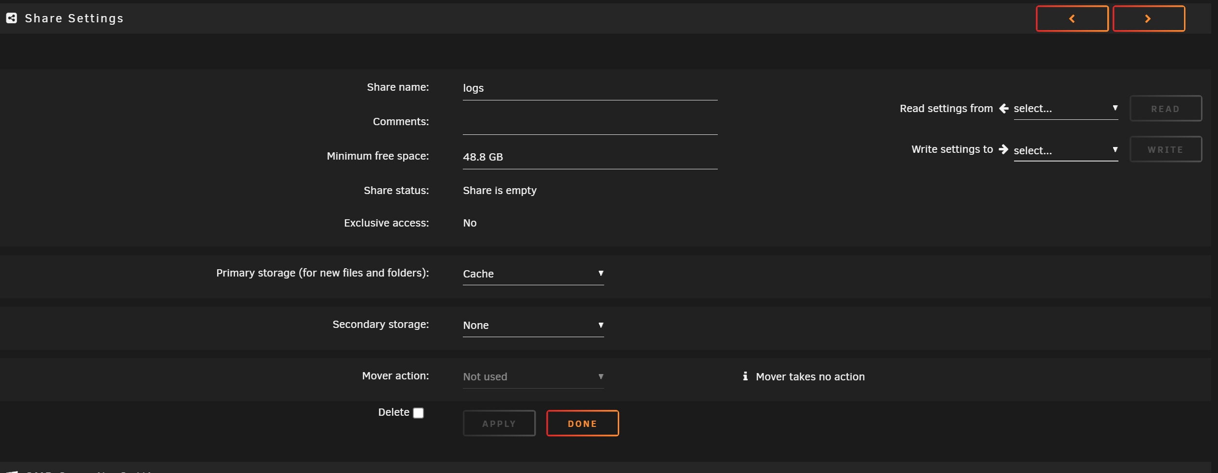

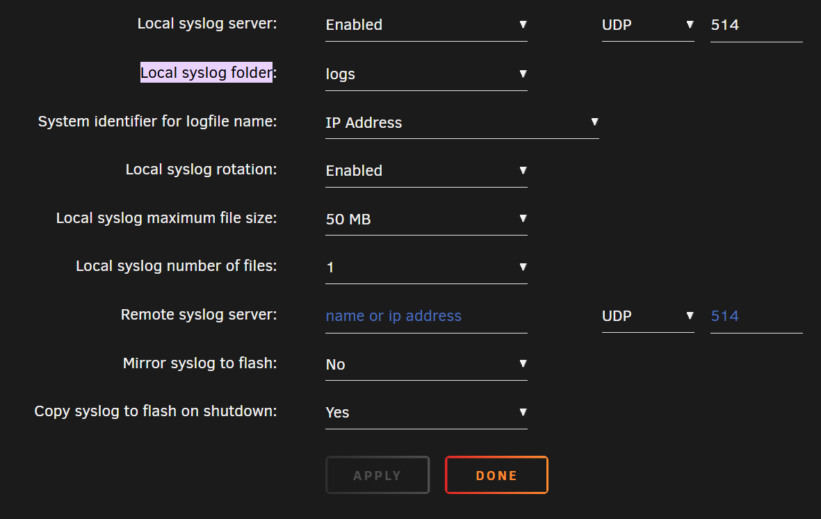

  3. Hello, ive had an issue with random crashes on my server lately. The server stays powered on but is unresponsive and cannot be accessed through GUI or SSH and I run headless so cant look at the console (uptime varies from 24 hours to 2 weeks or more). To try and diagnose this I tried to setup the syslog server hoping that when it crashed i could look at the logs to see what the cause is. the server crashed earlier today but when i went to check the logs from the syslog server there was nothing in the share i set up on the cache for the logs. So the first step for me diagnosing this is making sure the syslog server works. Ive attached a screen shot of the syslog settings can anybody please have a look and tell me if i have it setup correctly. Ive also attached a picture of the config of the logs share i created for this purpose. I was patiently waiting for the server to crash so i could check the logs so was very dissapointed when i couldnt 😞

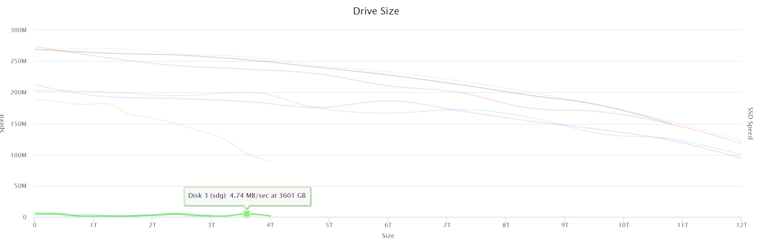

  5. thanks for the reply Ive attached the new diagnostics but I think I may discovered the drive that is causing the issues. I ran disk speed and disk 3 had an average speed of around 5MBps avg across the test. Im not entirely sure what this means though, if the drive was failing wouldn't I have been getting errors from it? where should I go from here? tower-diagnostics-20250305-0146.zip
