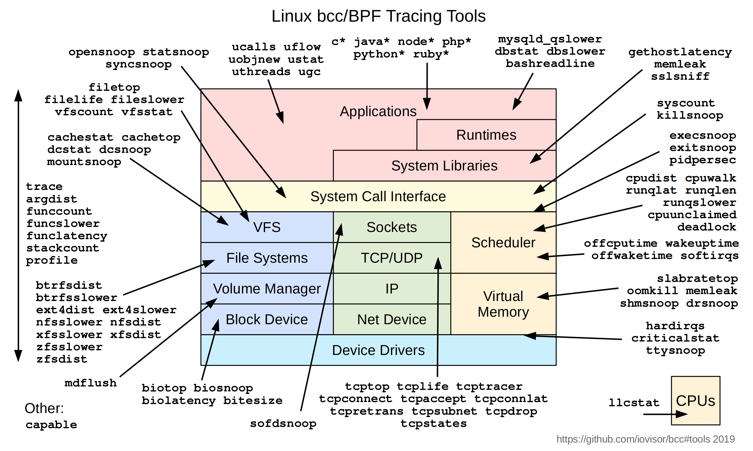

  8. Mover disabled for me but I just posted my details in reply to
