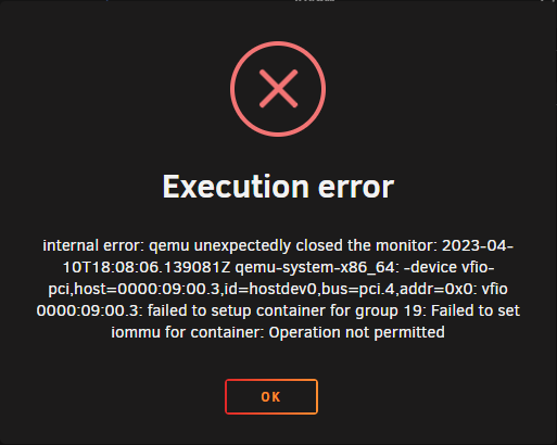

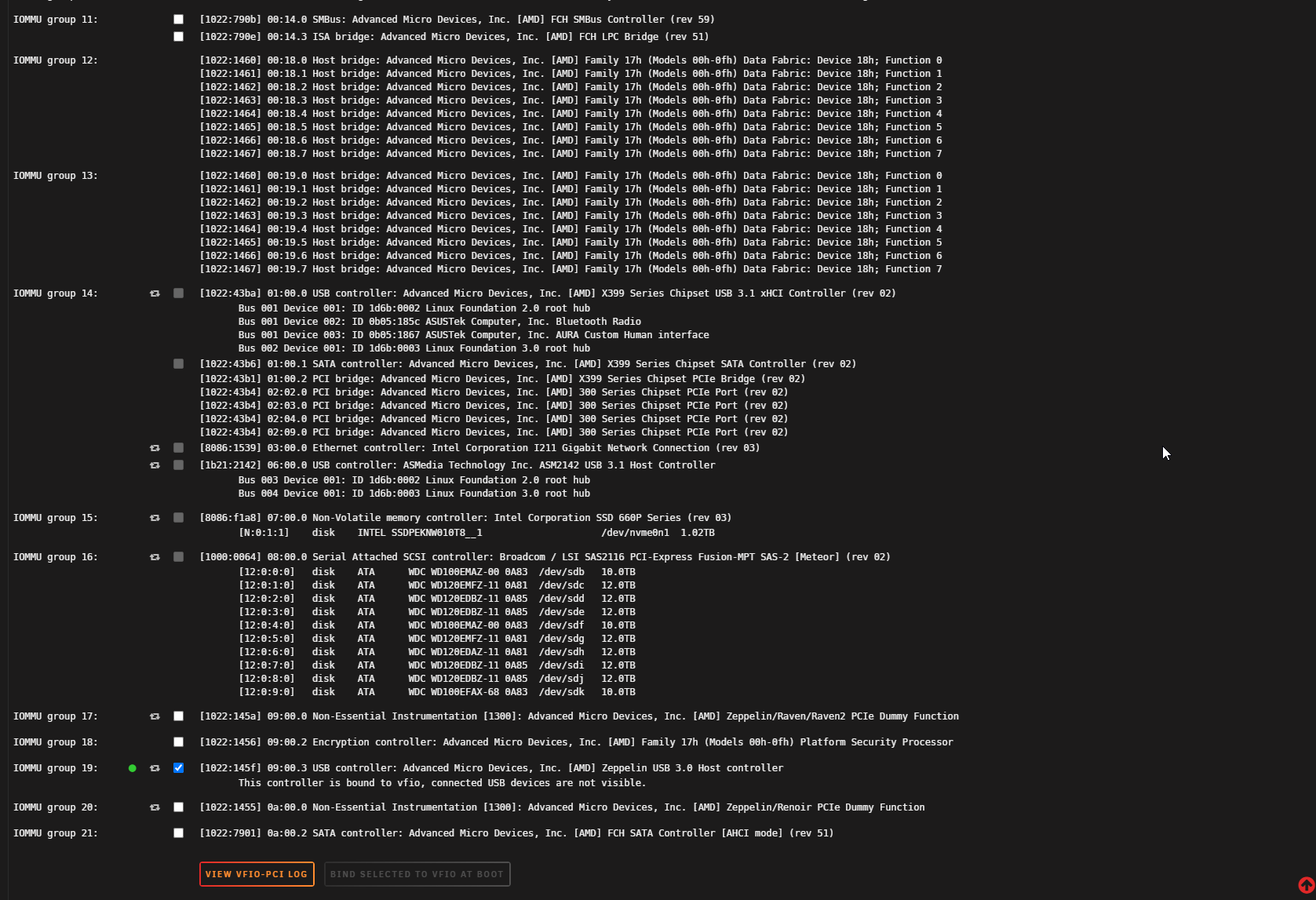

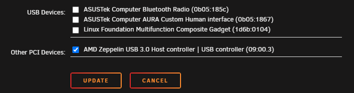

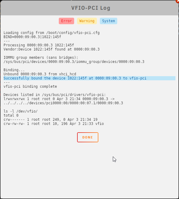

I have a Home Assistant VM that I am trying to pass a USB controller to. I have to pass the whole controller because I have a Coral AI accelerator which changes device ids when it's initiated, so I can't pass just the device. I have the controller bound in System Tools: When I view the VFIO-PCI Log it says it was successfully bound: When I try to attach it to the VM and start I get the error Execution error internal error: qemu unexpectedly closed the monitor: 2023-04-10T18:08:06.139081Z qemu-system-x86_64: -device vfio-pci,host=0000:09:00.3,id=hostdev0,bus=pci.4,addr=0x0: vfio 0000:09:00.3: failed to setup container for group 19: Failed to set iommu for container: Operation not permitted Diagnostics file attached. Thanks in advance. storage-diagnostics-20230410-1359.zip
