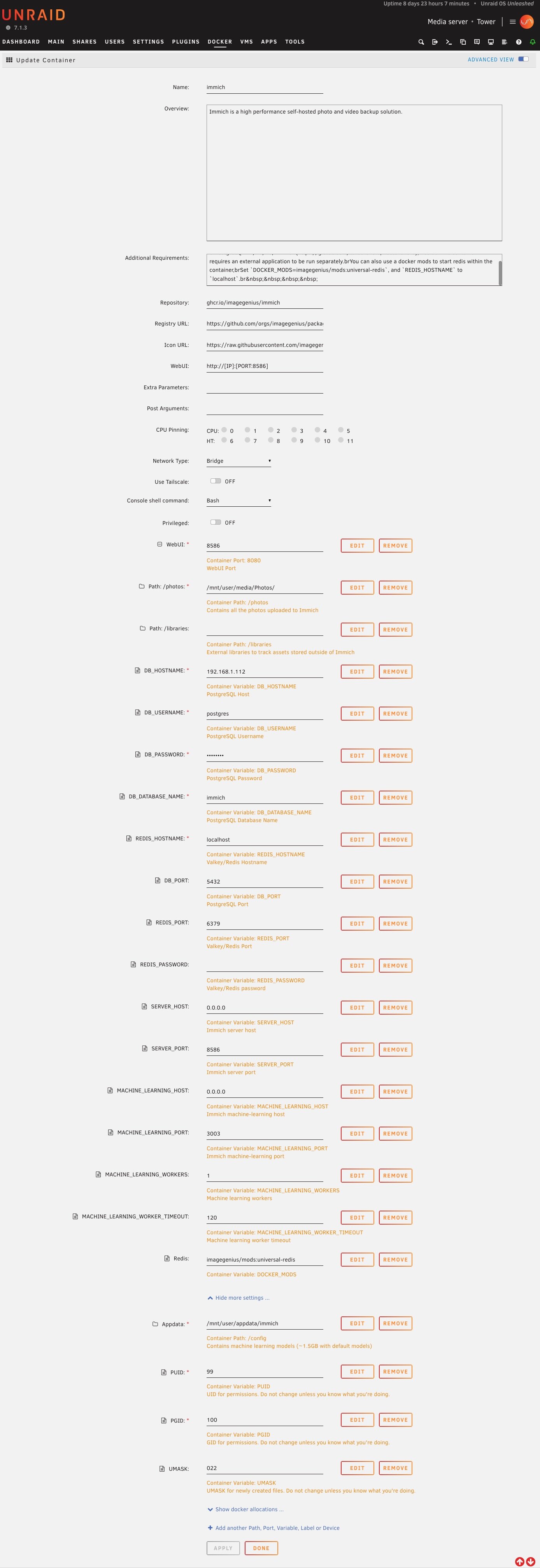

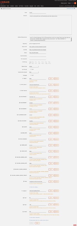

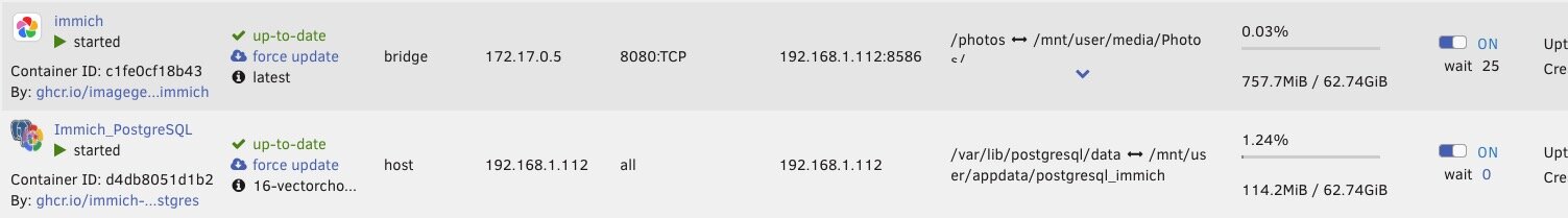

  8. I'll check these posts and read. For what it's worth: I did run through the settings once more noticed the server was at this weird not 8080 port => changed it to 8080, saved immich restarted, and yes!! now I can connect 😃😅 Thank you! Thank you! Thank you!Please do keep an eye on this thread, or my postings. I will first try to continue Immich setup. I'd then like to get things set up so that I can access the server from the outside network. We do have a slow upload speed, so I know it's not going to be fast. I have also been thinking of another scenario, but I do not know if that is possible: I have an external virtual linux machine hosted, it might be a possibility to set up Immich on that one (not unraid, but linux) and maybe there's ways to sync two Immich instances? (b.t.w. what timezone are you in? (I'm from Belgium))
  9. I've first corrected the 8080 port then checked the other settings - seems they are identical And here's the log [mod-init] Running Docker Modification Logic [mod-init] Adding imagegenius/mods:universal-redis to container [mod-init] Downloading imagegenius/mods:universal-redis from registry-1.docker.io [mod-init] Installing imagegenius/mods:universal-redis [mod-init] imagegenius/mods:universal-redis applied to container [migrations] started [migrations] no migrations found ╔═══════════════════════════════╗ __ _____ _____ __ / / |_ _/ ____| / / / / | || | __ / / / / | || | |_ | / / / / _| || |__| | / / /_/ |_____\_____| /_/ Baseimage from linuxserver.io ╠═══════════════════════════════╣ User/Group ID: User UID: 99 User GID: 100 ╚═══════════════════════════════╝ **** Adding redis to package install list **** [pkg-install-init] **** Installing all mod packages **** Get:1 http://archive.ubuntu.com/ubuntu noble InRelease [256 kB] Get:2 https://ppa.launchpadcontent.net/deadsnakes/ppa/ubuntu noble InRelease [17.8 kB] Get:3 https://apt.postgresql.org/pub/repos/apt noble-pgdg InRelease [129 kB] Get:4 https://ppa.launchpadcontent.net/deadsnakes/ppa/ubuntu noble/main amd64 Packages [34.2 kB] Get:5 https://apt.postgresql.org/pub/repos/apt noble-pgdg/main amd64 Packages [536 kB] Get:6 http://archive.ubuntu.com/ubuntu noble-updates InRelease [126 kB] Get:7 http://archive.ubuntu.com/ubuntu noble-security InRelease [126 kB] Get:8 http://archive.ubuntu.com/ubuntu noble/universe Sources [24.3 MB] Get:9 http://archive.ubuntu.com/ubuntu noble/main Sources [1,713 kB] Get:10 http://archive.ubuntu.com/ubuntu noble/restricted Sources [21.8 kB] Get:11 http://archive.ubuntu.com/ubuntu noble/multiverse Sources [355 kB] Get:12 http://archive.ubuntu.com/ubuntu noble/multiverse amd64 Packages [331 kB] Get:13 http://archive.ubuntu.com/ubuntu noble/main amd64 Packages [1,808 kB] Get:14 http://archive.ubuntu.com/ubuntu noble/universe amd64 Packages [19.3 MB] Get:15 http://archive.ubuntu.com/ubuntu noble/restricted amd64 Packages [117 kB] Get:16 http://archive.ubuntu.com/ubuntu noble-updates/universe Sources [550 kB] Get:17 http://archive.ubuntu.com/ubuntu noble-updates/restricted Sources [52.1 kB] Get:18 http://archive.ubuntu.com/ubuntu noble-updates/main Sources [531 kB] Get:19 http://archive.ubuntu.com/ubuntu noble-updates/multiverse Sources [17.3 kB] Get:20 http://archive.ubuntu.com/ubuntu noble-updates/restricted amd64 Packages [1,617 kB] Get:21 http://archive.ubuntu.com/ubuntu noble-updates/main amd64 Packages [1,481 kB] Get:22 http://archive.ubuntu.com/ubuntu noble-updates/universe amd64 Packages [1,417 kB] Get:23 http://archive.ubuntu.com/ubuntu noble-updates/multiverse amd64 Packages [27.1 kB] Get:24 http://archive.ubuntu.com/ubuntu noble-security/main Sources [236 kB] Get:25 http://archive.ubuntu.com/ubuntu noble-security/multiverse Sources [10.6 kB] Get:26 http://archive.ubuntu.com/ubuntu noble-security/restricted Sources [48.1 kB] Get:27 http://archive.ubuntu.com/ubuntu noble-security/universe Sources [391 kB] Get:28 http://archive.ubuntu.com/ubuntu noble-security/universe amd64 Packages [1,110 kB] Get:29 http://archive.ubuntu.com/ubuntu noble-security/multiverse amd64 Packages [22.1 kB] Get:30 http://archive.ubuntu.com/ubuntu noble-security/restricted amd64 Packages [1,566 kB] Get:31 http://archive.ubuntu.com/ubuntu noble-security/main amd64 Packages [1,159 kB] Fetched 59.4 MB in 4s (15.5 MB/s) Reading package lists... Reading package lists... Building dependency tree... Reading state information... The following additional packages will be installed: libatomic1 libjemalloc2 liblzf1 redis-tools Suggested packages: ruby-redis The following NEW packages will be installed: libatomic1 libjemalloc2 liblzf1 redis-server redis-tools 0 upgraded, 5 newly installed, 0 to remove and 21 not upgraded. Need to get 1,492 kB of archives. After this operation, 7,608 kB of additional disk space will be used. Get:1 http://archive.ubuntu.com/ubuntu noble-updates/main amd64 libatomic1 amd64 14.2.0-4ubuntu2~24.04 [10.5 kB] Get:2 http://archive.ubuntu.com/ubuntu noble/universe amd64 libjemalloc2 amd64 5.3.0-2build1 [256 kB] Get:3 http://archive.ubuntu.com/ubuntu noble/universe amd64 liblzf1 amd64 3.6-4 [7,624 B] Get:4 http://archive.ubuntu.com/ubuntu noble-updates/universe amd64 redis-tools amd64 5:7.0.15-1ubuntu0.24.04.1 [1,166 kB] Get:5 http://archive.ubuntu.com/ubuntu noble-updates/universe amd64 redis-server amd64 5:7.0.15-1ubuntu0.24.04.1 [51.7 kB] Fetched 1,492 kB in 0s (4,160 kB/s) Selecting previously unselected package libatomic1:amd64. (Reading database ... 19371 files and directories currently installed.) Preparing to unpack .../libatomic1_14.2.0-4ubuntu2~24.04_amd64.deb ... Unpacking libatomic1:amd64 (14.2.0-4ubuntu2~24.04) ... Selecting previously unselected package libjemalloc2:amd64. Preparing to unpack .../libjemalloc2_5.3.0-2build1_amd64.deb ... Unpacking libjemalloc2:amd64 (5.3.0-2build1) ... Selecting previously unselected package liblzf1:amd64. Preparing to unpack .../liblzf1_3.6-4_amd64.deb ... Unpacking liblzf1:amd64 (3.6-4) ... Selecting previously unselected package redis-tools. Preparing to unpack .../redis-tools_5%3a7.0.15-1ubuntu0.24.04.1_amd64.deb ... Unpacking redis-tools (5:7.0.15-1ubuntu0.24.04.1) ... Selecting previously unselected package redis-server. Preparing to unpack .../redis-server_5%3a7.0.15-1ubuntu0.24.04.1_amd64.deb ... Unpacking redis-server (5:7.0.15-1ubuntu0.24.04.1) ... Setting up libjemalloc2:amd64 (5.3.0-2build1) ... Setting up liblzf1:amd64 (3.6-4) ... Setting up libatomic1:amd64 (14.2.0-4ubuntu2~24.04) ... Setting up redis-tools (5:7.0.15-1ubuntu0.24.04.1) ... Setting up redis-server (5:7.0.15-1ubuntu0.24.04.1) ... invoke-rc.d: could not determine current runlevel invoke-rc.d: policy-rc.d denied execution of start. Processing triggers for libc-bin (2.39-0ubuntu8.4) ... [custom-init] No custom files found, skipping... Starting api worker [Nest] 676 - 06/29/2025, 7:39:10 PM LOG [Api:EventRepository] Initialized websocket server [Nest] 676 - 06/29/2025, 7:39:10 PM LOG [Api:DatabaseRepository] targetLists=1, current=1 for clip_index of 0 rows [Nest] 676 - 06/29/2025, 7:39:10 PM LOG [Api:DatabaseRepository] targetLists=1, current=1 for face_index of 0 rows [Nest] 676 - 06/29/2025, 7:39:10 PM LOG [Api:DatabaseRepository] Running migrations, this may take a while [Nest] 676 - 06/29/2025, 7:39:10 PM LOG [Api:ServerService] Feature Flags: { "smartSearch": true, "facialRecognition": true, "duplicateDetection": true, "map": true, "reverseGeocoding": true, "importFaces": false, "sidecar": true, "search": true, "trash": true, "oauth": false, "oauthAutoLaunch": false, "passwordLogin": true, "configFile": false, "email": false } [Nest] 676 - 06/29/2025, 7:39:10 PM LOG [Api:StorageService] Verifying system mount folder checks, current state: {"mountChecks":{"thumbs":true,"upload":true,"backups":true,"library":true,"profile":true,"encoded-video":true}} [Nest] 676 - 06/29/2025, 7:39:10 PM LOG [Api:StorageService] Successfully verified system mount folder checks [Nest] 676 - 06/29/2025, 7:39:10 PM LOG [Api:SystemConfigService] LogLevel=log (set via system config) [Nest] 676 - 06/29/2025, 7:39:10 PM LOG [Api:NestFactory] Starting Nest application... [Nest] 676 - 06/29/2025, 7:39:10 PM LOG [Api:InstanceLoader] BullModule dependencies initialized [Nest] 676 - 06/29/2025, 7:39:10 PM LOG [Api:InstanceLoader] ClsModule dependencies initialized [Nest] 676 - 06/29/2025, 7:39:10 PM LOG [Api:InstanceLoader] ClsCommonModule dependencies initialized [Nest] 676 - 06/29/2025, 7:39:10 PM LOG [Api:InstanceLoader] OpenTelemetryModule dependencies initialized [Nest] 676 - 06/29/2025, 7:39:10 PM LOG [Api:InstanceLoader] KyselyModule dependencies initialized [Nest] 676 - 06/29/2025, 7:39:10 PM LOG [Api:InstanceLoader] KyselyCoreModule dependencies initialized [Nest] 676 - 06/29/2025, 7:39:10 PM LOG [Api:InstanceLoader] DiscoveryModule dependencies initialized [Nest] 676 - 06/29/2025, 7:39:10 PM LOG [Api:InstanceLoader] OpenTelemetryCoreModule dependencies initialized [Nest] 676 - 06/29/2025, 7:39:10 PM LOG [Api:InstanceLoader] ClsRootModule dependencies initialized [Nest] 676 - 06/29/2025, 7:39:10 PM LOG [Api:InstanceLoader] ScheduleModule dependencies initialized [Nest] 676 - 06/29/2025, 7:39:10 PM LOG [Api:InstanceLoader] BullModule dependencies initialized [Nest] 676 - 06/29/2025, 7:39:10 PM LOG [Api:InstanceLoader] BullModule dependencies initialized [Nest] 676 - 06/29/2025, 7:39:10 PM LOG [Api:InstanceLoader] ApiModule dependencies initialized [Nest] 676 - 06/29/2025, 7:39:10 PM LOG [Api:RoutesResolver] APIKeyController {/api/api-keys}: [Nest] 676 - 06/29/2025, 7:39:10 PM LOG [Api:RouterExplorer] Mapped {/api/api-keys, POST} route [Nest] 676 - 06/29/2025, 7:39:10 PM LOG [Api:RouterExplorer] Mapped {/api/api-keys, GET} route [Nest] 676 - 06/29/2025, 7:39:10 PM LOG [Api:RouterExplorer] Mapped {/api/api-keys/:id, GET} route [Nest] 676 - 06/29/2025, 7:39:10 PM LOG [Api:RouterExplorer] Mapped {/api/api-keys/:id, PUT} route [Nest] 676 - 06/29/2025, 7:39:10 PM LOG [Api:RouterExplorer] Mapped {/api/api-keys/:id, DELETE} route [Nest] 676 - 06/29/2025, 7:39:10 PM LOG [Api:RoutesResolver] ActivityController {/api/activities}: [Nest] 676 - 06/29/2025, 7:39:10 PM LOG [Api:RouterExplorer] Mapped {/api/activities, GET} route [Nest] 676 - 06/29/2025, 7:39:10 PM LOG [Api:RouterExplorer] Mapped {/api/activities, POST} route [Nest] 676 - 06/29/2025, 7:39:10 PM LOG [Api:RouterExplorer] Mapped {/api/activities/statistics, GET} route [Nest] 676 - 06/29/2025, 7:39:10 PM LOG [Api:RouterExplorer] Mapped {/api/activities/:id, DELETE} route [Nest] 676 - 06/29/2025, 7:39:10 PM LOG [Api:RoutesResolver] AlbumController {/api/albums}: [Nest] 676 - 06/29/2025, 7:39:10 PM LOG [Api:RouterExplorer] Mapped {/api/albums, GET} route [Nest] 676 - 06/29/2025, 7:39:10 PM LOG [Api:RouterExplorer] Mapped {/api/albums, POST} route [Nest] 676 - 06/29/2025, 7:39:10 PM LOG [Api:RouterExplorer] Mapped {/api/albums/statistics, GET} route [Nest] 676 - 06/29/2025, 7:39:10 PM LOG [Api:RouterExplorer] Mapped {/api/albums/:id, GET} route [Nest] 676 - 06/29/2025, 7:39:10 PM LOG [Api:RouterExplorer] Mapped {/api/albums/:id, PATCH} route [Nest] 676 - 06/29/2025, 7:39:10 PM LOG [Api:RouterExplorer] Mapped {/api/albums/:id, DELETE} route [Nest] 676 - 06/29/2025, 7:39:10 PM LOG [Api:RouterExplorer] Mapped {/api/albums/:id/assets, PUT} route [Nest] 676 - 06/29/2025, 7:39:10 PM LOG [Api:RouterExplorer] Mapped {/api/albums/:id/assets, DELETE} route [Nest] 676 - 06/29/2025, 7:39:10 PM LOG [Api:RouterExplorer] Mapped {/api/albums/:id/users, PUT} route [Nest] 676 - 06/29/2025, 7:39:10 PM LOG [Api:RouterExplorer] Mapped {/api/albums/:id/user/:userId, PUT} route [Nest] 676 - 06/29/2025, 7:39:10 PM LOG [Api:RouterExplorer] Mapped {/api/albums/:id/user/:userId, DELETE} route [Nest] 676 - 06/29/2025, 7:39:10 PM LOG [Api:RoutesResolver] AppController {/api}: [Nest] 676 - 06/29/2025, 7:39:10 PM LOG [Api:RouterExplorer] Mapped {/.well-known/immich, GET} route [Nest] 676 - 06/29/2025, 7:39:10 PM LOG [Api:RouterExplorer] Mapped {/custom.css, GET} route [Nest] 676 - 06/29/2025, 7:39:10 PM LOG [Api:RoutesResolver] AssetController {/api/assets}: [Nest] 676 - 06/29/2025, 7:39:10 PM LOG [Api:RouterExplorer] Mapped {/api/assets/random, GET} route [Nest] 676 - 06/29/2025, 7:39:10 PM LOG [Api:RouterExplorer] Mapped {/api/assets/device/:deviceId, GET} route [Nest] 676 - 06/29/2025, 7:39:10 PM LOG [Api:RouterExplorer] Mapped {/api/assets/statistics, GET} route [Nest] 676 - 06/29/2025, 7:39:10 PM LOG [Api:RouterExplorer] Mapped {/api/assets/jobs, POST} route [Nest] 676 - 06/29/2025, 7:39:10 PM LOG [Api:RouterExplorer] Mapped {/api/assets, PUT} route [Nest] 676 - 06/29/2025, 7:39:10 PM LOG [Api:RouterExplorer] Mapped {/api/assets, DELETE} route [Nest] 676 - 06/29/2025, 7:39:10 PM LOG [Api:RouterExplorer] Mapped {/api/assets/:id, GET} route [Nest] 676 - 06/29/2025, 7:39:10 PM LOG [Api:RouterExplorer] Mapped {/api/assets/:id, PUT} route [Nest] 676 - 06/29/2025, 7:39:10 PM LOG [Api:RoutesResolver] AssetMediaController {/api/assets}: [Nest] 676 - 06/29/2025, 7:39:10 PM LOG [Api:RouterExplorer] Mapped {/api/assets, POST} route [Nest] 676 - 06/29/2025, 7:39:10 PM LOG [Api:RouterExplorer] Mapped {/api/assets/:id/original, GET} route [Nest] 676 - 06/29/2025, 7:39:10 PM LOG [Api:RouterExplorer] Mapped {/api/assets/:id/original, PUT} route [Nest] 676 - 06/29/2025, 7:39:10 PM LOG [Api:RouterExplorer] Mapped {/api/assets/:id/thumbnail, GET} route [Nest] 676 - 06/29/2025, 7:39:10 PM LOG [Api:RouterExplorer] Mapped {/api/assets/:id/video/playback, GET} route [Nest] 676 - 06/29/2025, 7:39:10 PM LOG [Api:RouterExplorer] Mapped {/api/assets/exist, POST} route [Nest] 676 - 06/29/2025, 7:39:10 PM LOG [Api:RouterExplorer] Mapped {/api/assets/bulk-upload-check, POST} route [Nest] 676 - 06/29/2025, 7:39:10 PM LOG [Api:RoutesResolver] AuthController {/api/auth}: [Nest] 676 - 06/29/2025, 7:39:10 PM LOG [Api:RouterExplorer] Mapped {/api/auth/login, POST} route [Nest] 676 - 06/29/2025, 7:39:10 PM LOG [Api:RouterExplorer] Mapped {/api/auth/admin-sign-up, POST} route [Nest] 676 - 06/29/2025, 7:39:10 PM LOG [Api:RouterExplorer] Mapped {/api/auth/validateToken, POST} route [Nest] 676 - 06/29/2025, 7:39:10 PM LOG [Api:RouterExplorer] Mapped {/api/auth/change-password, POST} route [Nest] 676 - 06/29/2025, 7:39:10 PM LOG [Api:RouterExplorer] Mapped {/api/auth/logout, POST} route [Nest] 676 - 06/29/2025, 7:39:10 PM LOG [Api:RouterExplorer] Mapped {/api/auth/status, GET} route [Nest] 676 - 06/29/2025, 7:39:10 PM LOG [Api:RouterExplorer] Mapped {/api/auth/pin-code, POST} route [Nest] 676 - 06/29/2025, 7:39:10 PM LOG [Api:RouterExplorer] Mapped {/api/auth/pin-code, PUT} route [Nest] 676 - 06/29/2025, 7:39:10 PM LOG [Api:RouterExplorer] Mapped {/api/auth/pin-code, DELETE} route [Nest] 676 - 06/29/2025, 7:39:10 PM LOG [Api:RouterExplorer] Mapped {/api/auth/session/unlock, POST} route [Nest] 676 - 06/29/2025, 7:39:10 PM LOG [Api:RouterExplorer] Mapped {/api/auth/session/lock, POST} route [Nest] 676 - 06/29/2025, 7:39:10 PM LOG [Api:RoutesResolver] DownloadController {/api/download}: [Nest] 676 - 06/29/2025, 7:39:10 PM LOG [Api:RouterExplorer] Mapped {/api/download/info, POST} route [Nest] 676 - 06/29/2025, 7:39:10 PM LOG [Api:RouterExplorer] Mapped {/api/download/archive, POST} route [Nest] 676 - 06/29/2025, 7:39:10 PM LOG [Api:RoutesResolver] DuplicateController {/api/duplicates}: [Nest] 676 - 06/29/2025, 7:39:10 PM LOG [Api:RouterExplorer] Mapped {/api/duplicates, GET} route [Nest] 676 - 06/29/2025, 7:39:10 PM LOG [Api:RouterExplorer] Mapped {/api/duplicates, DELETE} route [Nest] 676 - 06/29/2025, 7:39:10 PM LOG [Api:RouterExplorer] Mapped {/api/duplicates/:id, DELETE} route [Nest] 676 - 06/29/2025, 7:39:10 PM LOG [Api:RoutesResolver] FaceController {/api/faces}: [Nest] 676 - 06/29/2025, 7:39:10 PM LOG [Api:RouterExplorer] Mapped {/api/faces, POST} route [Nest] 676 - 06/29/2025, 7:39:10 PM LOG [Api:RouterExplorer] Mapped {/api/faces, GET} route [Nest] 676 - 06/29/2025, 7:39:10 PM LOG [Api:RouterExplorer] Mapped {/api/faces/:id, PUT} route [Nest] 676 - 06/29/2025, 7:39:10 PM LOG [Api:RouterExplorer] Mapped {/api/faces/:id, DELETE} route [Nest] 676 - 06/29/2025, 7:39:10 PM LOG [Api:RoutesResolver] JobController {/api/jobs}: [Nest] 676 - 06/29/2025, 7:39:10 PM LOG [Api:RouterExplorer] Mapped {/api/jobs, GET} route [Nest] 676 - 06/29/2025, 7:39:10 PM LOG [Api:RouterExplorer] Mapped {/api/jobs, POST} route [Nest] 676 - 06/29/2025, 7:39:10 PM LOG [Api:RouterExplorer] Mapped {/api/jobs/:id, PUT} route [Nest] 676 - 06/29/2025, 7:39:10 PM LOG [Api:RoutesResolver] LibraryController {/api/libraries}: [Nest] 676 - 06/29/2025, 7:39:10 PM LOG [Api:RouterExplorer] Mapped {/api/libraries, GET} route [Nest] 676 - 06/29/2025, 7:39:10 PM LOG [Api:RouterExplorer] Mapped {/api/libraries, POST} route [Nest] 676 - 06/29/2025, 7:39:10 PM LOG [Api:RouterExplorer] Mapped {/api/libraries/:id, GET} route [Nest] 676 - 06/29/2025, 7:39:10 PM LOG [Api:RouterExplorer] Mapped {/api/libraries/:id, PUT} route [Nest] 676 - 06/29/2025, 7:39:10 PM LOG [Api:RouterExplorer] Mapped {/api/libraries/:id, DELETE} route [Nest] 676 - 06/29/2025, 7:39:10 PM LOG [Api:RouterExplorer] Mapped {/api/libraries/:id/validate, POST} route [Nest] 676 - 06/29/2025, 7:39:10 PM LOG [Api:RouterExplorer] Mapped {/api/libraries/:id/statistics, GET} route [Nest] 676 - 06/29/2025, 7:39:10 PM LOG [Api:RouterExplorer] Mapped {/api/libraries/:id/scan, POST} route [Nest] 676 - 06/29/2025, 7:39:10 PM LOG [Api:RoutesResolver] MapController {/api/map}: [Nest] 676 - 06/29/2025, 7:39:10 PM LOG [Api:RouterExplorer] Mapped {/api/map/markers, GET} route [Nest] 676 - 06/29/2025, 7:39:10 PM LOG [Api:RouterExplorer] Mapped {/api/map/reverse-geocode, GET} route [Nest] 676 - 06/29/2025, 7:39:10 PM LOG [Api:RoutesResolver] MemoryController {/api/memories}: [Nest] 676 - 06/29/2025, 7:39:10 PM LOG [Api:RouterExplorer] Mapped {/api/memories, GET} route [Nest] 676 - 06/29/2025, 7:39:10 PM LOG [Api:RouterExplorer] Mapped {/api/memories, POST} route [Nest] 676 - 06/29/2025, 7:39:10 PM LOG [Api:RouterExplorer] Mapped {/api/memories/statistics, GET} route [Nest] 676 - 06/29/2025, 7:39:10 PM LOG [Api:RouterExplorer] Mapped {/api/memories/:id, GET} route [Nest] 676 - 06/29/2025, 7:39:10 PM LOG [Api:RouterExplorer] Mapped {/api/memories/:id, PUT} route [Nest] 676 - 06/29/2025, 7:39:10 PM LOG [Api:RouterExplorer] Mapped {/api/memories/:id, DELETE} route [Nest] 676 - 06/29/2025, 7:39:10 PM LOG [Api:RouterExplorer] Mapped {/api/memories/:id/assets, PUT} route [Nest] 676 - 06/29/2025, 7:39:10 PM LOG [Api:RouterExplorer] Mapped {/api/memories/:id/assets, DELETE} route [Nest] 676 - 06/29/2025, 7:39:10 PM LOG [Api:RoutesResolver] NotificationController {/api/notifications}: [Nest] 676 - 06/29/2025, 7:39:10 PM LOG [Api:RouterExplorer] Mapped {/api/notifications, GET} route [Nest] 676 - 06/29/2025, 7:39:10 PM LOG [Api:RouterExplorer] Mapped {/api/notifications, PUT} route [Nest] 676 - 06/29/2025, 7:39:10 PM LOG [Api:RouterExplorer] Mapped {/api/notifications, DELETE} route [Nest] 676 - 06/29/2025, 7:39:10 PM LOG [Api:RouterExplorer] Mapped {/api/notifications/:id, GET} route [Nest] 676 - 06/29/2025, 7:39:10 PM LOG [Api:RouterExplorer] Mapped {/api/notifications/:id, PUT} route [Nest] 676 - 06/29/2025, 7:39:10 PM LOG [Api:RouterExplorer] Mapped {/api/notifications/:id, DELETE} route [Nest] 676 - 06/29/2025, 7:39:10 PM LOG [Api:RoutesResolver] NotificationAdminController {/api/admin/notifications}: [Nest] 676 - 06/29/2025, 7:39:10 PM LOG [Api:RouterExplorer] Mapped {/api/admin/notifications, POST} route [Nest] 676 - 06/29/2025, 7:39:10 PM LOG [Api:RouterExplorer] Mapped {/api/admin/notifications/test-email, POST} route [Nest] 676 - 06/29/2025, 7:39:10 PM LOG [Api:RouterExplorer] Mapped {/api/admin/notifications/templates/:name, POST} route [Nest] 676 - 06/29/2025, 7:39:10 PM LOG [Api:RoutesResolver] OAuthController {/api/oauth}: [Nest] 676 - 06/29/2025, 7:39:10 PM LOG [Api:RouterExplorer] Mapped {/api/oauth/mobile-redirect, GET} route [Nest] 676 - 06/29/2025, 7:39:10 PM LOG [Api:RouterExplorer] Mapped {/api/oauth/authorize, POST} route [Nest] 676 - 06/29/2025, 7:39:10 PM LOG [Api:RouterExplorer] Mapped {/api/oauth/callback, POST} route [Nest] 676 - 06/29/2025, 7:39:10 PM LOG [Api:RouterExplorer] Mapped {/api/oauth/link, POST} route [Nest] 676 - 06/29/2025, 7:39:10 PM LOG [Api:RouterExplorer] Mapped {/api/oauth/unlink, POST} route [Nest] 676 - 06/29/2025, 7:39:10 PM LOG [Api:RoutesResolver] PartnerController {/api/partners}: [Nest] 676 - 06/29/2025, 7:39:10 PM LOG [Api:RouterExplorer] Mapped {/api/partners, GET} route [Nest] 676 - 06/29/2025, 7:39:10 PM LOG [Api:RouterExplorer] Mapped {/api/partners/:id, POST} route [Nest] 676 - 06/29/2025, 7:39:10 PM LOG [Api:RouterExplorer] Mapped {/api/partners/:id, PUT} route [Nest] 676 - 06/29/2025, 7:39:10 PM LOG [Api:RouterExplorer] Mapped {/api/partners/:id, DELETE} route [Nest] 676 - 06/29/2025, 7:39:10 PM LOG [Api:RoutesResolver] PersonController {/api/people}: [Nest] 676 - 06/29/2025, 7:39:10 PM LOG [Api:RouterExplorer] Mapped {/api/people, GET} route [Nest] 676 - 06/29/2025, 7:39:10 PM LOG [Api:RouterExplorer] Mapped {/api/people, POST} route [Nest] 676 - 06/29/2025, 7:39:10 PM LOG [Api:RouterExplorer] Mapped {/api/people, PUT} route [Nest] 676 - 06/29/2025, 7:39:10 PM LOG [Api:RouterExplorer] Mapped {/api/people/:id, GET} route [Nest] 676 - 06/29/2025, 7:39:10 PM LOG [Api:RouterExplorer] Mapped {/api/people/:id, PUT} route [Nest] 676 - 06/29/2025, 7:39:10 PM LOG [Api:RouterExplorer] Mapped {/api/people/:id/statistics, GET} route [Nest] 676 - 06/29/2025, 7:39:10 PM LOG [Api:RouterExplorer] Mapped {/api/people/:id/thumbnail, GET} route [Nest] 676 - 06/29/2025, 7:39:10 PM LOG [Api:RouterExplorer] Mapped {/api/people/:id/reassign, PUT} route [Nest] 676 - 06/29/2025, 7:39:10 PM LOG [Api:RouterExplorer] Mapped {/api/people/:id/merge, POST} route [Nest] 676 - 06/29/2025, 7:39:10 PM LOG [Api:RoutesResolver] SearchController {/api/search}: [Nest] 676 - 06/29/2025, 7:39:10 PM LOG [Api:RouterExplorer] Mapped {/api/search/metadata, POST} route [Nest] 676 - 06/29/2025, 7:39:10 PM LOG [Api:RouterExplorer] Mapped {/api/search/statistics, POST} route [Nest] 676 - 06/29/2025, 7:39:10 PM LOG [Api:RouterExplorer] Mapped {/api/search/random, POST} route [Nest] 676 - 06/29/2025, 7:39:10 PM LOG [Api:RouterExplorer] Mapped {/api/search/smart, POST} route [Nest] 676 - 06/29/2025, 7:39:10 PM LOG [Api:RouterExplorer] Mapped {/api/search/explore, GET} route [Nest] 676 - 06/29/2025, 7:39:10 PM LOG [Api:RouterExplorer] Mapped {/api/search/person, GET} route [Nest] 676 - 06/29/2025, 7:39:10 PM LOG [Api:RouterExplorer] Mapped {/api/search/places, GET} route [Nest] 676 - 06/29/2025, 7:39:10 PM LOG [Api:RouterExplorer] Mapped {/api/search/cities, GET} route [Nest] 676 - 06/29/2025, 7:39:10 PM LOG [Api:RouterExplorer] Mapped {/api/search/suggestions, GET} route [Nest] 676 - 06/29/2025, 7:39:10 PM LOG [Api:RoutesResolver] ServerController {/api/server}: [Nest] 676 - 06/29/2025, 7:39:10 PM LOG [Api:RouterExplorer] Mapped {/api/server/about, GET} route [Nest] 676 - 06/29/2025, 7:39:10 PM LOG [Api:RouterExplorer] Mapped {/api/server/apk-links, GET} route [Nest] 676 - 06/29/2025, 7:39:10 PM LOG [Api:RouterExplorer] Mapped {/api/server/storage, GET} route [Nest] 676 - 06/29/2025, 7:39:10 PM LOG [Api:RouterExplorer] Mapped {/api/server/ping, GET} route [Nest] 676 - 06/29/2025, 7:39:10 PM LOG [Api:RouterExplorer] Mapped {/api/server/version, GET} route [Nest] 676 - 06/29/2025, 7:39:10 PM LOG [Api:RouterExplorer] Mapped {/api/server/version-history, GET} route [Nest] 676 - 06/29/2025, 7:39:10 PM LOG [Api:RouterExplorer] Mapped {/api/server/features, GET} route [Nest] 676 - 06/29/2025, 7:39:10 PM LOG [Api:RouterExplorer] Mapped {/api/server/theme, GET} route [Nest] 676 - 06/29/2025, 7:39:10 PM LOG [Api:RouterExplorer] Mapped {/api/server/config, GET} route [Nest] 676 - 06/29/2025, 7:39:10 PM LOG [Api:RouterExplorer] Mapped {/api/server/statistics, GET} route [Nest] 676 - 06/29/2025, 7:39:10 PM LOG [Api:RouterExplorer] Mapped {/api/server/media-types, GET} route [Nest] 676 - 06/29/2025, 7:39:10 PM LOG [Api:RouterExplorer] Mapped {/api/server/license, PUT} route [Nest] 676 - 06/29/2025, 7:39:10 PM LOG [Api:RouterExplorer] Mapped {/api/server/license, DELETE} route [Nest] 676 - 06/29/2025, 7:39:10 PM LOG [Api:RouterExplorer] Mapped {/api/server/license, GET} route [Nest] 676 - 06/29/2025, 7:39:10 PM LOG [Api:RouterExplorer] Mapped {/api/server/version-check, GET} route [Nest] 676 - 06/29/2025, 7:39:10 PM LOG [Api:RoutesResolver] SessionController {/api/sessions}: [Nest] 676 - 06/29/2025, 7:39:10 PM LOG [Api:RouterExplorer] Mapped {/api/sessions, POST} route [Nest] 676 - 06/29/2025, 7:39:10 PM LOG [Api:RouterExplorer] Mapped {/api/sessions, GET} route [Nest] 676 - 06/29/2025, 7:39:10 PM LOG [Api:RouterExplorer] Mapped {/api/sessions, DELETE} route [Nest] 676 - 06/29/2025, 7:39:10 PM LOG [Api:RouterExplorer] Mapped {/api/sessions/:id, DELETE} route [Nest] 676 - 06/29/2025, 7:39:10 PM LOG [Api:RouterExplorer] Mapped {/api/sessions/:id/lock, POST} route [Nest] 676 - 06/29/2025, 7:39:10 PM LOG [Api:RoutesResolver] SharedLinkController {/api/shared-links}: [Nest] 676 - 06/29/2025, 7:39:10 PM LOG [Api:RouterExplorer] Mapped {/api/shared-links, GET} route [Nest] 676 - 06/29/2025, 7:39:10 PM LOG [Api:RouterExplorer] Mapped {/api/shared-links/me, GET} route [Nest] 676 - 06/29/2025, 7:39:10 PM LOG [Api:RouterExplorer] Mapped {/api/shared-links/:id, GET} route [Nest] 676 - 06/29/2025, 7:39:10 PM LOG [Api:RouterExplorer] Mapped {/api/shared-links, POST} route [Nest] 676 - 06/29/2025, 7:39:10 PM LOG [Api:RouterExplorer] Mapped {/api/shared-links/:id, PATCH} route [Nest] 676 - 06/29/2025, 7:39:10 PM LOG [Api:RouterExplorer] Mapped {/api/shared-links/:id, DELETE} route [Nest] 676 - 06/29/2025, 7:39:10 PM LOG [Api:RouterExplorer] Mapped {/api/shared-links/:id/assets, PUT} route [Nest] 676 - 06/29/2025, 7:39:10 PM LOG [Api:RouterExplorer] Mapped {/api/shared-links/:id/assets, DELETE} route [Nest] 676 - 06/29/2025, 7:39:10 PM LOG [Api:RoutesResolver] StackController {/api/stacks}: [Nest] 676 - 06/29/2025, 7:39:10 PM LOG [Api:RouterExplorer] Mapped {/api/stacks, GET} route [Nest] 676 - 06/29/2025, 7:39:10 PM LOG [Api:RouterExplorer] Mapped {/api/stacks, POST} route [Nest] 676 - 06/29/2025, 7:39:10 PM LOG [Api:RouterExplorer] Mapped {/api/stacks, DELETE} route [Nest] 676 - 06/29/2025, 7:39:10 PM LOG [Api:RouterExplorer] Mapped {/api/stacks/:id, GET} route [Nest] 676 - 06/29/2025, 7:39:10 PM LOG [Api:RouterExplorer] Mapped {/api/stacks/:id, PUT} route [Nest] 676 - 06/29/2025, 7:39:10 PM LOG [Api:RouterExplorer] Mapped {/api/stacks/:id, DELETE} route [Nest] 676 - 06/29/2025, 7:39:10 PM LOG [Api:RoutesResolver] SyncController {/api/sync}: [Nest] 676 - 06/29/2025, 7:39:10 PM LOG [Api:RouterExplorer] Mapped {/api/sync/full-sync, POST} route [Nest] 676 - 06/29/2025, 7:39:10 PM LOG [Api:RouterExplorer] Mapped {/api/sync/delta-sync, POST} route [Nest] 676 - 06/29/2025, 7:39:10 PM LOG [Api:RouterExplorer] Mapped {/api/sync/stream, POST} route [Nest] 676 - 06/29/2025, 7:39:10 PM LOG [Api:RouterExplorer] Mapped {/api/sync/ack, GET} route [Nest] 676 - 06/29/2025, 7:39:10 PM LOG [Api:RouterExplorer] Mapped {/api/sync/ack, POST} route [Nest] 676 - 06/29/2025, 7:39:10 PM LOG [Api:RouterExplorer] Mapped {/api/sync/ack, DELETE} route [Nest] 676 - 06/29/2025, 7:39:10 PM LOG [Api:RoutesResolver] SystemConfigController {/api/system-config}: [Nest] 676 - 06/29/2025, 7:39:10 PM LOG [Api:RouterExplorer] Mapped {/api/system-config, GET} route [Nest] 676 - 06/29/2025, 7:39:10 PM LOG [Api:RouterExplorer] Mapped {/api/system-config/defaults, GET} route [Nest] 676 - 06/29/2025, 7:39:10 PM LOG [Api:RouterExplorer] Mapped {/api/system-config, PUT} route [Nest] 676 - 06/29/2025, 7:39:10 PM LOG [Api:RouterExplorer] Mapped {/api/system-config/storage-template-options, GET} route [Nest] 676 - 06/29/2025, 7:39:10 PM LOG [Api:RoutesResolver] SystemMetadataController {/api/system-metadata}: [Nest] 676 - 06/29/2025, 7:39:10 PM LOG [Api:RouterExplorer] Mapped {/api/system-metadata/admin-onboarding, GET} route [Nest] 676 - 06/29/2025, 7:39:10 PM LOG [Api:RouterExplorer] Mapped {/api/system-metadata/admin-onboarding, POST} route [Nest] 676 - 06/29/2025, 7:39:10 PM LOG [Api:RouterExplorer] Mapped {/api/system-metadata/reverse-geocoding-state, GET} route [Nest] 676 - 06/29/2025, 7:39:10 PM LOG [Api:RouterExplorer] Mapped {/api/system-metadata/version-check-state, GET} route [Nest] 676 - 06/29/2025, 7:39:10 PM LOG [Api:RoutesResolver] TagController {/api/tags}: [Nest] 676 - 06/29/2025, 7:39:10 PM LOG [Api:RouterExplorer] Mapped {/api/tags, POST} route [Nest] 676 - 06/29/2025, 7:39:10 PM LOG [Api:RouterExplorer] Mapped {/api/tags, GET} route [Nest] 676 - 06/29/2025, 7:39:10 PM LOG [Api:RouterExplorer] Mapped {/api/tags, PUT} route [Nest] 676 - 06/29/2025, 7:39:10 PM LOG [Api:RouterExplorer] Mapped {/api/tags/assets, PUT} route [Nest] 676 - 06/29/2025, 7:39:10 PM LOG [Api:RouterExplorer] Mapped {/api/tags/:id, GET} route [Nest] 676 - 06/29/2025, 7:39:10 PM LOG [Api:RouterExplorer] Mapped {/api/tags/:id, PUT} route [Nest] 676 - 06/29/2025, 7:39:10 PM LOG [Api:RouterExplorer] Mapped {/api/tags/:id, DELETE} route [Nest] 676 - 06/29/2025, 7:39:10 PM LOG [Api:RouterExplorer] Mapped {/api/tags/:id/assets, PUT} route [Nest] 676 - 06/29/2025, 7:39:10 PM LOG [Api:RouterExplorer] Mapped {/api/tags/:id/assets, DELETE} route [Nest] 676 - 06/29/2025, 7:39:10 PM LOG [Api:RoutesResolver] TimelineController {/api/timeline}: [Nest] 676 - 06/29/2025, 7:39:10 PM LOG [Api:RouterExplorer] Mapped {/api/timeline/buckets, GET} route [Nest] 676 - 06/29/2025, 7:39:10 PM LOG [Api:RouterExplorer] Mapped {/api/timeline/bucket, GET} route [Nest] 676 - 06/29/2025, 7:39:10 PM LOG [Api:RoutesResolver] TrashController {/api/trash}: [Nest] 676 - 06/29/2025, 7:39:10 PM LOG [Api:RouterExplorer] Mapped {/api/trash/empty, POST} route [Nest] 676 - 06/29/2025, 7:39:10 PM LOG [Api:RouterExplorer] Mapped {/api/trash/restore, POST} route [Nest] 676 - 06/29/2025, 7:39:10 PM LOG [Api:RouterExplorer] Mapped {/api/trash/restore/assets, POST} route [Nest] 676 - 06/29/2025, 7:39:10 PM LOG [Api:RoutesResolver] UserAdminController {/api/admin/users}: [Nest] 676 - 06/29/2025, 7:39:10 PM LOG [Api:RouterExplorer] Mapped {/api/admin/users, GET} route [Nest] 676 - 06/29/2025, 7:39:10 PM LOG [Api:RouterExplorer] Mapped {/api/admin/users, POST} route [Nest] 676 - 06/29/2025, 7:39:10 PM LOG [Api:RouterExplorer] Mapped {/api/admin/users/:id, GET} route [Nest] 676 - 06/29/2025, 7:39:10 PM LOG [Api:RouterExplorer] Mapped {/api/admin/users/:id, PUT} route [Nest] 676 - 06/29/2025, 7:39:10 PM LOG [Api:RouterExplorer] Mapped {/api/admin/users/:id, DELETE} route [Nest] 676 - 06/29/2025, 7:39:10 PM LOG [Api:RouterExplorer] Mapped {/api/admin/users/:id/statistics, GET} route [Nest] 676 - 06/29/2025, 7:39:10 PM LOG [Api:RouterExplorer] Mapped {/api/admin/users/:id/preferences, GET} route [Nest] 676 - 06/29/2025, 7:39:10 PM LOG [Api:RouterExplorer] Mapped {/api/admin/users/:id/preferences, PUT} route [Nest] 676 - 06/29/2025, 7:39:10 PM LOG [Api:RouterExplorer] Mapped {/api/admin/users/:id/restore, POST} route [Nest] 676 - 06/29/2025, 7:39:10 PM LOG [Api:RoutesResolver] UserController {/api/users}: [Nest] 676 - 06/29/2025, 7:39:10 PM LOG [Api:RouterExplorer] Mapped {/api/users, GET} route [Nest] 676 - 06/29/2025, 7:39:10 PM LOG [Api:RouterExplorer] Mapped {/api/users/me, GET} route [Nest] 676 - 06/29/2025, 7:39:10 PM LOG [Api:RouterExplorer] Mapped {/api/users/me, PUT} route [Nest] 676 - 06/29/2025, 7:39:10 PM LOG [Api:RouterExplorer] Mapped {/api/users/me/preferences, GET} route [Nest] 676 - 06/29/2025, 7:39:10 PM LOG [Api:RouterExplorer] Mapped {/api/users/me/preferences, PUT} route [Nest] 676 - 06/29/2025, 7:39:10 PM LOG [Api:RouterExplorer] Mapped {/api/users/me/license, GET} route [Nest] 676 - 06/29/2025, 7:39:10 PM LOG [Api:RouterExplorer] Mapped {/api/users/me/license, PUT} route [Nest] 676 - 06/29/2025, 7:39:10 PM LOG [Api:RouterExplorer] Mapped {/api/users/me/license, DELETE} route [Nest] 676 - 06/29/2025, 7:39:10 PM LOG [Api:RouterExplorer] Mapped {/api/users/me/onboarding, GET} route [Nest] 676 - 06/29/2025, 7:39:10 PM LOG [Api:RouterExplorer] Mapped {/api/users/me/onboarding, PUT} route [Nest] 676 - 06/29/2025, 7:39:10 PM LOG [Api:RouterExplorer] Mapped {/api/users/me/onboarding, DELETE} route [Nest] 676 - 06/29/2025, 7:39:10 PM LOG [Api:RouterExplorer] Mapped {/api/users/:id, GET} route [Nest] 676 - 06/29/2025, 7:39:10 PM LOG [Api:RouterExplorer] Mapped {/api/users/profile-image, POST} route [Nest] 676 - 06/29/2025, 7:39:10 PM LOG [Api:RouterExplorer] Mapped {/api/users/profile-image, DELETE} route [Nest] 676 - 06/29/2025, 7:39:10 PM LOG [Api:RouterExplorer] Mapped {/api/users/:id/profile-image, GET} route [Nest] 676 - 06/29/2025, 7:39:10 PM LOG [Api:RoutesResolver] ViewController {/api/view}: [Nest] 676 - 06/29/2025, 7:39:10 PM LOG [Api:RouterExplorer] Mapped {/api/view/folder/unique-paths, GET} route [Nest] 676 - 06/29/2025, 7:39:10 PM LOG [Api:RouterExplorer] Mapped {/api/view/folder, GET} route [Nest] 676 - 06/29/2025, 7:39:10 PM LOG [Api:NestApplication] Nest application successfully started [Nest] 676 - 06/29/2025, 7:39:10 PM LOG [Api:Bootstrap] Immich Server is listening on http://127.0.0.1:8586 [v1.135.3] [production] Connection to localhost (127.0.0.1) 8586 port [tcp/*] succeeded! [ig-init] done. Detected CPU Cores: 12 [06/29/25 19:39:12] INFO Starting gunicorn 23.0.0 [06/29/25 19:39:12] INFO Listening at: http://0.0.0.0:3003 (734) [06/29/25 19:39:12] INFO Using worker: immich_ml.config.CustomUvicornWorker [06/29/25 19:39:12] INFO Booting worker with pid: 735 Starting microservices worker [Nest] 696 - 06/29/2025, 7:39:15 PM LOG [Microservices:EventRepository] Initialized websocket server [Nest] 696 - 06/29/2025, 7:39:15 PM LOG [Microservices:DatabaseRepository] targetLists=1, current=1 for clip_index of 0 rows [Nest] 696 - 06/29/2025, 7:39:15 PM LOG [Microservices:DatabaseRepository] targetLists=1, current=1 for face_index of 0 rows [Nest] 696 - 06/29/2025, 7:39:15 PM LOG [Microservices:DatabaseRepository] Running migrations, this may take a while [Nest] 696 - 06/29/2025, 7:39:15 PM LOG [Microservices:MetadataService] Bootstrapping metadata service [Nest] 696 - 06/29/2025, 7:39:15 PM LOG [Microservices:MetadataService] Initializing metadata service [Nest] 696 - 06/29/2025, 7:39:15 PM LOG [Microservices:MapRepository] Initializing metadata repository [Nest] 696 - 06/29/2025, 7:39:15 PM LOG [Microservices:MetadataService] Initialized local reverse geocoder [Nest] 696 - 06/29/2025, 7:39:15 PM LOG [Microservices:ServerService] Feature Flags: { "smartSearch": true, "facialRecognition": true, "duplicateDetection": true, "map": true, "reverseGeocoding": true, "importFaces": false, "sidecar": true, "search": true, "trash": true, "oauth": false, "oauthAutoLaunch": false, "passwordLogin": true, "configFile": false, "email": false } [Nest] 696 - 06/29/2025, 7:39:15 PM LOG [Microservices:StorageService] Verifying system mount folder checks, current state: {"mountChecks":{"thumbs":true,"upload":true,"backups":true,"library":true,"profile":true,"encoded-video":true}} [Nest] 696 - 06/29/2025, 7:39:15 PM LOG [Microservices:StorageService] Successfully verified system mount folder checks [Nest] 696 - 06/29/2025, 7:39:15 PM LOG [Microservices:SystemConfigService] LogLevel=log (set via system config) [Nest] 696 - 06/29/2025, 7:39:15 PM LOG [Microservices:NestFactory] Starting Nest application... [Nest] 696 - 06/29/2025, 7:39:15 PM LOG [Microservices:InstanceLoader] BullModule dependencies initialized [Nest] 696 - 06/29/2025, 7:39:15 PM LOG [Microservices:InstanceLoader] ClsModule dependencies initialized [Nest] 696 - 06/29/2025, 7:39:15 PM LOG [Microservices:InstanceLoader] ClsCommonModule dependencies initialized [Nest] 696 - 06/29/2025, 7:39:15 PM LOG [Microservices:InstanceLoader] OpenTelemetryModule dependencies initialized [Nest] 696 - 06/29/2025, 7:39:15 PM LOG [Microservices:InstanceLoader] KyselyModule dependencies initialized [Nest] 696 - 06/29/2025, 7:39:15 PM LOG [Microservices:InstanceLoader] KyselyCoreModule dependencies initialized [Nest] 696 - 06/29/2025, 7:39:15 PM LOG [Microservices:InstanceLoader] DiscoveryModule dependencies initialized [Nest] 696 - 06/29/2025, 7:39:15 PM LOG [Microservices:InstanceLoader] OpenTelemetryCoreModule dependencies initialized [Nest] 696 - 06/29/2025, 7:39:15 PM LOG [Microservices:InstanceLoader] ClsRootModule dependencies initialized [Nest] 696 - 06/29/2025, 7:39:15 PM LOG [Microservices:InstanceLoader] BullModule dependencies initialized [Nest] 696 - 06/29/2025, 7:39:15 PM LOG [Microservices:InstanceLoader] BullModule dependencies initialized [Nest] 696 - 06/29/2025, 7:39:15 PM LOG [Microservices:InstanceLoader] MicroservicesModule dependencies initialized [Nest] 696 - 06/29/2025, 7:39:15 PM LOG [Microservices:NestApplication] Nest application successfully started [Nest] 696 - 06/29/2025, 7:39:15 PM LOG [Microservices:Bootstrap] Immich Microservices is running [v1.135.3] [production] [06/29/25 19:39:17] INFO Started server process [735] [06/29/25 19:39:17] INFO Waiting for application startup. [06/29/25 19:39:17] INFO Created in-memory cache with unloading after 300s of inactivity. [06/29/25 19:39:17] INFO Initialized request thread pool with 12 threads. [06/29/25 19:39:17] INFO Application startup complete.

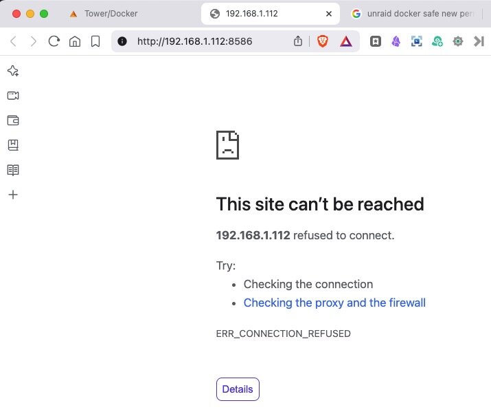

  10. Will certainly do! In the mean time: navigating to http://192.168.1.112:8080/ also gives me the refused to connect another question running in my head: when I try to do something with unraid, I mostly follow tutorials, be it youtube or on the forum. That brings me to the fact that I remember that I created two docker custom networks (without really knowing properly what they do). So my question: can they be removed? If yes, how? Otherwise, can they cause havoc / problems? is it logic that PGAdmin does not work anymore?

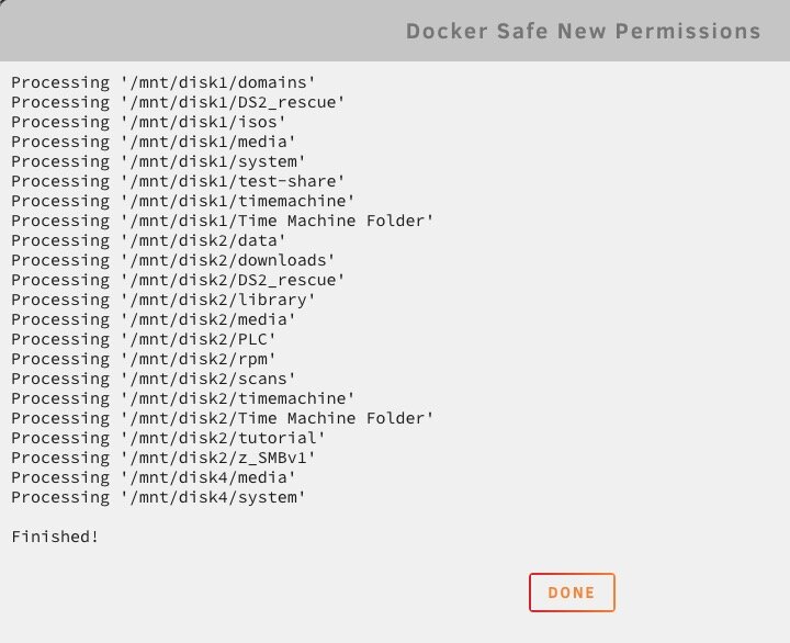

  11. Ok, here we are again ;-) First of all, thanks a ton for helping out! Second, question, remark: I'm trying to take this whole process as a (big) learning curve towards learning unraid, understanding docker containers and networking in unraid context. To illustrate, I had to research what CA is to find out it's of course the abbreviation of Community Applications. Just to illustrate my level of understanding.. So what I did next: install Immich_PostgreSQL from ghcr repo. And configured that with the identical (as far as I can tell) settings and (default) passwords. I then went to search for the tool > docker safe permission only not to find it. After doing again searching, I installed the Fix Common Problems plugin, ran the tests as good as possible (no big things revealed though). In the mean time I went into the terminal and ran chmod & chown manually. cd /mnt/users/appdata chmod 777 -R * chown nobody:users -R *Afterwards, I found the Docker Safe new Permissions in Tools, then ran that too, which is processing a lot more than what I did with the chmod & chown command. But then, after all this, I still get the imminent Here's a copy of the immich.log: text error warn system array login.txt Too me it seems that Immich is correctly running? Looking forward what you suggest to get connected to Immich? Also: Yesterday I could connect to PGAdmin and now this does not work anymore either..

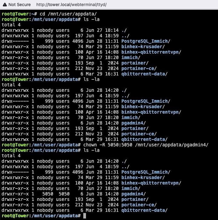

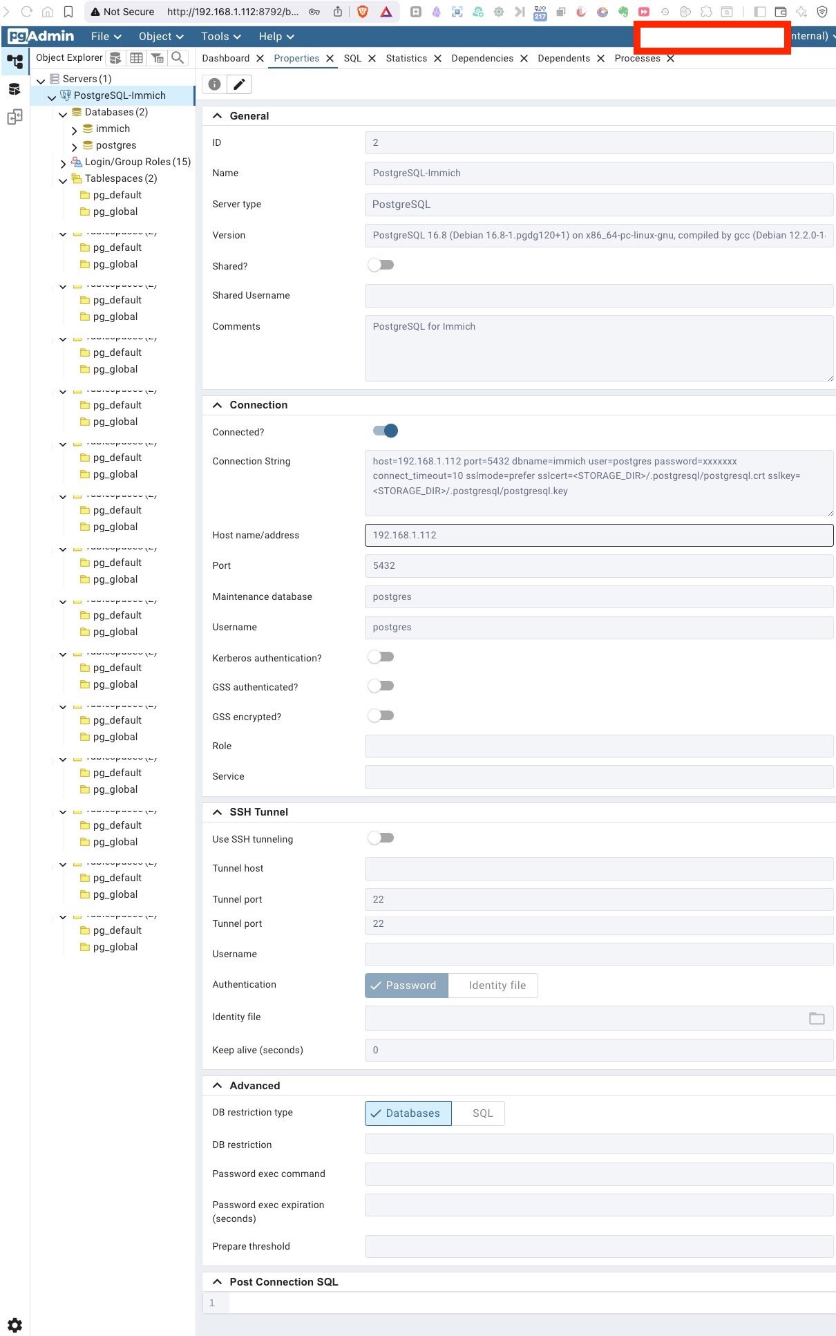

  12. Can it have something to do with the user permissions in hte appdata folder? I'm wondering because the PGAdmin4 docker specifically requested to change the user permissions.. These three ls -la commands were issued before and after the change to the pgadmin4 docker appdata folder

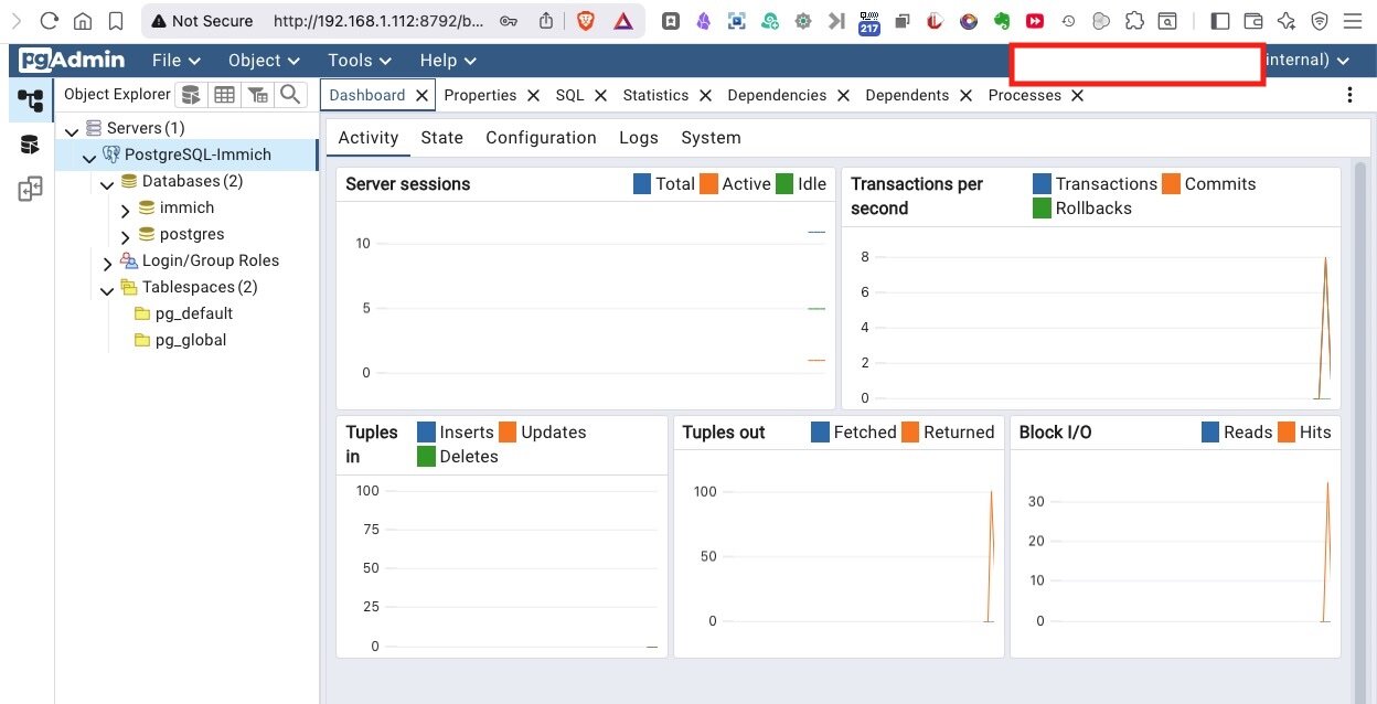

  13. Ok, I think this might help: I'm not familiar at all with PGAdmin, but I have used it yeaaaaaaaaaars ago when I set up several MAMP servers. So, I took a shot at it and tried to enter the user information to add a server in PGAdmin. And apparently that worked.
