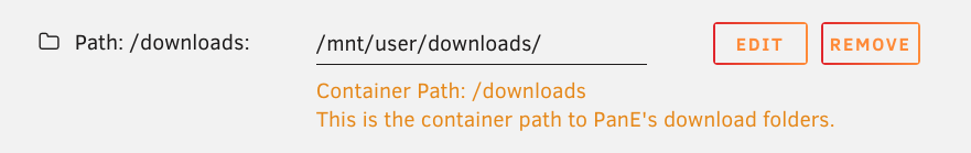

  1. Ok, so indeed it appears this misspelled Media share has been created. I ssh'ed into my unraid server and searched for this share / folder, went in and noticed it indeed contains the two dirs completed and incomplete, and a whole bunch of downloaded files. So I guess at some point 'after' committing the error, qbittorrent has been working to re-download these files. My first reflex was to see if I could try and move these files back to where they belong. But then I noticed that this Media share is not public, so I can not set the "Public" property. I would prefer to use smb to move these files but I cannot approach them. Is there maybe a way to fix this by manually editing some config file? What would be the recommended way to proceed here? Would it be an option to disable / stop the binhex-qbittorrent docker, then recreate a blank new binhex-qbittorrent instance (I've read that two of the same docker instances should be possible). Then first test this new docker instance and only after that gradually bring over each of the downloads? Although that will be a cumbersome job... Thanks for any further advice or help!
  2. Thanks for spotting that! How did you manage to spot that so quickly / easily? What tool did you use, if any? Will check tomorrow, but that probably happened when I tried to redirect qbittorrent downloads! Will post back the results! Thanks for helping out!

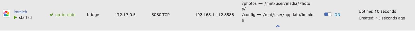

  8. I'll check these posts and read. For what it's worth: I did run through the settings once more noticed the server was at this weird not 8080 port => changed it to 8080, saved immich restarted, and yes!! now I can connect 😃😅 Thank you! Thank you! Thank you!Please do keep an eye on this thread, or my postings. I will first try to continue Immich setup. I'd then like to get things set up so that I can access the server from the outside network. We do have a slow upload speed, so I know it's not going to be fast. I have also been thinking of another scenario, but I do not know if that is possible: I have an external virtual linux machine hosted, it might be a possibility to set up Immich on that one (not unraid, but linux) and maybe there's ways to sync two Immich instances? (b.t.w. what timezone are you in? (I'm from Belgium))

  17. That would be, for Immich: docker run -d --name='immich' --net='bridge' --pids-limit 2048 -e TZ="Europe/Paris" -e HOST_OS="Unraid" -e HOST_HOSTNAME="Tower" -e HOST_CONTAINERNAME="immich" -e 'DB_HOSTNAME'='192.168.1.112' -e 'DB_USERNAME'='postgres' -e 'DB_PASSWORD'='postgres' -e 'DB_DATABASE_NAME'='immich' -e 'REDIS_HOSTNAME'='localhost' -e 'DB_PORT'='5432' -e 'REDIS_PORT'='6379' -e 'REDIS_PASSWORD'='' -e 'SERVER_HOST'='0.0.0.0' -e 'SERVER_PORT'='8586' -e 'MACHINE_LEARNING_HOST'='0.0.0.0' -e 'MACHINE_LEARNING_PORT'='3003' -e 'MACHINE_LEARNING_WORKERS'='1' -e 'MACHINE_LEARNING_WORKER_TIMEOUT'='120' -e 'DOCKER_MODS'='imagegenius/mods:universal-redis' -e 'PUID'='99' -e 'PGID'='100' -e 'UMASK'='022' -l net.unraid.docker.managed=dockerman -l net.unraid.docker.webui='http://[IP]:[PORT:8586]' -l net.unraid.docker.icon='https://raw.githubusercontent.com/imagegenius/templates/main/unraid/img/immich.png' -p '8586:8080/tcp' -v '/mnt/user/media/Photos/':'/photos':'rw' -v '/mnt/user/appdata/immich':'/config':'rw' 'ghcr.io/imagegenius/immich' 3c76c5aed8f85e6f3d4a0f11cc0c800f67e09bdf411fac7a8808819289980d5c The command finished successfully! and for PostgreSQL:docker run -d --name='PostgreSQL_Immich' --net='bridge' --pids-limit 2048 -e TZ="Europe/Paris" -e HOST_OS="Unraid" -e HOST_HOSTNAME="Tower" -e HOST_CONTAINERNAME="PostgreSQL_Immich" -e 'POSTGRES_PASSWORD'='postgres' -e 'POSTGRES_USER'='postgres' -e 'POSTGRES_DB'='immich' -l net.unraid.docker.managed=dockerman -l net.unraid.docker.icon='' -p '5432:5432/tcp' -v '/mnt/user/appdata/PostgreSQL_Immich':'/var/lib/postgresql/data':'rw' 'tensorchord/pgvecto-rs:pg16-v0.3.0' 976f4e2969068dd9eb2daf9b8e52ca2667914e8d5d8b416c30b7b6d2114e9985 The command finished successfully! I will also try to install PGAdmin
  18. Thanks for replying. I'm not sufficiently knowledgeable but: during install / setup Immich docker tests the connection => no issues were revealed I've had this issue with ALL Docker containers For what it's worth: I did setup a custom network for Docker. Don't remember, Binhex or who has a Youtube tutorial about this.
  19. Hi everyone, I'm in the process of setting up Immich self hosting service for photos. Following to the T AlienTech 24 youtube tutorial. All seems to be working ( green running arrow) When I click on the Immich icon, then click WebUI, a window / tab opens and reports: This site can't be reached. IP OFF UNRAID refused to connect. I'm a fairly new noob to Unraid and Docker. I do know that I have (tried) to install a couple of Docker instances and that quasi all times I had the same problem. E.g. with qBittorrentvpn I had the same trouble. From reading and searching I guess this must be a basic config error on my behalf. How can I start to debug this? What does work? I can connect to the console Here is a snippet from the log running by And also please find the diagnostics attached. For what it's worth I was thinking the ports are not properly aligned, but I'm not sure about that, and I could not change the Docker 8080 port? If you need more information to help me get this working, please let me know! Thanks for helping out! (P.S. I tried to start this topic in the Docker sub-forum, but apparently something went wrong. If you feel like moving it to the Docker sub-forum please do) Node.js v22.16.0 api worker exited with code 1 libatomic1 libjemalloc2 liblzf1 redis-tools Suggested packages: ruby-redis The following NEW packages will be installed: libatomic1 libjemalloc2 liblzf1 redis-server redis-tools 0 upgraded, 5 newly installed, 0 to remove and 21 not upgraded. Need to get 1,492 kB of archives. After this operation, 7,608 kB of additional disk space will be used. Get:1 http://archive.ubuntu.com/ubuntu noble-updates/main amd64 libatomic1 amd64 14.2.0-4ubuntu2~24.04 [10.5 kB] Get:2 http://archive.ubuntu.com/ubuntu noble/universe amd64 libjemalloc2 amd64 5.3.0-2build1 [256 kB] Get:3 http://archive.ubuntu.com/ubuntu noble/universe amd64 liblzf1 amd64 3.6-4 [7,624 B] Get:4 http://archive.ubuntu.com/ubuntu noble-updates/universe amd64 redis-tools amd64 5:7.0.15-1ubuntu0.24.04.1 [1,166 kB] Get:5 http://archive.ubuntu.com/ubuntu noble-updates/universe amd64 redis-server amd64 5:7.0.15-1ubuntu0.24.04.1 [51.7 kB] Fetched 1,492 kB in 0s (4,344 kB/s) Selecting previously unselected package libatomic1:amd64. (Reading database ... 19371 files and directories currently installed.) Preparing to unpack .../libatomic1_14.2.0-4ubuntu2~24.04_amd64.deb ... Unpacking libatomic1:amd64 (14.2.0-4ubuntu2~24.04) ... Selecting previously unselected package libjemalloc2:amd64. Preparing to unpack .../libjemalloc2_5.3.0-2build1_amd64.deb ... Unpacking libjemalloc2:amd64 (5.3.0-2build1) ... Selecting previously unselected package liblzf1:amd64. Preparing to unpack .../liblzf1_3.6-4_amd64.deb ... Unpacking liblzf1:amd64 (3.6-4) ... Selecting previously unselected package redis-tools. Preparing to unpack .../redis-tools_5%3a7.0.15-1ubuntu0.24.04.1_amd64.deb ... Unpacking redis-tools (5:7.0.15-1ubuntu0.24.04.1) ... Selecting previously unselected package redis-server. Preparing to unpack .../redis-server_5%3a7.0.15-1ubuntu0.24.04.1_amd64.deb ... Unpacking redis-server (5:7.0.15-1ubuntu0.24.04.1) ... Setting up libjemalloc2:amd64 (5.3.0-2build1) ... Setting up liblzf1:amd64 (3.6-4) ... Setting up libatomic1:amd64 (14.2.0-4ubuntu2~24.04) ... Setting up redis-tools (5:7.0.15-1ubuntu0.24.04.1) ... Setting up redis-server (5:7.0.15-1ubuntu0.24.04.1) ... invoke-rc.d: could not determine current runlevel invoke-rc.d: policy-rc.d denied execution of start. Processing triggers for libc-bin (2.39-0ubuntu8.4) ... [custom-init] No custom files found, skipping... Starting api worker [Nest] 685 - 06/27/2025, 6:56:48 PM LOG [Api:EventRepository] Initialized websocket server Starting api worker [Nest] 715 - 06/27/2025, 6:56:54 PM LOG [Api:EventRepository] Initialized websocket server Starting api worker [Nest] 744 - 06/27/2025, 6:56:59 PM LOG [Api:EventRepository] Initialized websocket server Starting api worker [Nest] 773 - 06/27/2025, 6:57:05 PM LOG [Api:EventRepository] Initialized websocket server /app/immich/server/node_modules/postgres/cjs/src/connection.js:388 if (!query || typeof query !== 'object' || !query.reject) throw err ^ Error: connect ECONNREFUSED 192.168.1.112:5432 at TCPConnectWrap.afterConnect [as oncomplete] (node:net:1636:16) { errno: -111, code: 'ECONNREFUSED', syscall: 'connect', address: '192.168.1.112', port: 5432 } Node.js v22.16.0 api worker exited with code 1 Starting api worker [Nest] 802 - 06/27/2025, 6:57:10 PM LOG [Api:EventRepository] Initialized websocket server /app/immich/server/node_modules/postgres/cjs/src/connection.js:388 if (!query || typeof query !== 'object' || !query.reject) throw err ^ Error: connect ECONNREFUSED 192.168.1.112:5432 at TCPConnectWrap.afterConnect [as oncomplete] (node:net:1636:16) { errno: -111, code: 'ECONNREFUSED', syscall: 'connect', address: '192.168.1.112', port: 5432 } Node.js v22.16.0 api worker exited with code 1 Starting api worker [Nest] 831 - 06/27/2025, 6:57:15 PM LOG [Api:EventRepository] Initialized websocket server /app/immich/server/node_modules/postgres/cjs/src/connection.js:388 if (!query || typeof query !== 'object' || !query.reject) throw err ^ Error: connect ECONNREFUSED 192.168.1.112:5432 at TCPConnectWrap.afterConnect [as oncomplete] (node:net:1636:16) { errno: -111, code: 'ECONNREFUSED', syscall: 'connect', address: '192.168.1.112', port: 5432 } tower-diagnostics-20250627-1832.zip
