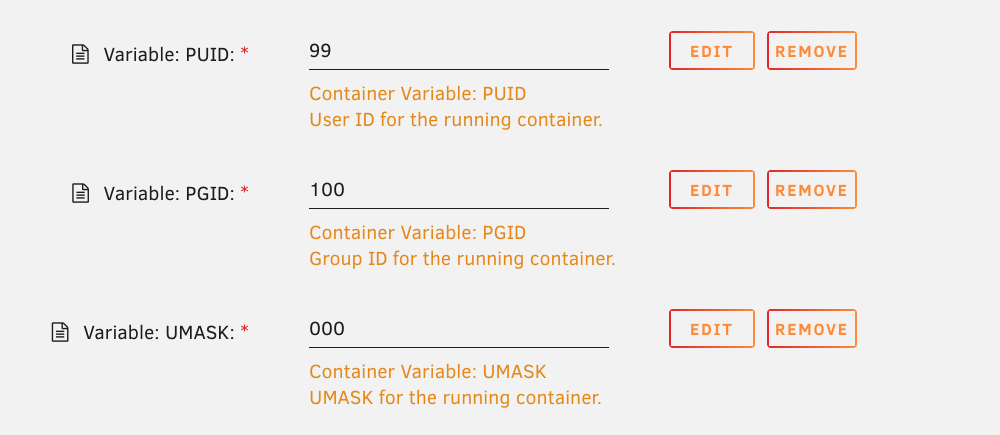

  4. H20King, Thanks for replying. That's what the values are in qBittorrentvpn config. Should the Variable: UMASK be set differently to allow for the Docker container to write to the share location?

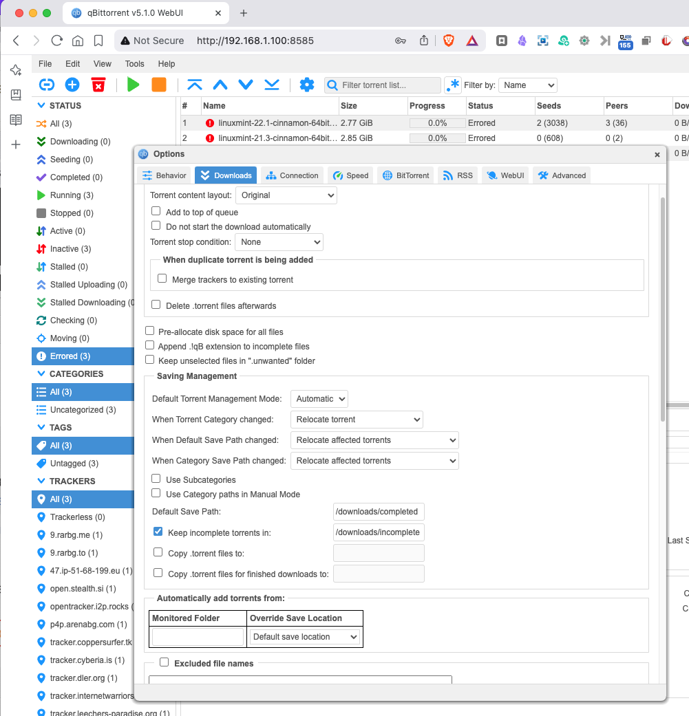

  5. Ok, now that I have access, let's try to solve the next issue: Following AlienTech42's example I've looked up a couple of torrents and added them to qBittorrent. It seems as if they start downloading, but after a couple of seconds, half a minute, they error out? Looking at the detail: error: Permission denied => so that applies to my downloads folder Question: How to set a Docker instances read /write acces to a shared folder? As what user does the qBittorrentvpn docker instance operate? (viewed from the shared folders of unraid)

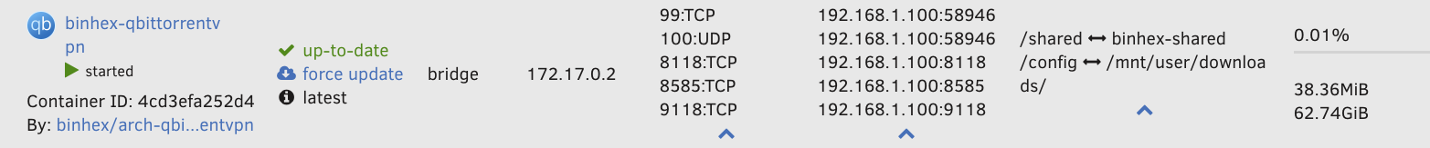

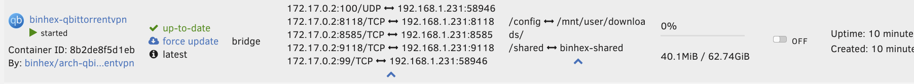

  6. Ok, thanks. I was / am totally unsure about all the various port addresses available. Also, I had no need to change any default port, so I just tried to follow instructions. What I find odd: (or do I misunderstand?) In general UI you have default settings and then you have the "set" value. This would then lead to e.g. a default value of 8080 and a set value of 8585, but it would not allow you to "change" the default value (since then it would not be a default anymore) Anyway, I've set both the ones that Kilrah highlighted to the same (8585) and now at least I can remotely log on using the webinterface!! Thanks a ton!

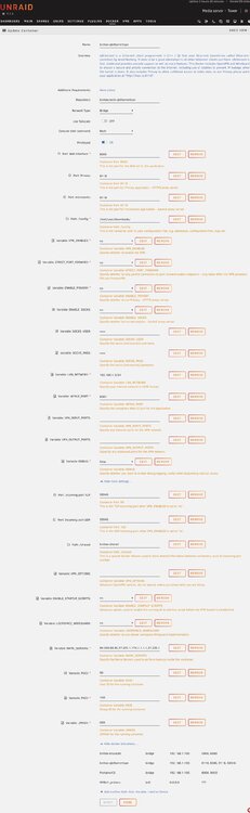

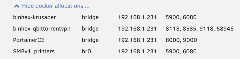

  7. Thanks for answering! Well, I agree with what you point out. But I have / and am really trying out all ports, but apparently I can not remotely connect. Just to clarify a bit: first did an install months ago, but could not connect. Due to time constraints abandoned. Then, yesterday, tried to get it working, to no avail. Then, today, removed the docker container and started out afresh. Can't reach the unraid server on any of these ports 58946 / 8118 / 8585 / 9118 To be 100% complete, here's a full screenshot of the current settings: =========================================================================== This was the previous install & test (can be discarded)

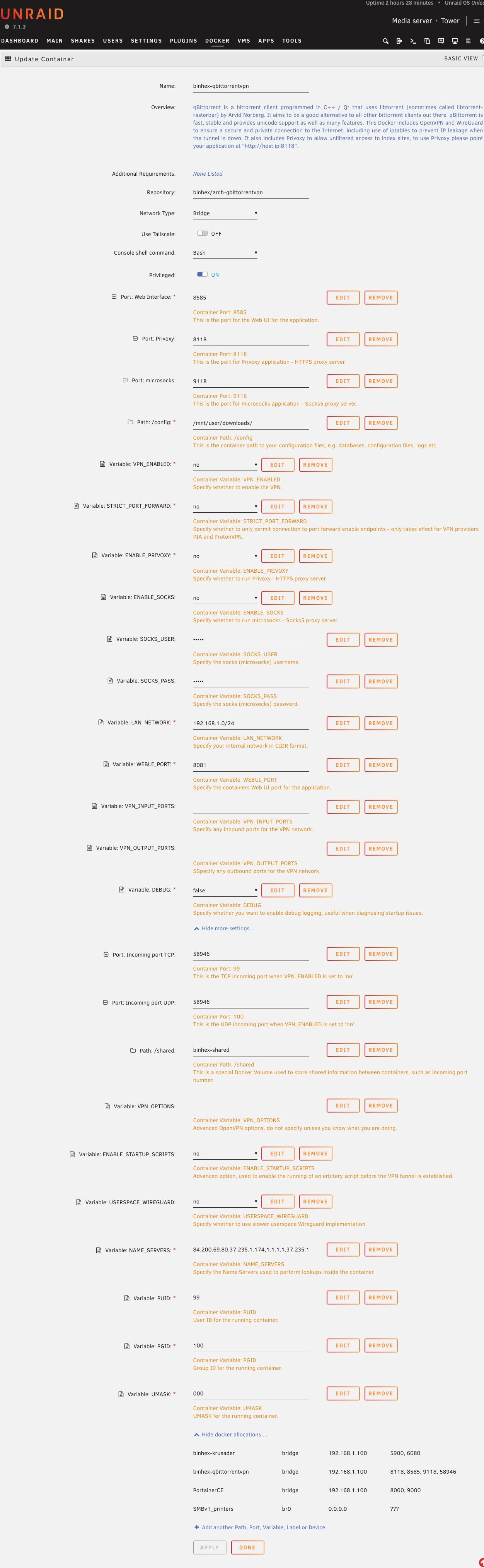

  8. Hi, I'm looking for some help to solve my binhex-qbittorrentvpn setup. I've been trying around for hours now but I'm totally unable to connect to the webinterface. To be clear: To start with, I have no VPN enabled (yet). (I want to see it fully operational before spending money). Privoxy is not enabled either. What I've tried so far: go into the docker console tested pinging one docker container to another (works) uninstall the binhex-qbittorrentvpn and reinstall using Finder (macos) went into the //unraid/appdata/binhex-qbittorrentvpn/qBittorrent/config/ folder and edited the qBittorrent.conf file to add the famous WebUI\Password_PBKDF2="@ByteArray(ARQ77eY1NUZaQsuDHbIMCA==:0WMRkYTUWVT9wVvdDtHAjU9b3b7uB8NR1Gur2hmQCvCDpm39Q+PsJRJPaCU51dEiz+dTzh8qbPsL8WkFljQYFQ==)" line There is no way I can connect to the webinterface of qBittorrent. I'm under the impression that the container is running but that the error is somewhere in the port configuration, however I followed AlienTech42's excellent youtube instructions to check my setup. Whatever I do, I keep getting "The 192.168.231 site refused to connect" Here are some screenshots of my system: From the log: 2025-06-05 10:58:08,904 DEBG 'watchdog-script' stdout output: [info] Attempting to start qBittorrent... 2025-06-05 10:58:08,912 DEBG 'watchdog-script' stdout output: [info] qBittorrent process started [info] Waiting for qBittorrent process to start listening on port 8080... 2025-06-05 10:58:09,153 DEBG 'watchdog-script' stdout output: [info] qBittorrent process listening on port 8080 What I noticed is that changing the 8080 port seems not to be taken into account when doing a right-click > WebUI. So e.g. when I set the UI port to 9090, the right-click > WebUI keeps going to IP:8080. That's also why I have not changed that port setting, just to avoid any problem there. I've tried using several browsers: Safari, Brave but nothing helps. I keep getting the refused to connect error. If you need any more information, please let me know. Thanks for helping out! P.S. I also have binhex-krusader running and that docker container runs fine.

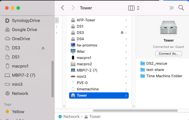

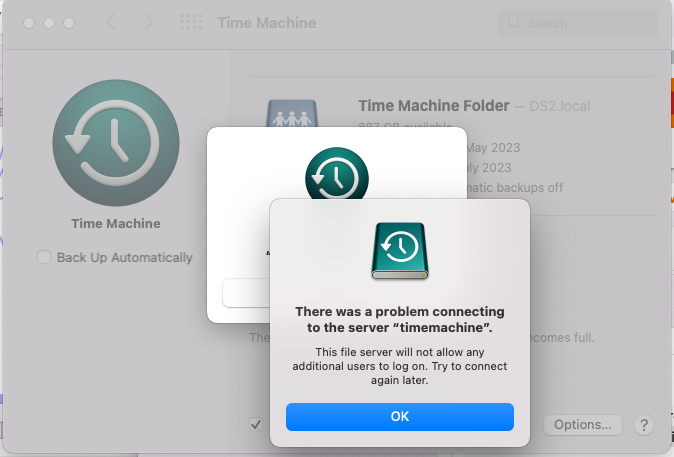

  13. I think / hope I solved my own issue: While I was examining Docker related settings (I know little or nothing about them..) I noticed that > Settings > Docker showed the Docker data-root as btrfs vDisk. Since all my drives are xfs, I changed the setting of data-root accordingly from btrfs to xfs and Tada!! Docker started to work!
