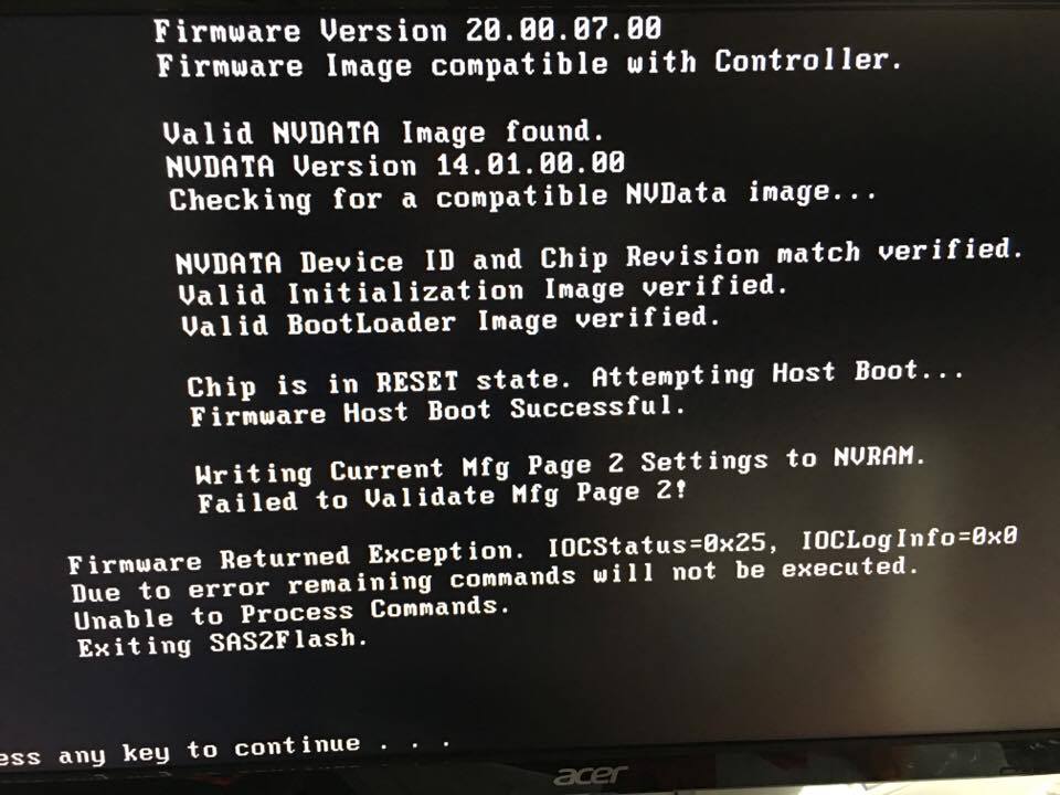

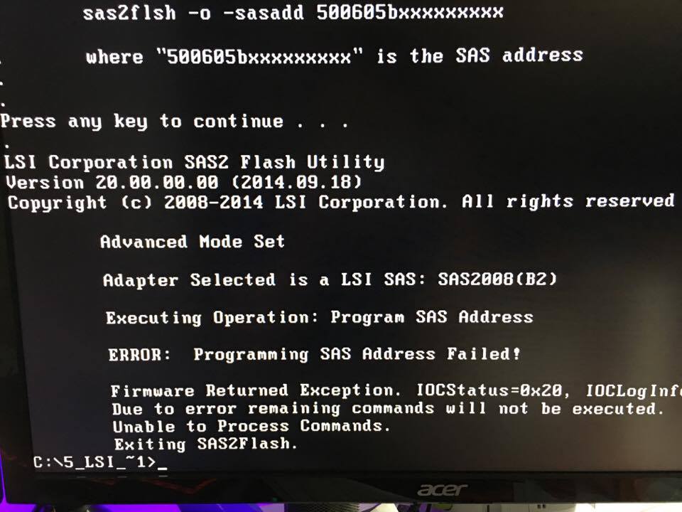

  1. It was just me not following instructions correctly. I didn't realize that you need to flash the Dell firmware first before going to the next step. I thought that step was only for people that wanted the Dell firmware so I jumped right to flashing the P20 firmware. Maybe adding a note that flashing the Dell firmware is required before proceeding to next step for people like myself Thank you very much for the instructions though. I got the card up and running great so far.
  2. Never mind. I didn't realized I had to flash the Dell firmware first then P7 and P20 in order like the instructions provided by Fireball3. Thank you all. I appreciate all your instructions.

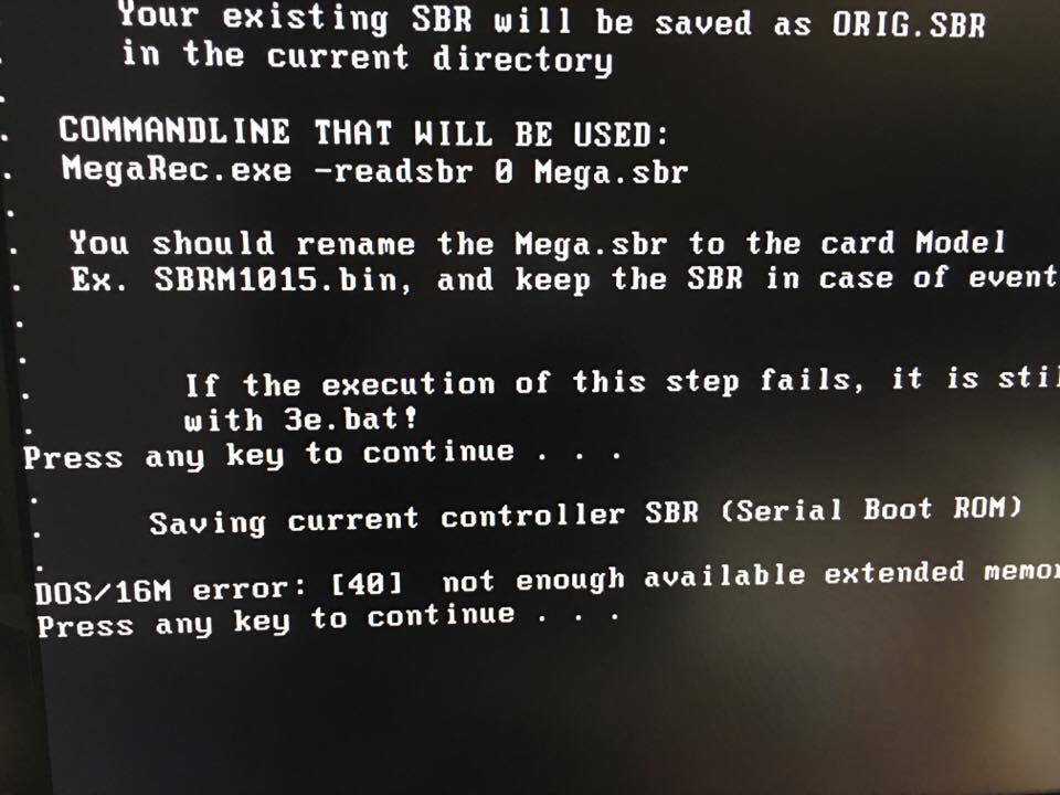

  3. I followed Bungy's suggestion to remove memory stick leaving just 1 and that seems to fix the "not enough available extended error" message. However I'm still running into other error when flashing and writing the SAS address.
  4. Hi guys. I followed Fireball3's guide to and flash my H310 but so far couldn't pass step 2 and 3. I keep getting not enough available extended memory error when I try to save existing SBR. I proceeded to step 3 to clear controller ROM and get the same error. Any help would be appreciated.
